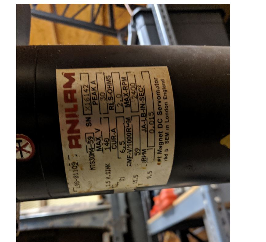

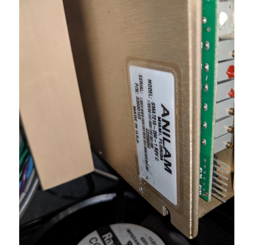

Hi.
New guy here...
Hope this doesn't look like im hijacking this thread but I am working on the same conversion as Austin136. Its a Chevalier CNC mill with a Anilam 3300MK control. This mill is equipped with the same servos and drivers as Austin's mill.
Im starting with the 5i25/7i77 combo and was wondering if anyone could share or point me in the right direction of where I could find the basic config files for this combination?
For some reason im struggling with the pcnconfig to generate usable setup files.
Thanks for the help
New guy here...
Thanks for the help
01 Nov 2019 13:22 #149353
Replied by andypugh on topic Retrofitting knee mill
What problems are you having?
