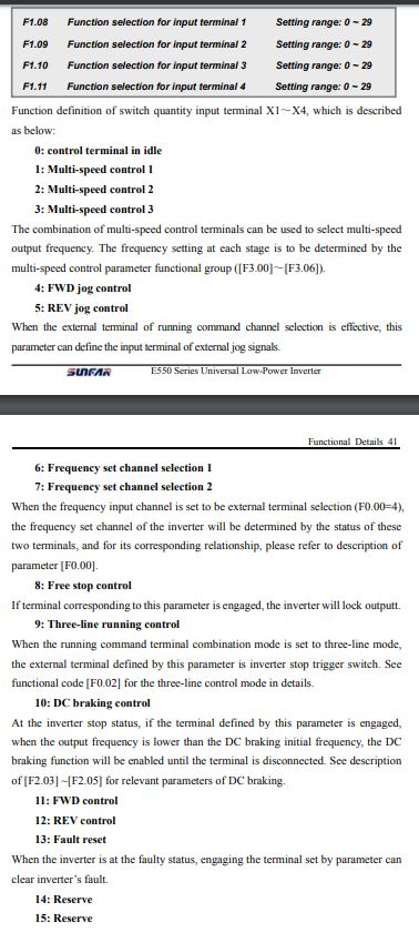

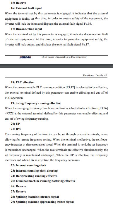

Hey everyone,
I am relatively new to Linux CNC and this is my first post here.
Unfortunately I am stuck with setting up the spindle control. I read all the other forum posts which deal with this topic but I could not find a solution yet.
I have a Mesa 7i76e and Sunfar E550 VFD which drives 2.2 KW Chinese spindle. The analog speed control over 0-10V works fine but I can´t get the spindle enable / forward to work.

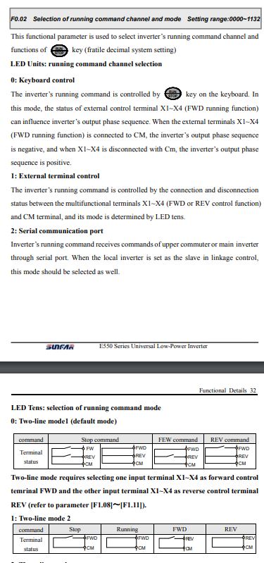

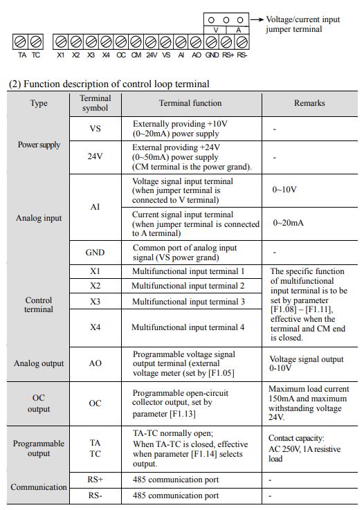

In order to turn on the spindle I have to connect X1 (which I programmed with spindle forward in the VFD settings) to CM. In case I do this manually, this works fine, but I don´t know how I have to wire it to the Mesa TB4. I tried wiring 24V to to Pin 8 and X1 to Pin 7, but when I turn on the spindle in Linux CNC nothing happens and I also can´t measure any voltage between pin 7 and 8. I also tried wiring CM to pin 8 and X1 to pin 7, but this turns on the spindle immediately and I can not control it over Linux CNC. I am also not sure if and how to connect ena + and ena - because I don´t know how to assign this function to X1 - X4 (it´s not listed in the manual I think). Maybe it´s a problem in the HAL file? I attached the INI and HAL file and some screenshots of the manual. Please let me kow if any information is missing. It would be really great if anyone could help me out, since I really don´t know how to solve this.
VFD Programming:
F0.02 = 1111
F1.08 = 11
Wiring:
Pin 1 => GND
Pin 2 => AI
Pin 3 => VS
Pin 4 => NC
Pin 5 => ?
Pin 6 => 24 V ?
Pin 7 => X1 ?
Pin 8 => 24 V ?
Thanks a lot in advance!
Best regards,
Jonas

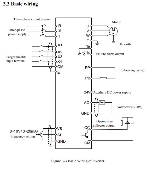

I would verify that you can control the VFD enable and direction with
mechanical switches before wiring to the 7I76E. The 7I76E enable and direction
outputs are basically just switches so once you figure out the VFD control with
switches you can just transfer the connections
(paying attention to the enable and direction polarity)
Doing it this way makes it much less likely to miswire the
7I76E outputs and cause possible damage

This is basicly what I did. Connecting X1 to CM turnes on the spindle. But my question is how to wire and programm it?
- Posts: 18080
- Thank you received: 5316
10 Sep 2019 20:53 #144742
Replied by PCW on topic Mesa 7i76 E + Sunfar E550 VFD Connection
If X1 measures positive relative to CM then:
X1 --> TB4 pin 6
CM --> TB4 pin 5
X1 --> TB4 pin 6
CM --> TB4 pin 5
The following user(s) said Thank You: jonasdarley
- jonasdarley
- Posts: 3
14 Sep 2019 08:28 #145115
by jonasdarley
Replied by jonasdarley on topic Mesa 7i76 E + Sunfar E550 VFD Connection
IT´S WORKING! Thank you so much! You really made my day
