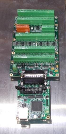

If your servos have +10,-10 volt control input then one solution is the 7I92M together with the (very popular) 7i77
store.mesanet.com/index.php?route=produc...oduct&product_id=302
store.mesanet.com/index.php?route=produc...oduct&product_id=120
