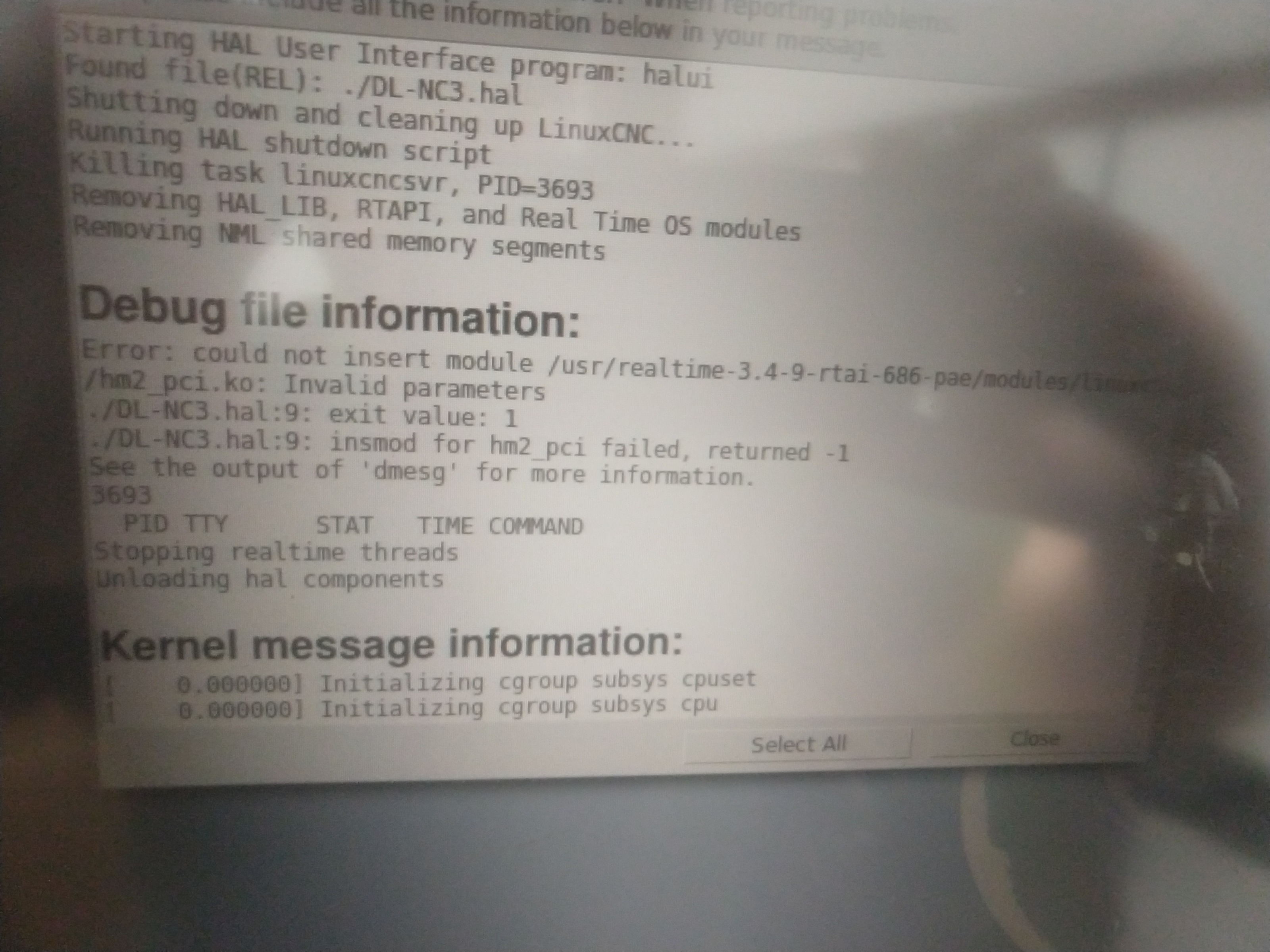

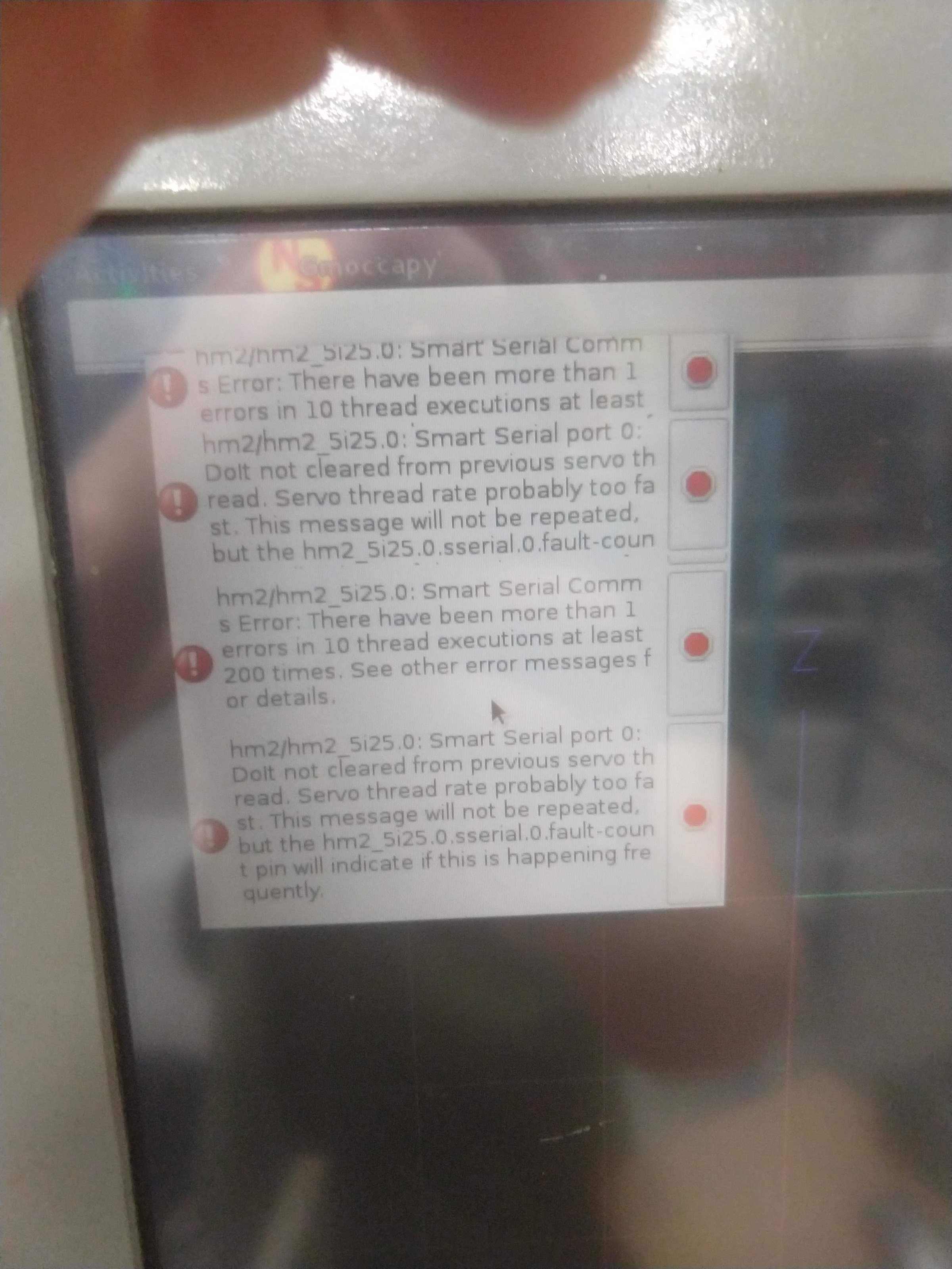

I've got two recurring errors now. If I restart the cpu enough times, I somehow avoid the errors when starting up, but sometimes they will popup later. From researching the one error it looks like I'm having an issue with latency? I apologize that I'm blundering my way through this...
Any help with these? Thanks!

23 Mar 2020 20:34 #161277
Replied by andypugh on topic Advice on new to me retrofit
Try cleaning the PCI port, and / or reseating the PCI card.
- Posts: 22002
- Thank you received: 7488
23 Mar 2020 21:19 #161281
Replied by tommylight on topic Advice on new to me retrofit
Also try another PCI slot, if available.
Or change the PC.

- Posts: 18111
- Thank you received: 5330
23 Mar 2020 22:11 #161287
Replied by PCW on topic Advice on new to me retrofit
The first error looks hardware related, posting the kernel log (with dmesg) would help determine the actual issue
The second (sserial) error is often latency related, did you run a latency test on your PC?
Can you post you hal and ini files?

01 Apr 2020 18:07 - 01 Apr 2020 18:10 #162363
by Dah-Lih Llama
Replied by Dah-Lih Llama on topic Advice on new to me retrofit
Ok, switched to a new PC and found a wire had pulled out of the mesa board. When I get this thing up and running I really need to tear everything out and clean up the wiring. Not knocking the previous person that wired it, but it's not the best job. I need to make a wiring diagram for it too.
