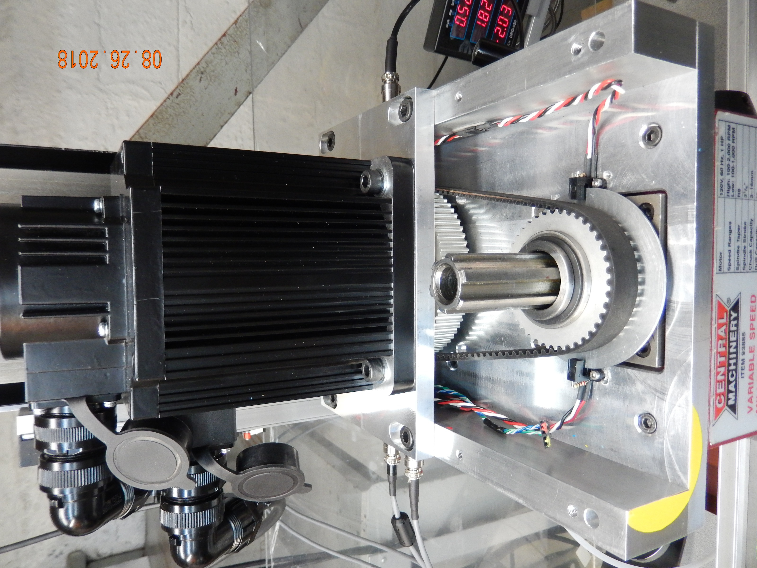

I used this one on a Sieg X3 which is very similar to a G0704. It drives the spindle via a toothed belt geared 1:1.8 so I get 5400 rpm at the spindle. My goal was higher spindle speed and being able to do rigid tapping. Both were achieved.
DMM-DYN4 1.8kw
DMM-DYN4 1.8kw

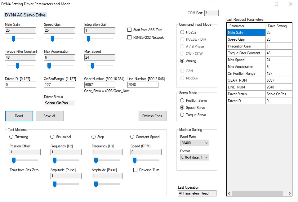

I'm using a 6l25+7i76 and I did add a 7i83 for the 0-10v interface. I used the AB encoder signals sent out by the DMM drive and I added a slot type optical sensor on the spindle for the Z signal. I had to do that because of the 1:1.8 toothed belt gearing. You can probably use 1:1 gearing since the max speed on the 750 watt is 5000 rpm. On the 1.8kw it is only 3000 rpm and I could afford to trade some torque for speed.
The other thing that the docs or the tech warned about (can't remember which) was not to do quick power cycles like off then right back on again. I think I put something in the HAL to prevent that from happening but I would have to look.
This was some advice I got from DMM Tech support:
For use as spindle motor, set Integration Gain to "1" and keep it at "1". Then increase Main Gain and Speed Gain until the motion is rigid and suitable. Keep Main Gain and Speed Gain at the same value.
Make sure to install a regenerative resistor on the drive to help absorb deceleration energy from the motor. Also install a transformer or AC line reactor on the AC power input to smooth and filter the power coming into the drive.
We have a large regenerative resistor for $62 with attached specifications. The line reactor you can use something like this unit: www.automationdirect.com/adc/Shopping/Ca...ine_Reactors/LR-23P0
These are the settings I ended up with:

[SPINDLE_0]
P = 2.0
I = 4.0
D = 0.0
FF0 = 1.08
FF1 = 0.0
FF2 = 0.0
BIAS = 0.0
DEADBAND = 0.0
OUTPUT_MIN_LIMIT = -5400.0
OUTPUT_MAX_LIMIT = 5400.0
OUTPUT_SCALE = -10800
ENCODER_SCALE = 4551.111111
#((2048 * 4) / 1.8) = 4551.111111
Warning: Spoiler!
#DYN4 1.8K Servo Spindle with encoder.
# Generated by PNCconf at Sun Jan 12 16:23:57 2020

net spindle-ccw <= spindle.0.reverse
net spindle-brake <= spindle.0.brake
net spindle-revs => hm2_5i25.0.encoder.00.position spindle.0.revs
net spindle-at-speed => spindle.0.at-speed
net spindle-vel-fb-rps => spindle.0.speed-in
net spindle-index-enable <=> spindle.0.index-enable
net spindle-lockout-db estop-latch.1.ok-out => and2.ena.in1
net spindle-OK and2.ena.out => timedelay.0.in
net DYN-enable timedelay.0.out => hm2_5i25.0.7i76.0.0.output-03 hm2_5i25.0.7i83.0.1.analogena5
net spindle-Lockout hm2_5i25.0.7i76.0.0.input-07-not => estop-latch.1.fault-in
net spindle-vel-cmd-rpm-abs => near.0.in1
net spindle-fb-rpm-abs => near.0.in2
net spindle-at-speed spindle.0.at-speed <= near.0.out
setp near.0.scale 1.04
# Use ACTUAL spindle velocity from spindle encoder
# spindle-velocity bounces around so we filter it with lowpass
# spindle-velocity is signed so we use absolute component to remove sign
# ACTUAL velocity is in RPS not RPM so we scale it.
setp scale.0.gain 60
setp lowpass.0.gain .007
setp lowpass.0.load false
net spindle-vel-fb-rps hm2_5i25.0.encoder.00.velocity => scale.0.in
net spindle-fb-rpm scale.0.out => abs.0.in
net spindle-fb-rpm-abs abs.0.out => lowpass.0.in
net spindle-fb-rpm-abs-filtered lowpass.0.out
# connect miscellaneous signals
# ---HALUI signals---
net joint-select-a halui.joint.0.select
net x-is-homed halui.joint.0.is-homed
#net jog-x-pos halui.jog.0.plus
#net jog-x-neg halui.jog.0.minus
net jog-x-analog halui.axis.x.analog
net joint-select-b halui.joint.1.select
net y-is-homed halui.joint.1.is-homed
#net jog-y-pos halui.jog.1.plus
#net jog-y-neg halui.jog.1.minus
net jog-y-analog halui.axis.y.analog
net joint-select-c halui.joint.2.select
net z-is-homed halui.joint.2.is-homed
#net jog-z-pos halui.jog.2.plus
#net jog-z-neg halui.jog.2.minus
net jog-z-analog halui.axis.z.analog
net jog-selected-pos halui.axis.selected.plus
net jog-selected-neg halui.axis.selected.minus
net spindle-manual-cw halui.spindle.0.forward
net spindle-manual-ccw halui.spindle.0.reverse
#net spindle-manual-stop halui.spindle.stop
#net machine-is-on halui.machine.is-on
net jog-speed halui.axis.jog-speed
net MDI-mode halui.mode.is-mdi
net extermal-spindle-Start hm2_5i25.0.7i76.0.0.input-08 or2.spindleStart.in1
net startSpindle or2.spindleStart.out halui.spindle.0.start
net extermal-spindle-Stop hm2_5i25.0.7i76.0.0.input-09 or2.spindleStop.in1
net stopSpindle or2.spindleStop.out halui.spindle.0.stop
# ---coolant signals---
net coolant-mist <= iocontrol.0.coolant-mist
net coolant-flood <= iocontrol.0.coolant-flood
# ---probe signal---
net probe-in => motion.probe-input
# ---motion control signals---
net machine-is-enabled <= motion.motion-enabled
# ---estop signals---
net estop-loopout iocontrol.0.emc-enable-in <= estop-latch.0.ok-out
net estop-loopin iocontrol.0.user-enable-out => estop-latch.0.ok-in
net estop-reset iocontrol.0.user-request-enable => estop-latch.0.reset
net remote-estop estop-latch.0.fault-in <= hm2_5i25.0.7i76.0.0.input-04-not
#net estop-is-activated => hm2_5i25.0.7i76.0.0.output-02
# ---manual tool change signals---
net tool-change-request iocontrol.0.tool-change => hal_manualtoolchange.change
net tool-change-confirmed iocontrol.0.tool-changed <= hal_manualtoolchange.changed
# Using LinuxCNC version: 2.8Pre
# overwritten when you run PNCconf again
loadrt [KINS]KINEMATICS
loadrt [EMCMOT]EMCMOT servo_period_nsec=[EMCMOT]SERVO_PERIOD num_joints=[KINS]JOINTS
loadrt hostmot2
loadrt hm2_pci config=" num_encoders=1 num_pwmgens=0 num_stepgens=4 sserial_port_0=00xxxx"
setp hm2_5i25.0.watchdog.timeout_ns 5000000
loadrt estop_latch count=2
addf estop-latch.0 servo-thread
addf estop-latch.1 servo-thread
loadrt pid names=pid.x,pid.y,pid.z,pid.s
loadrt encoder
#add scale and lowpass, these will be used in custom_postgui.hal
loadrt scale count=1
loadrt lowpass count=1
loadrt abs count=1
loadrt near count=1
#loadrt not names=not.halui.spindle-stop
addf scale.0 servo-thread
addf lowpass.0 servo-thread
addf abs.0 servo-thread
addf near.0 servo-thread
#addf not.halui.spindle-stop servo-thread
#loadrt and2 names=and2.vc,and2.ena,and2.spindle-moving
addf and2.vc servo-thread #Used by pendant
addf and2.ena servo-thread
#addf and2.spindle-moving servo-thread
loadrt or2 names=or2.spindleStart,or2.spindleStop
addf or2.spindleStart servo-thread
addf or2.spindleStop servo-thread
#limits debounce to stop false triggers
loadrt debounce cfg=2,1 #change to the number you want
setp debounce.0.delay 100 #this sets the delay 100 iterations of the servo-thread
addf debounce.0 servo-thread
#48Volt power on.
setp debounce.1.delay 125 #this sets the delay 100 iterations of the servo-thread
addf debounce.1 servo-thread
net deb-probe-in debounce.0.0.in <= hm2_5i25.0.7i76.0.0.input-05-not
net probe-in debounce.0.0.out
net run-touch-btn <= hm2_5i25.0.7i76.0.0.input-06 => halui.mdi-command-04
#Time delay to prevent quick enable/disable of DYN4 drive.
loadrt timedelay count=1
setp timedelay.0.on-delay .5 #float in (default: 0.5) #The time, in seconds, for which in must be true before out becomes true
setp timedelay.0.off-delay .5 #float in (default: 0.5) #The time, in seconds, for which in must be false before out becomes false
addf timedelay.0 servo-thread #Delay between command and DYN4 enable.
#// hm2_5i25.0.encoder.00
#// Parameters
setp hm2_5i25.0.encoder.00.counter-mode false
setp hm2_5i25.0.encoder.00.filter false
setp hm2_5i25.0.encoder.00.index-invert false
setp hm2_5i25.0.encoder.00.index-mask false
setp hm2_5i25.0.encoder.00.index-mask-invert false
setp hm2_5i25.0.encoder.00.scale [SPINDLE_0]ENCODER_SCALE
addf hm2_5i25.0.read servo-thread
addf pid.y.do-pid-calcs servo-thread
addf pid.s.do-pid-calcs servo-thread
addf hm2_5i25.0.write servo-thread
# external output signals
net x-home-sw <= hm2_5i25.0.7i76.0.0.input-23-not
net x-neg-limit <= hm2_5i25.0.7i76.0.0.input-24-not
net x-pos-limit <= hm2_5i25.0.7i76.0.0.input-25-not
net y-home-sw <= hm2_5i25.0.7i76.0.0.input-26-not
net y-pos-limit <= hm2_5i25.0.7i76.0.0.input-27-not
net y-neg-limit <= hm2_5i25.0.7i76.0.0.input-28-not
net z-home-sw <= hm2_5i25.0.7i76.0.0.input-29-not
net z-pos-limit <= hm2_5i25.0.7i76.0.0.input-30-not
net z-neg-limit <= hm2_5i25.0.7i76.0.0.input-31-not
net coolant-mist => hm2_5i25.0.7i76.0.0.output-00
# AXIS X
setp pid.x.Pgain [JOINT_0]P
setp pid.x.Igain [JOINT_0]I
setp pid.x.Dgain [JOINT_0]D
setp pid.x.bias [JOINT_0]BIAS
setp pid.x.FF0 [JOINT_0]FF0
setp pid.x.FF1 [JOINT_0]FF1
setp pid.x.FF2 [JOINT_0]FF2
setp pid.x.deadband [JOINT_0]DEADBAND
setp pid.x.maxoutput [JOINT_0]MAX_OUTPUT
setp pid.x.error-previous-target true
setp pid.x.maxerror .0005
net x-index-enable <=> pid.x.index-enable
net x-enable => pid.x.enable
net x-pos-cmd => pid.x.command
net x-vel-cmd => pid.x.command-deriv
net x-pos-fb => pid.x.feedback
net x-output => pid.x.output
# Step Gen signals/setup
setp hm2_5i25.0.stepgen.00.dirsetup [JOINT_0]DIRSETUP
setp hm2_5i25.0.stepgen.00.dirhold [JOINT_0]DIRHOLD
setp hm2_5i25.0.stepgen.00.steplen [JOINT_0]STEPLEN
setp hm2_5i25.0.stepgen.00.stepspace [JOINT_0]STEPSPACE
setp hm2_5i25.0.stepgen.00.position-scale [JOINT_0]STEP_SCALE
setp hm2_5i25.0.stepgen.00.step_type 0
setp hm2_5i25.0.stepgen.00.control-type 1
setp hm2_5i25.0.stepgen.00.maxaccel [JOINT_0]STEPGEN_MAXACCEL
setp hm2_5i25.0.stepgen.00.maxvel [JOINT_0]STEPGEN_MAXVEL
# ---closedloop stepper signals---
net x-pos-cmd <= joint.0.motor-pos-cmd
net x-vel-cmd <= joint.0.vel-cmd
net x-output <= hm2_5i25.0.stepgen.00.velocity-cmd
net x-pos-fb <= hm2_5i25.0.stepgen.00.position-fb
net x-pos-fb => joint.0.motor-pos-fb
net x-enable <= joint.0.amp-enable-out
net x-enable => hm2_5i25.0.stepgen.00.enable
net x-home-sw => joint.0.home-sw-in
net x-neg-limit => joint.0.neg-lim-sw-in
net x-pos-limit => joint.0.pos-lim-sw-in
# AXIS Y
setp pid.y.Pgain [JOINT_1]P
setp pid.y.Igain [JOINT_1]I
setp pid.y.Dgain [JOINT_1]D
setp pid.y.bias [JOINT_1]BIAS
setp pid.y.FF0 [JOINT_1]FF0
setp pid.y.FF1 [JOINT_1]FF1
setp pid.y.FF2 [JOINT_1]FF2
setp pid.y.deadband [JOINT_1]DEADBAND
setp pid.y.maxoutput [JOINT_1]MAX_OUTPUT
setp pid.y.error-previous-target true
setp pid.y.maxerror .0005
net y-index-enable <=> pid.y.index-enable
net y-enable => pid.y.enable
net y-pos-cmd => pid.y.command
net y-vel-cmd => pid.y.command-deriv
net y-pos-fb => pid.y.feedback
net y-output => pid.y.output
setp hm2_5i25.0.stepgen.01.dirsetup [JOINT_1]DIRSETUP
setp hm2_5i25.0.stepgen.01.dirhold [JOINT_1]DIRHOLD
setp hm2_5i25.0.stepgen.01.steplen [JOINT_1]STEPLEN
setp hm2_5i25.0.stepgen.01.stepspace [JOINT_1]STEPSPACE
setp hm2_5i25.0.stepgen.01.position-scale [JOINT_1]STEP_SCALE
setp hm2_5i25.0.stepgen.01.step_type 0
setp hm2_5i25.0.stepgen.01.control-type 1
setp hm2_5i25.0.stepgen.01.maxaccel [JOINT_1]STEPGEN_MAXACCEL
setp hm2_5i25.0.stepgen.01.maxvel [JOINT_1]STEPGEN_MAXVEL
net y-pos-cmd <= joint.1.motor-pos-cmd
net y-vel-cmd <= joint.1.vel-cmd
net y-output <= hm2_5i25.0.stepgen.01.velocity-cmd
net y-pos-fb <= hm2_5i25.0.stepgen.01.position-fb
net y-pos-fb => joint.1.motor-pos-fb
net y-enable <= joint.1.amp-enable-out
net y-enable => hm2_5i25.0.stepgen.01.enable
net y-home-sw => joint.1.home-sw-in
net y-neg-limit => joint.1.neg-lim-sw-in
net y-pos-limit => joint.1.pos-lim-sw-in
# AXIS Z
setp pid.z.Pgain [JOINT_2]P
setp pid.z.Igain [JOINT_2]I
setp pid.z.Dgain [JOINT_2]D
setp pid.z.bias [JOINT_2]BIAS
setp pid.z.FF0 [JOINT_2]FF0
setp pid.z.FF1 [JOINT_2]FF1
setp pid.z.FF2 [JOINT_2]FF2
setp pid.z.deadband [JOINT_2]DEADBAND
setp pid.z.maxoutput [JOINT_2]MAX_OUTPUT
setp pid.z.error-previous-target true
#setp pid.z.maxerror .0005
net z-index-enable <=> pid.z.index-enable
net z-enable => pid.z.enable
net z-pos-cmd => pid.z.command
net z-vel-cmd => pid.z.command-deriv
net z-pos-fb => pid.z.feedback
net z-output => pid.z.output
setp hm2_5i25.0.stepgen.02.dirsetup [JOINT_2]DIRSETUP
setp hm2_5i25.0.stepgen.02.dirhold [JOINT_2]DIRHOLD
setp hm2_5i25.0.stepgen.02.steplen [JOINT_2]STEPLEN
setp hm2_5i25.0.stepgen.02.stepspace [JOINT_2]STEPSPACE
setp hm2_5i25.0.stepgen.02.position-scale [JOINT_2]STEP_SCALE
setp hm2_5i25.0.stepgen.02.step_type 0
setp hm2_5i25.0.stepgen.02.control-type 1
setp hm2_5i25.0.stepgen.02.maxaccel [JOINT_2]STEPGEN_MAXACCEL
setp hm2_5i25.0.stepgen.02.maxvel [JOINT_2]STEPGEN_MAXVEL
net z-pos-cmd <= joint.2.motor-pos-cmd
net z-vel-cmd <= joint.2.vel-cmd
net z-output <= hm2_5i25.0.stepgen.02.velocity-cmd
net z-pos-fb <= hm2_5i25.0.stepgen.02.position-fb
net z-pos-fb => joint.2.motor-pos-fb
net z-enable <= joint.2.amp-enable-out
net z-enable => hm2_5i25.0.stepgen.02.enable
net z-home-sw => joint.2.home-sw-in
net z-neg-limit => joint.2.neg-lim-sw-in
net z-pos-limit => joint.2.pos-lim-sw-in
# SPINDLE S
setp pid.s.Pgain [SPINDLE_0]P
setp pid.s.Igain [SPINDLE_0]I
setp pid.s.Dgain [SPINDLE_0]D
setp pid.s.bias [SPINDLE_0]BIAS
setp pid.s.FF0 [SPINDLE_0]FF0
setp pid.s.FF1 [SPINDLE_0]FF1
setp pid.s.FF2 [SPINDLE_0]FF2
setp pid.s.deadband [SPINDLE_0]DEADBAND
setp pid.s.maxoutput [SPINDLE_0]OUTPUT_MAX_LIMIT
setp pid.s.error-previous-target true
net spindle-index-enable <=> pid.s.index-enable hm2_5i25.0.encoder.00.index-enable
net spindle-enable => pid.s.enable
net spindle-vel-cmd-rpm => pid.s.command
net spindle-fb-rpm => pid.s.feedback
net spindle-output <= pid.s.output
# ---Analog output signals/setup---
setp hm2_5i25.0.7i83.0.1.analogout5-scalemax [SPINDLE_0]OUTPUT_SCALE
setp hm2_5i25.0.7i83.0.1.analogout5-minlim [SPINDLE_0]OUTPUT_MIN_LIMIT
setp hm2_5i25.0.7i83.0.1.analogout5-maxlim [SPINDLE_0]OUTPUT_MAX_LIMIT
net spindle-output => hm2_5i25.0.7i83.0.1.analogout5
net spindle-vel-cmd-rps <= spindle.0.speed-out-rps
net spindle-vel-cmd-rps-abs <= spindle.0.speed-out-rps-abs
net spindle-vel-cmd-rpm <= spindle.0.speed-out
net spindle-vel-cmd-rpm-abs <= spindle.0.speed-out-abs
net spindle-enable <= spindle.0.on and2.ena.in0 estop-latch.1.reset
net spindle-cw <= spindle.0.forward

Check out the 3hp BT30 spindle that
Clough42
on youtube just put on his G0704. If I was upgrading now I would use the one he got. It is sweet!
