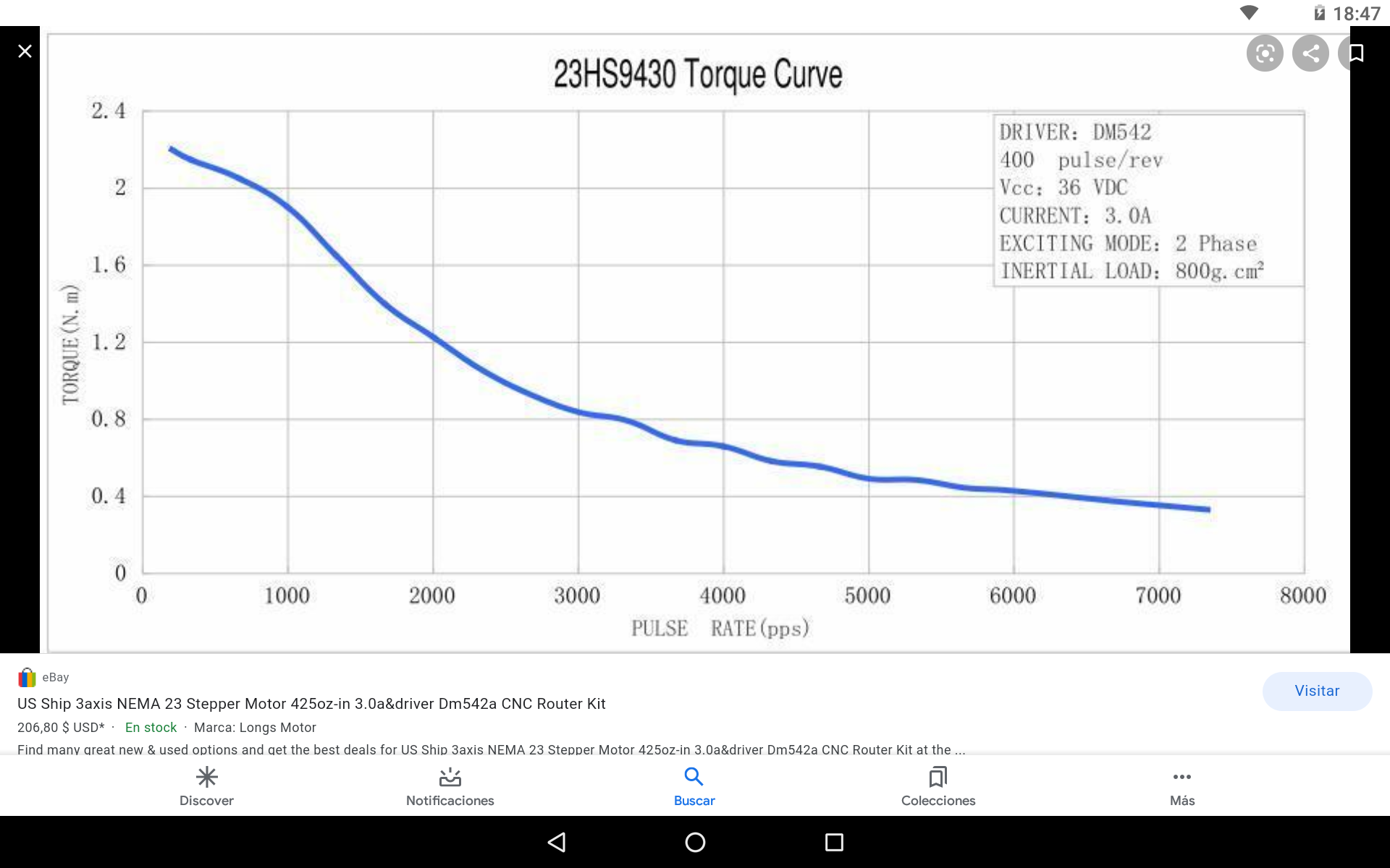

I will do machinedude. I found the torque curve of my current steppers. Assuming a total weight of 100kgs (I doubt it will exceed 50) and a safety torque of 1.5Nm, looking at the graph, I get an acceleration of 15mm / sec²:
F=M*a => a=F/M => a=1.5Nm/100kgs => a= 0,015m/seg²*1000= 15mm/seg²
Which I don't know if it's correct or just absurd.
Regarding the speeds, putting an average of 1000 mm / min working divided by 5mm of pitch would give 200 rpms of the motor, which going to the graph I think falls within the torque range. The cutting conditions would have to be taken into account, I know, which creates the following doubt ... Will more problems come from the spindle than from the motors?
Last edit: 07 Sep 2020 18:10 by RoberCNC.

What is your maximum velocity mm/min when cutting?
If you are using these drives you linked to earlier, they might be OK. I had a look at our model using our Z axis lead screw model for a plasma machine, (eg no cutting forces but the force of gravity to overcome),
At 500 mm/min, it requires 3.0 amps RMS (3.9 amp peak). Temperature rise would be 13 deg C over ambient (whats your hottest day in your shed?).
So on those values, it passes our model. eg.
RMS amps do not exceed the max, the motor won't melt.
If all else fails, you could make say a reduction drive that is bolt on compatible with Nema 23 as I did in this thread.
forum.linuxcnc.org/30-cnc-machines/31509...-loaded-pinion-drive
Or add a planetary gear box.

Well the speed depends a bit but I usually work in a range between 800-1000, for fear above all.
As for the drivers, the ones you mention were candidates for replacement discarded for not knowing the torque curve, the ones I currently have in use are DMQ860MA with the steppers that I have attached to the curve, yes. As for the temperature, they get quite hotter than 13 degrees above the hottest day hahaha.
What do you think of the 15mm / sec² of acceleration that I get as a result?
Does it make any sense ???: blush:
