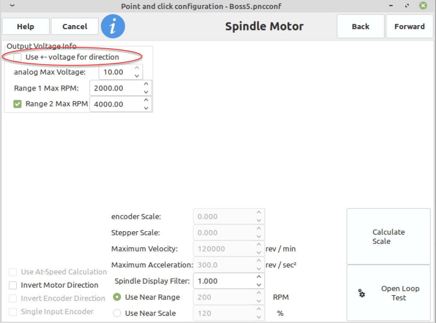

- Posts: 18080
- Thank you received: 5316
02 Oct 2020 01:10 #184525
Replied by PCW on topic Spindle wiring for Mesa 7I76E and Teco EV series VFD
change:
net spindle-vel-cmd-rpm => pid.s.command
to:
net spindle-vel-cmd-rpm-abs => pid.s.command
to:

- Posts: 18080
02 Oct 2020 01:33 #184527
Yes, pncconf will use the -abs spindle command
if you don't check +- voltage
