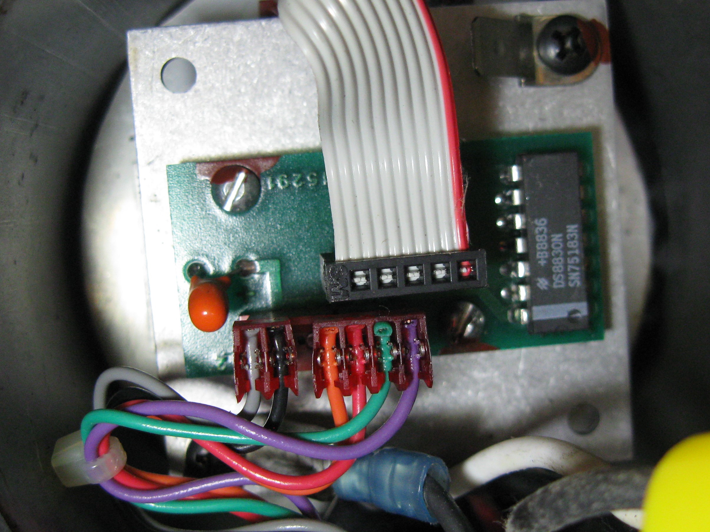

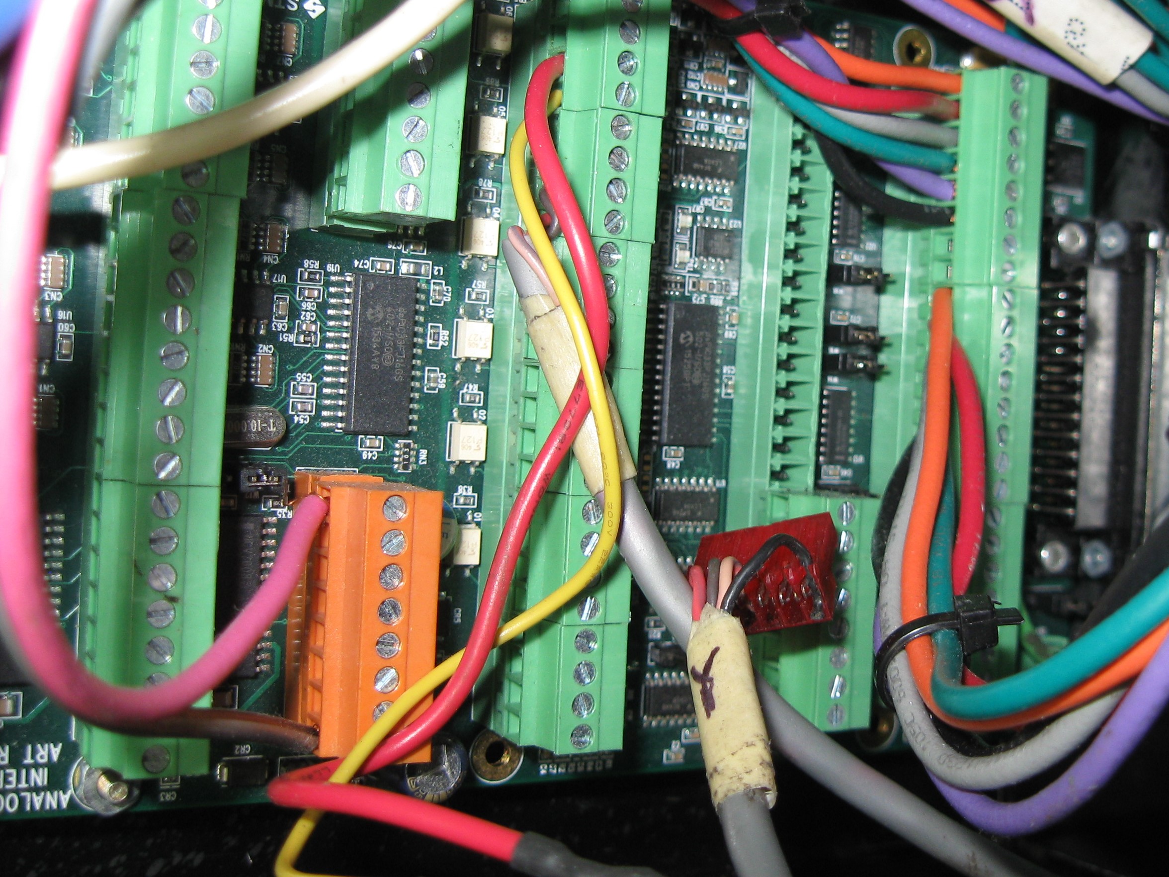

- new2linux
- Posts: 711
- Thank you received: 9
09 Oct 2020 15:38 - 09 Oct 2020 18:05 #185483
by new2linux
Replied by new2linux on topic SouthWestern Industries Prototrak servo drive replacement with A-M-C 12A8
Todd, Many thanks!! I believe it is "just A and B with index and power wires", check the pic, yes the pic success these pics were cropped. One pic shows the 7i77 card. The one pic looking at the encoder shows what looks to be a spade connector needs to go to ground. This is 1st time having this end cap off.
Last edit: 09 Oct 2020 18:05 by new2linux. Reason: pic size exceded did not work, will try again

09 Oct 2020 16:14 #185488
Replied by Todd Zuercher on topic SouthWestern Industries Prototrak servo drive replacement with A-M-C 12A8
I don't recall seeing any photos of your encoders or their wiring. (There were a couple images of your motor labels on the other thread, but no encoders.)
- Todd Zuercher
- Online
- Posts: 4786
- Thank you received: 1476
09 Oct 2020 20:43 #185505
Ok, according to how you have it connected to the 7i77 the encoder is differential without index.
