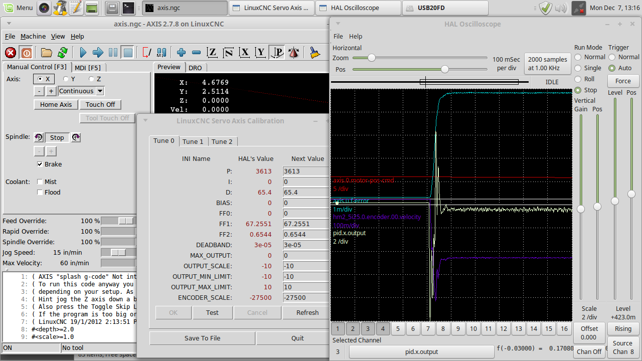

Many thanks to all that make this forum so helpful, I am so grateful. Attached is a pic of latest hal scope of x axis. I have started with the P, I & D setting from prior setup that worked. See name of file for detail settings. I have several drives, but only 2 have green LED and do not have "run away" as soon as e stop is released. The pic is of x axis and this axis works as per commands, arrow keys.
The drive in y axis will not respond to arrow keys, but DRO shows motion & velocity shows the feed rate that is selected, but no motor motion.
I believe the drive in the x axis is working and needs more tuning. The only difference in the tuning of this drive and the original 12a8 is that I did not have data sheet on motor and POT 2 (I think is the one to adjust max current) so the tuning may not be exactly the same.
The drives that I have that I don't think will work; 1 of them has Red LED; 2 of them make the motor run away as soon as e-stop is released.
Any help warmly welcomed. I plan to buy 12a8 (or something close) drive from ebay.
Many thanks

Did you read my response on your other post? I marked up your analog drive connections. The ones shown here look correct.
Is it possible that one of your drives are still miswired?
