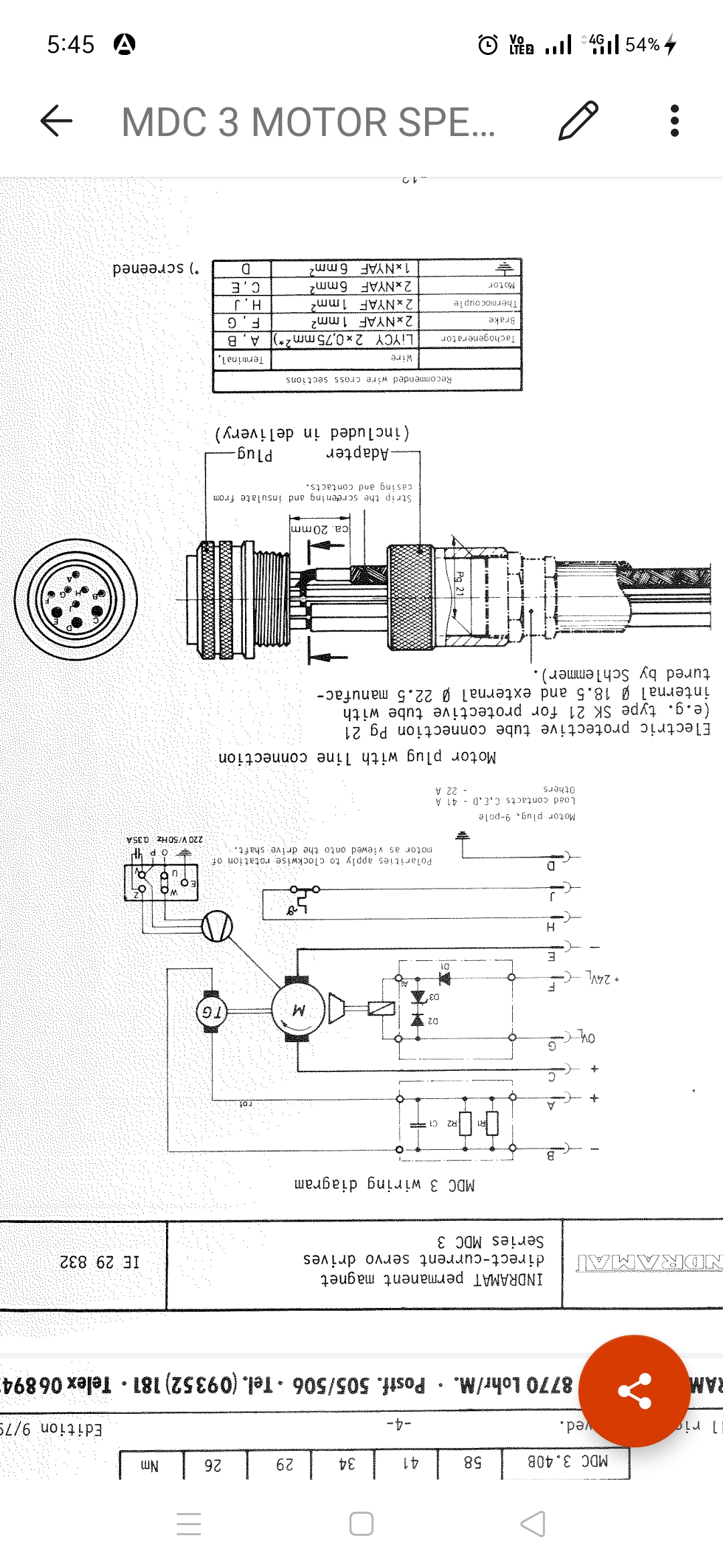

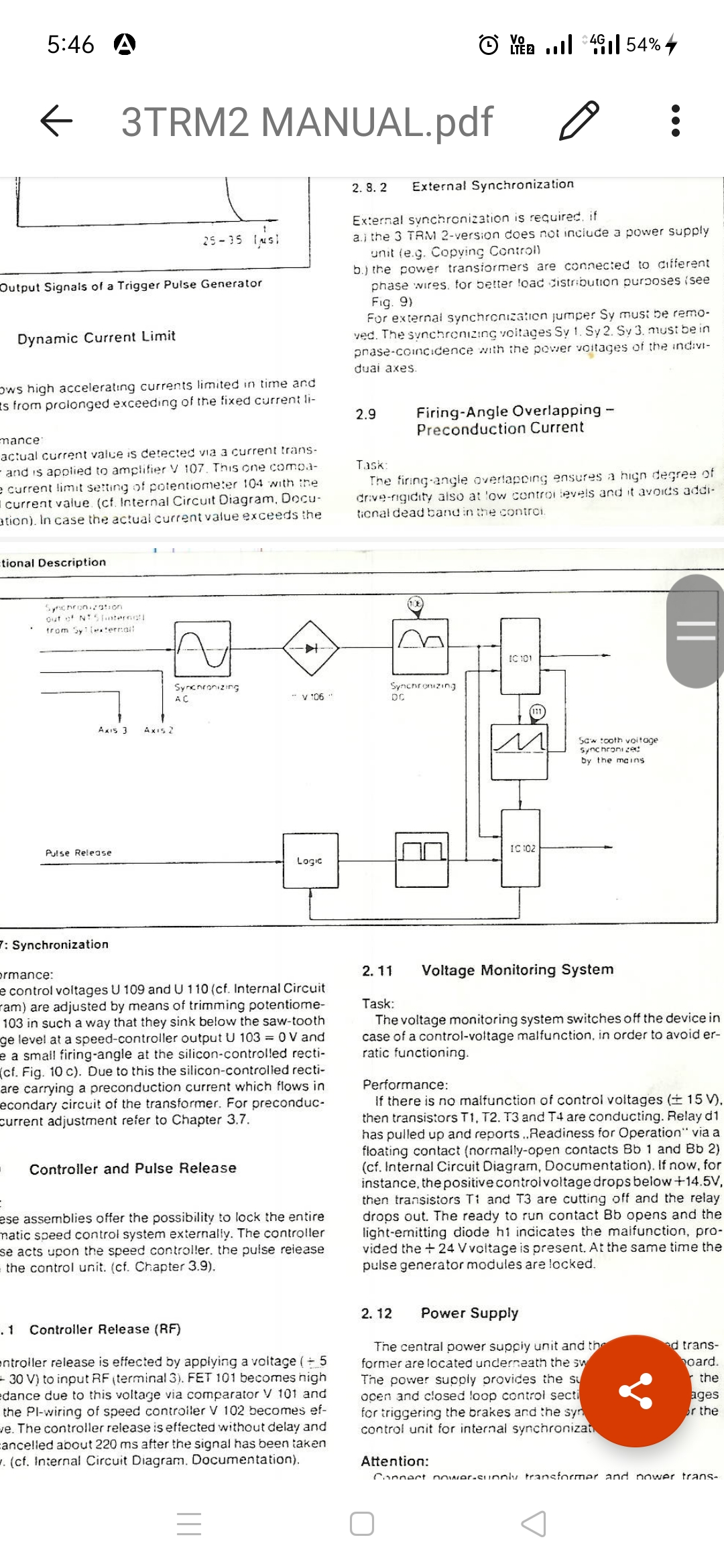

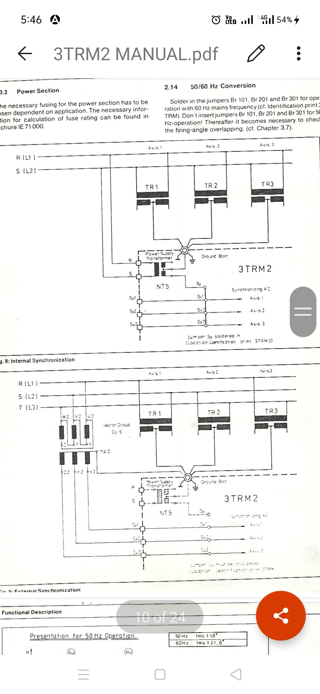

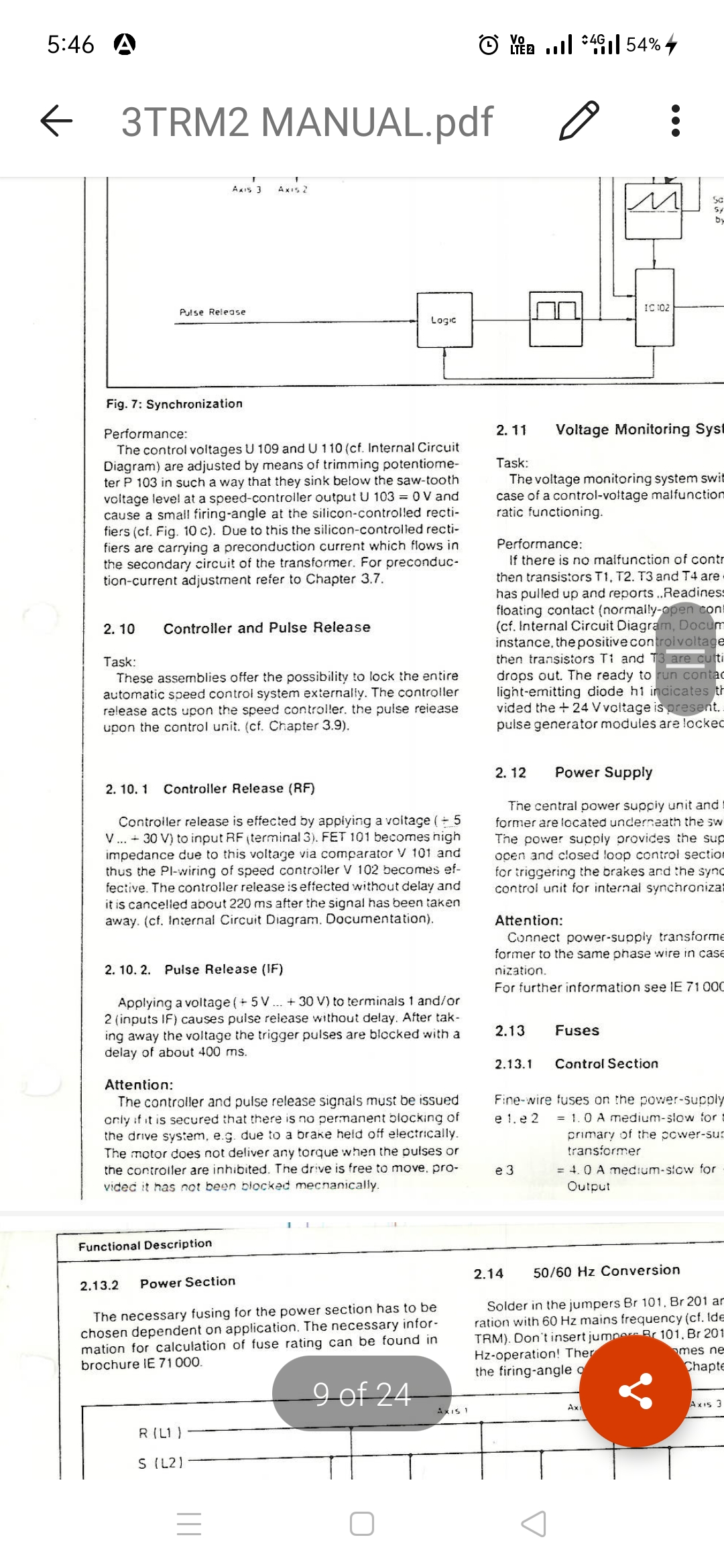

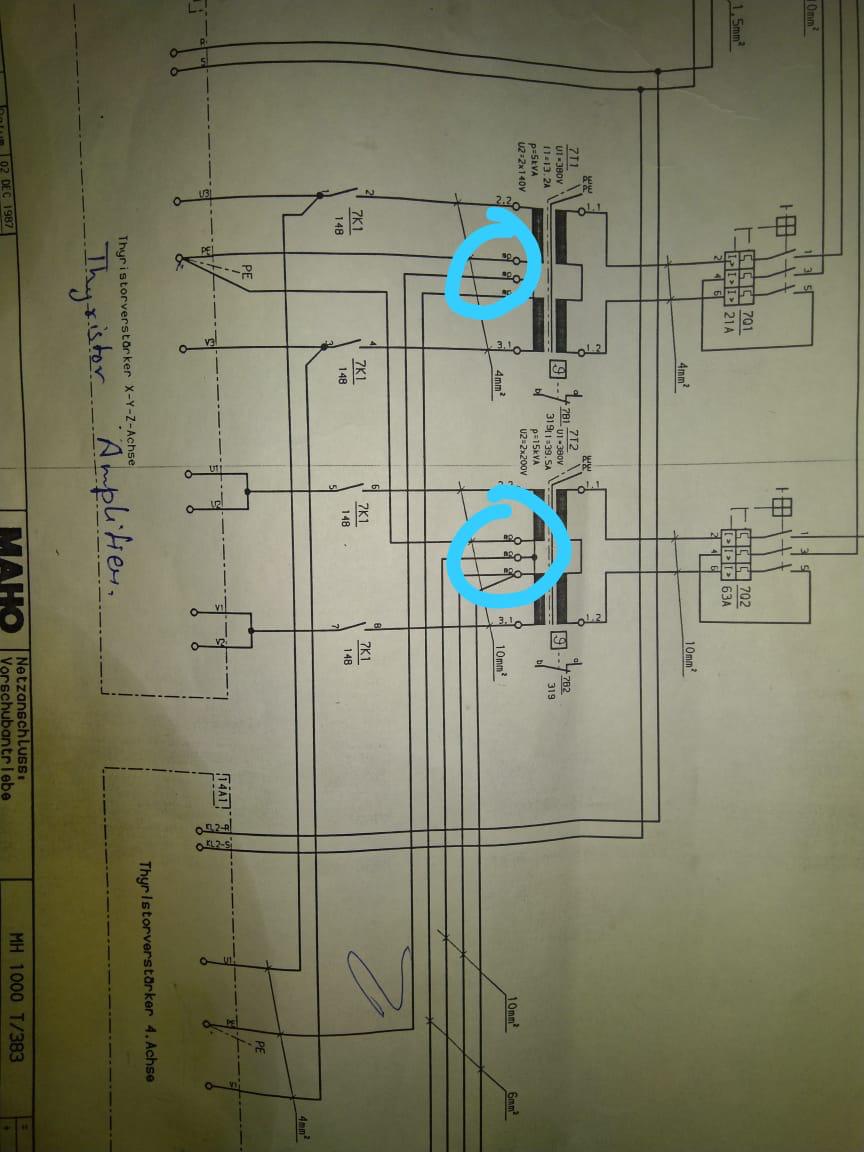

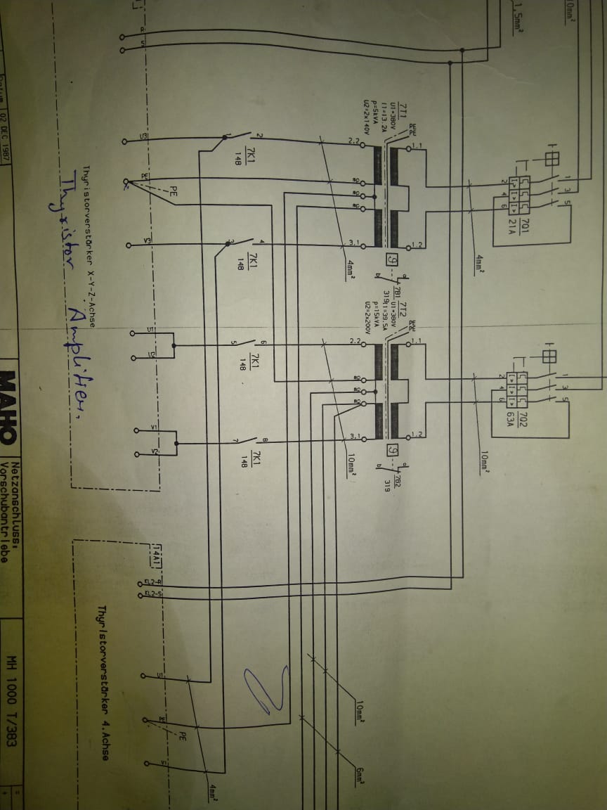

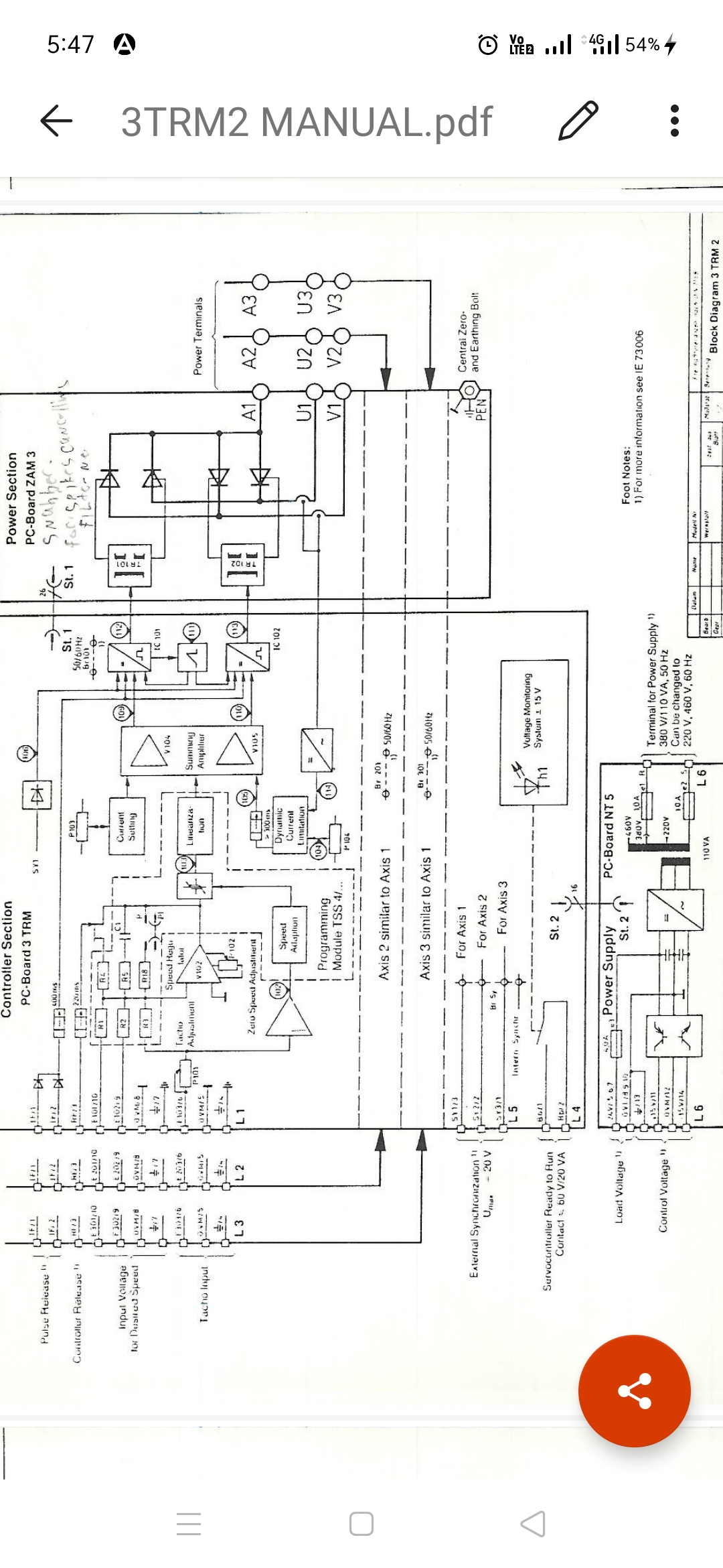

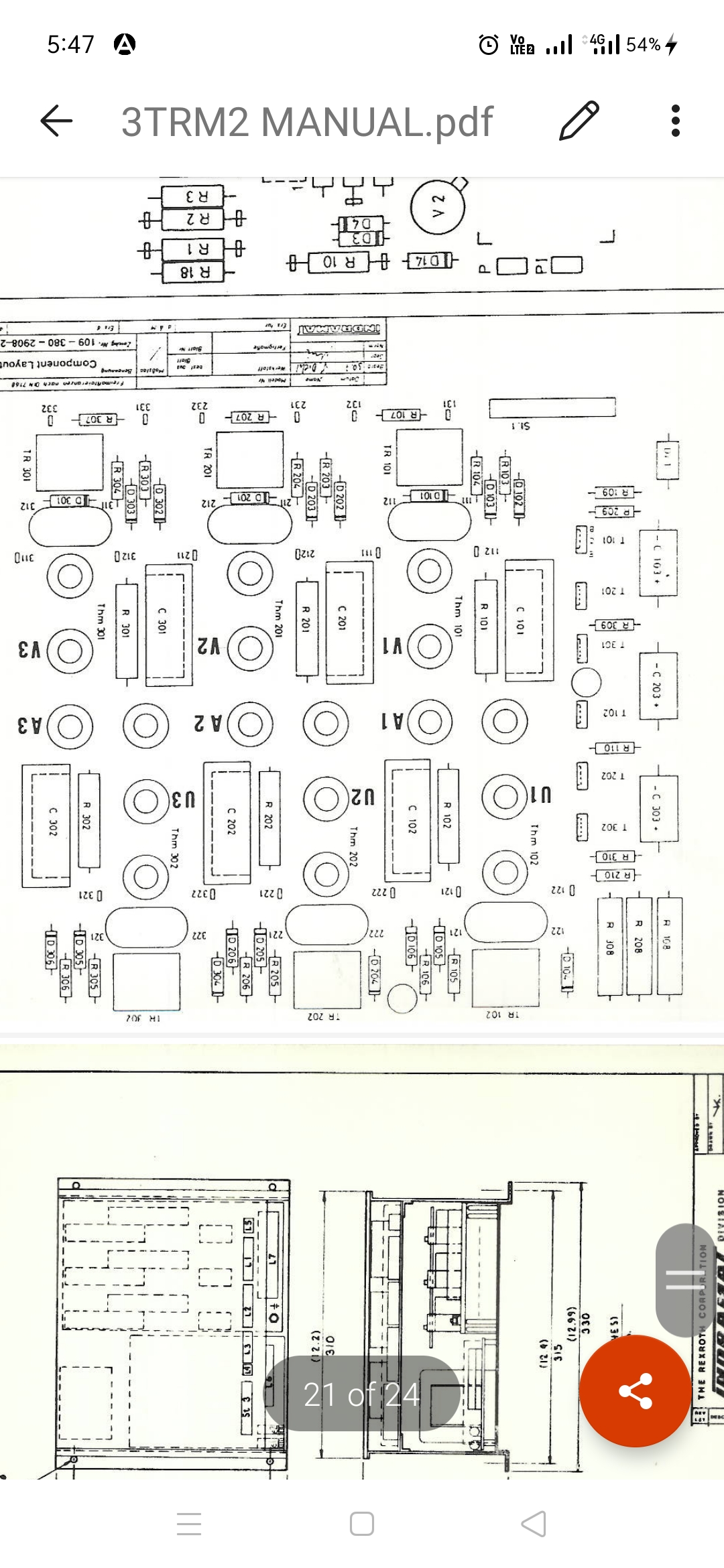

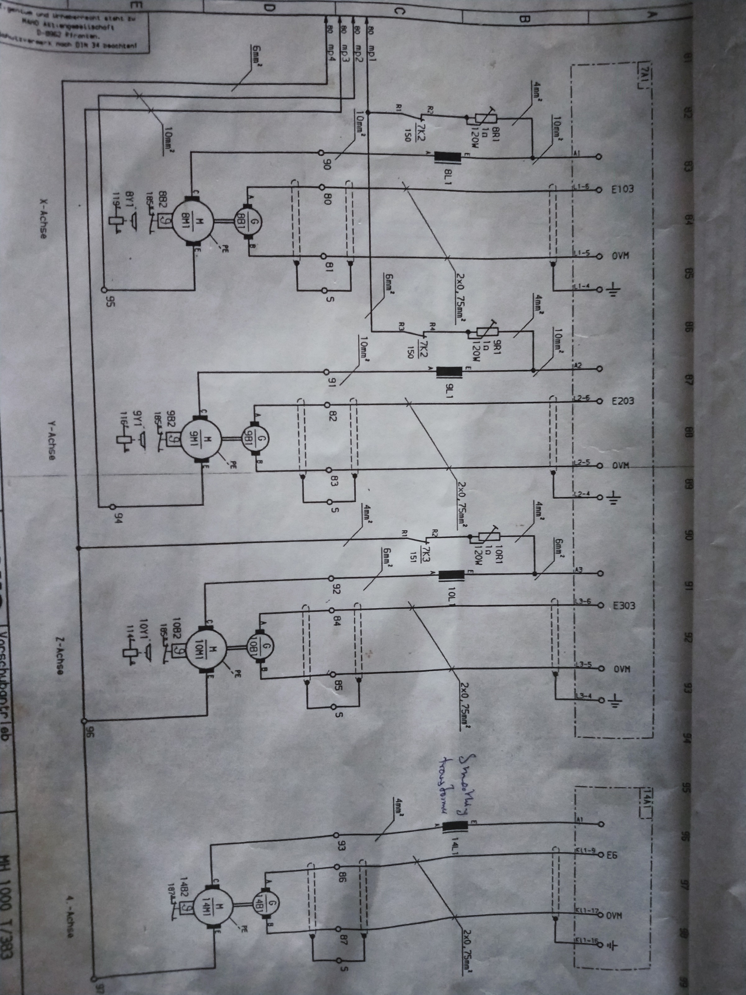

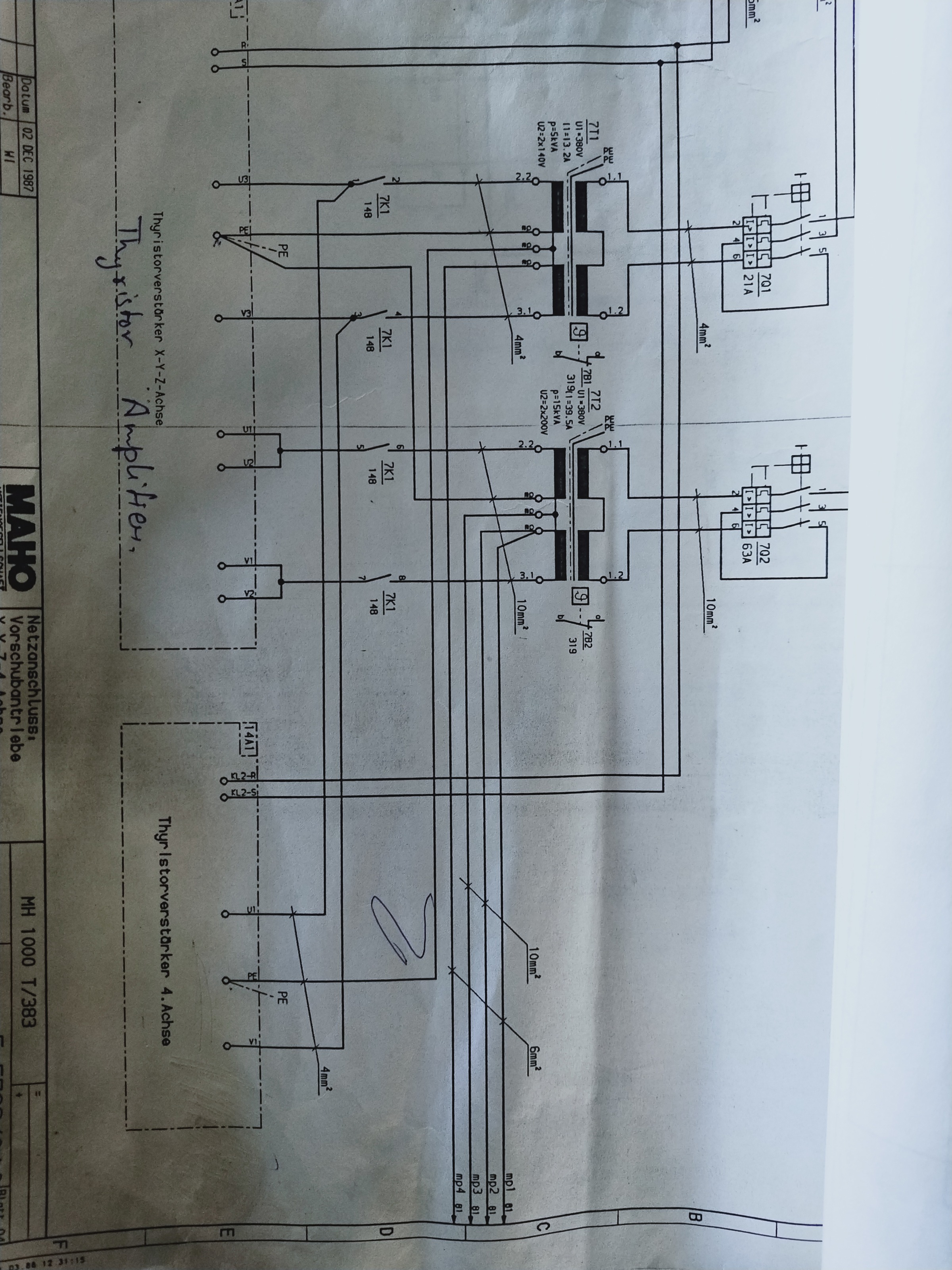

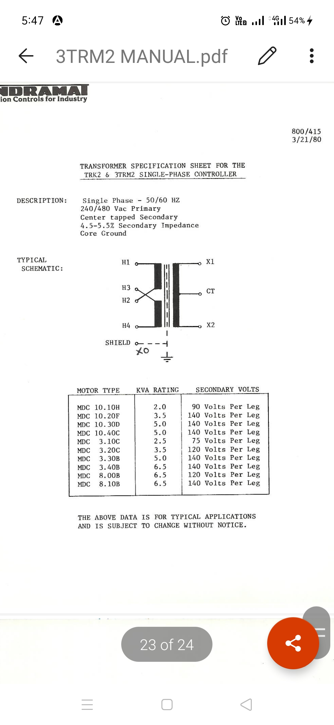

I have a old maho and I'm planning to retrofit it with linux cnc using mesa cards. Unfortunately the wiring is ripped off from the system. And i want to use the same 4 indramat mdc 10.40c motors, one 3trm2 drive and one 2trm1 drive. I'm attaching the photos from manual of 3trm2, mdc motor, and some pics from maho manual. My question is, i don't know what "mp" means(in maho manual pics near 7t2 transformer.... Not mentioned on the transformer either). Can anyone please tell me wiring for "U", "V" and "A" terminals to the motor.... Using the smoothing transformer and the resistance? I'm a bit confused withthe 4th axis motor wiring (2trm1) and 3rd axis in 3trm2.

I can't see MP near the 7T2 transformer.
And, equally unhelpfully, I don't know what U, V and A are.
UVW are generally used as the three phases of a three phase motor, but these seem to be DC motors.

I have a maho with that same 3trm2 drive,without the 4th axis and the additional drive.
The transformer that feeds the drive is single phase output with a centre tap. The centre tap is connected to the drive frame which is also machine ground. One of the motor leads is also connected to this tap, while the other is connected to A1. 2nd motor to A2 and so on. Some of these drives have seperate U and V terminals for each axis marked U1 U2 U3 and same for V. Others have a common U and V terminals.
U and V is connected to the other two taps on the transformer which is the power supply to the drive for driving the motor. That's is also another power supply for the control side on the drive.
I think the resistor you are referring to is a braking resistor that shorts the motor armature when you press Estop. Under normal running they are bridged. Is mp1 to 4 not just referring to another page?
Henk

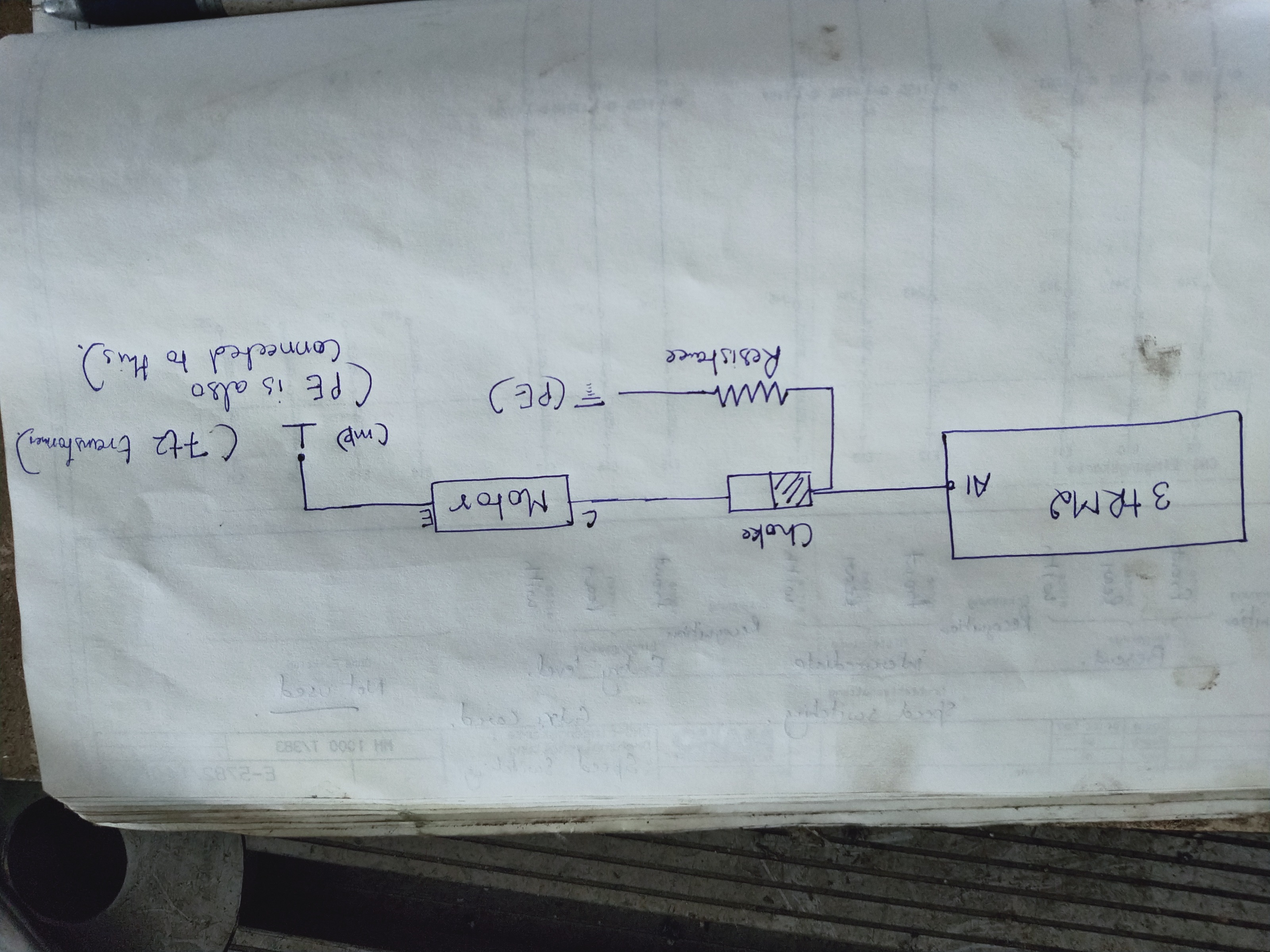

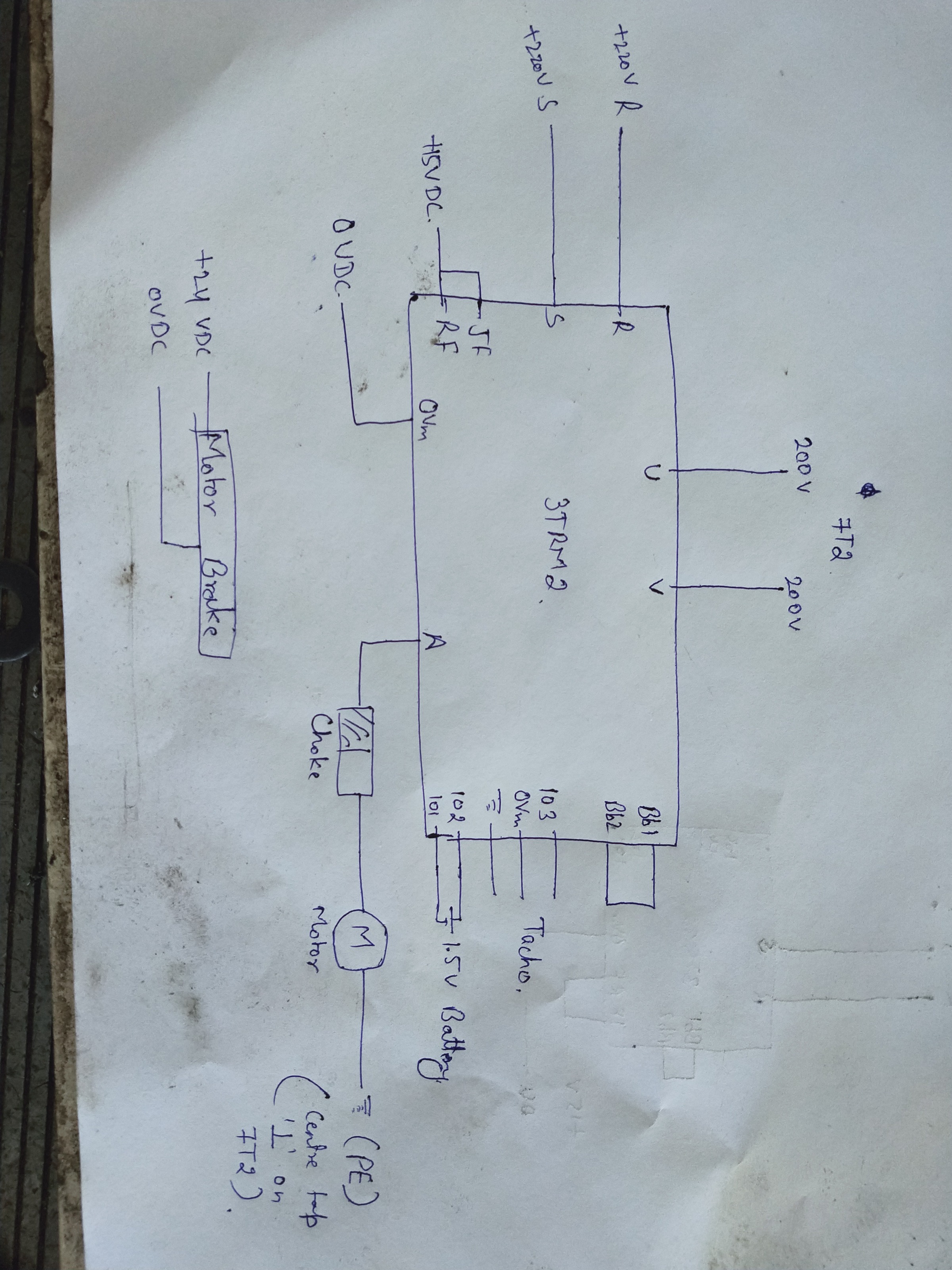

Your knowledge is really good. Thanks for helping me out. The "mp" connection is connected with the ground. Do you think this mp is the centre tap? I have attached the picture of "other page" as you asked. Can you just tell me wiring from A1 to motor ( through resistor and smoothing transformer)? I have already connected U and V. I just want to know how can i connect the motor with this drive?

I would connect it the same as shown in your diagrams. Mp is the centre tap. So when 7k2 is closed there is a 1ohm resistor over the motor leads and it will stop fast. 7k2 must open before the drive is enabled. So wire this in your Estop circuit. Drive must only be enabled after 7k2 is open. A1 must go through the choke or what you call smoothing transformer BL1 always regardless of whether 7k2 is open or closed.

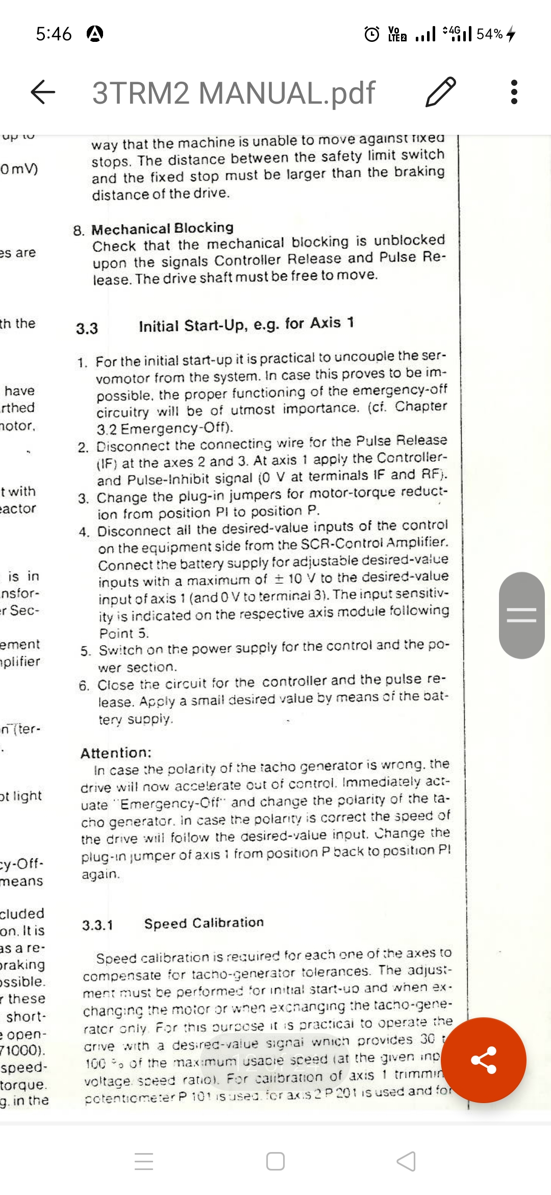

Leave the resistor out as well. Connect A1 to the choke and the choke to the motor as shown.
You can use a 1.5v battery to test.
After you enable the drive, if it runs away fast...reverse the tacho feedback wires.
Without feedback from lcnc, the motor will probably drift slowly before you apply the speed ref 1.5v
