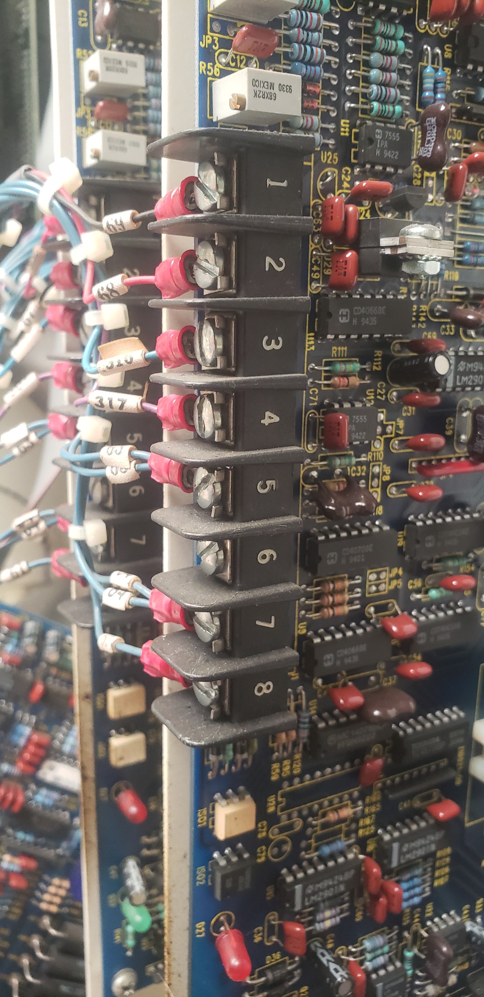

Do pins 3,4 on the 8 pin terminal go to a Tachometer?
If they do its likely similar to other Motion Science drives:

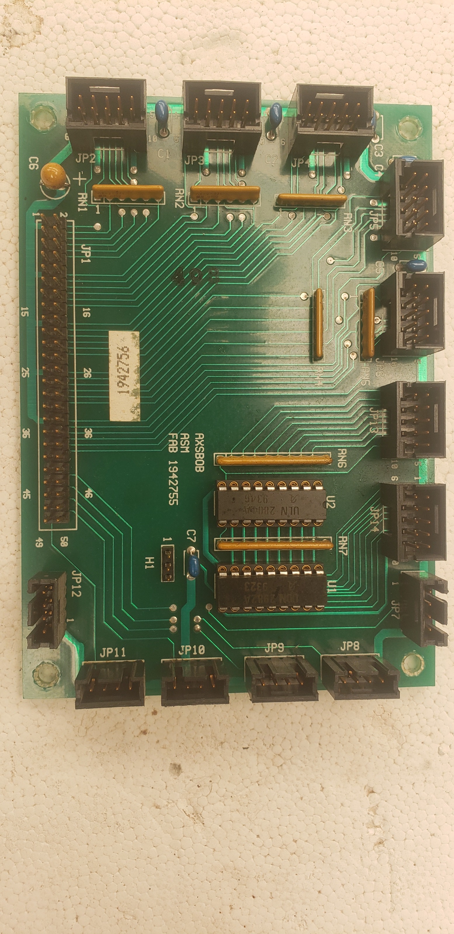

I've tracked out the encoder output and it all goes into a axsbob. From that same board are wires that go to pins 1 and 2 on the servo amp. I'm thinking the computer handles the encoder feedback and tells the amp what to do from it.(1,2 +-10V analog, 3,4 Tachometer,5,6 current monitor and limit,7,8 drive enable)

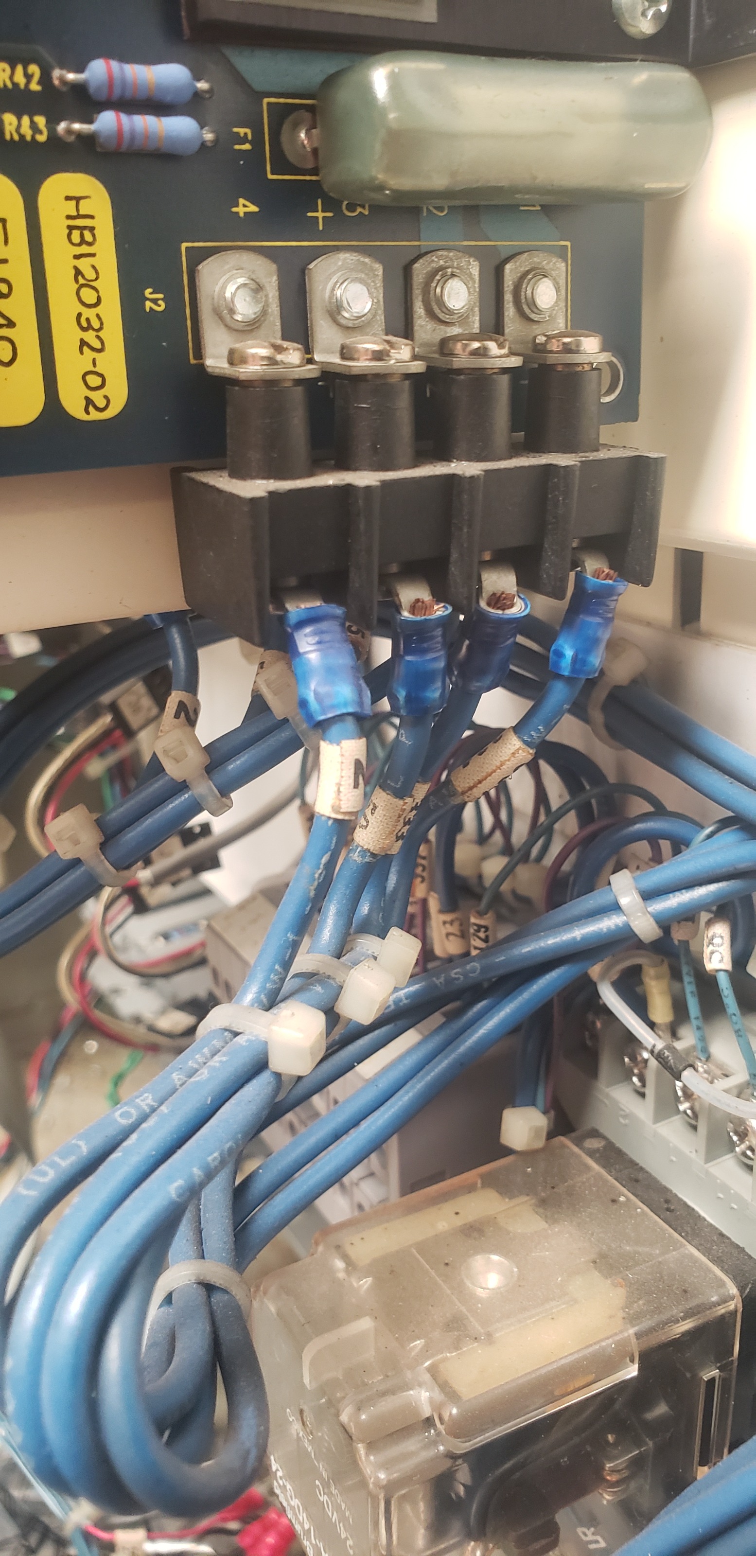

Amps have
1,2 +- 10 volt
3,4 tach
5 ground
7 axis enable
8 axis fault
Now hopefully this is enough information for those gurus who have helped already to assist me better.

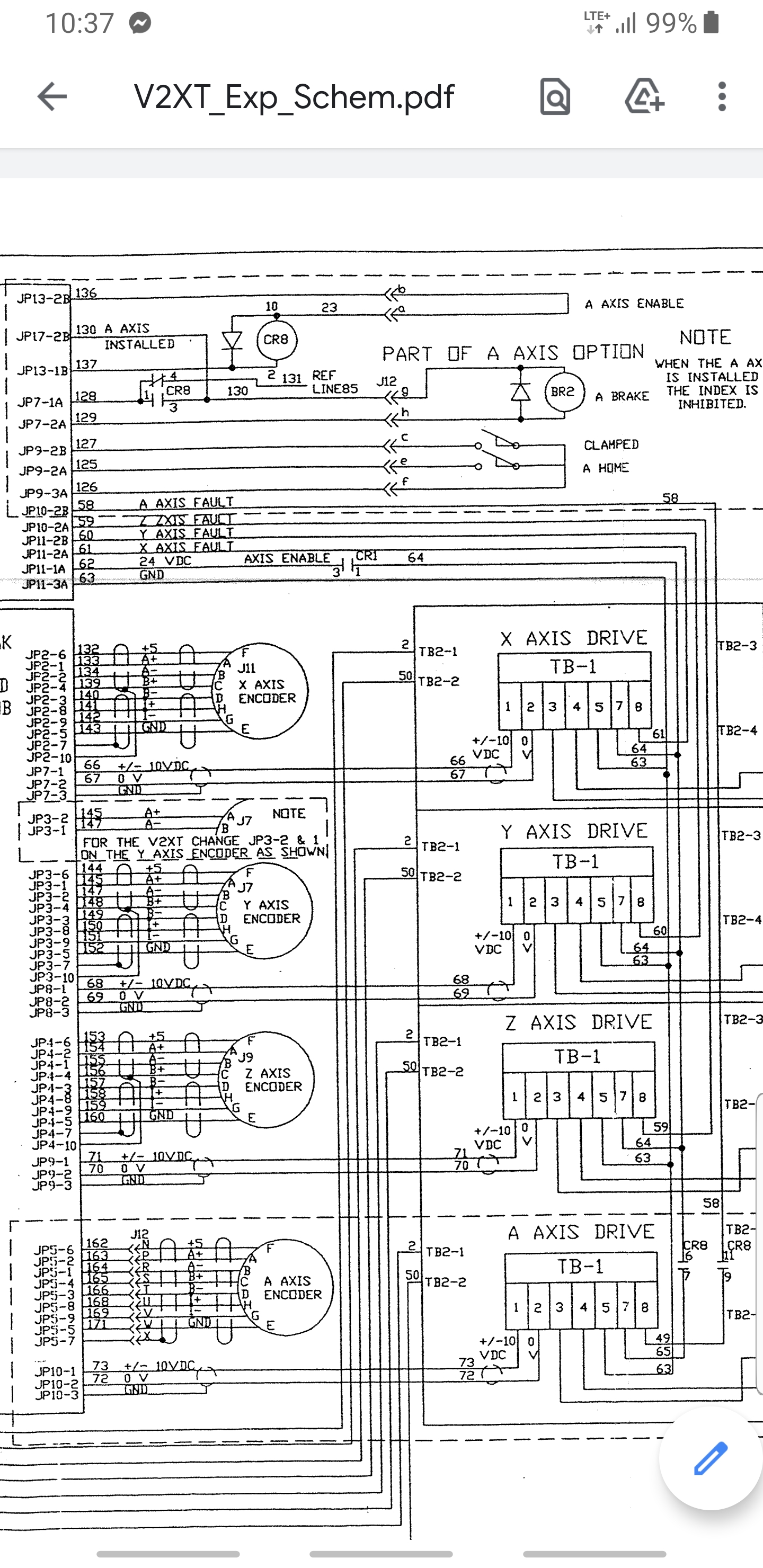

The next thing would be to figure out how the drive enable input and
fault output work, that is, what needs to be supplied to the enable input to
enable the drive and what signal level comes from the fault output.

Looks like according to the schematic it's 24v for the drive enable.
I've included the drive and encoder part of the schematics.
Any idea what kind of board is capable of handling the encoder input and sending the analog signals to the amp?

Great advice on the 7i92 and 7i77 Combo it's same advice given to me by Peter with Mesa and exactly what I ordered. I got the 7i92H and 7i77 and a cable because the area I'm working with is just a little too tight to put the two boards together and fit.
To change where I'm planning on putting the cards would require much more rewiring. I'm just going to pull out the AUF board and replace it, the axsbob and auxbob with the Mesa product.
