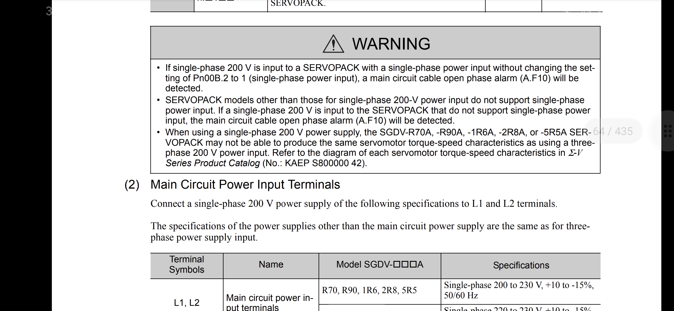

For drives under 4kW or so, the inputs generally use passive rectification (as opposed to active PFC), so they are fine on either single phase or three phase as long as the phase to phase voltage is appropriate - they don't know or care either way. The input rectifier bridge has to work slightly harder with single phase, as you are only using 4 diodes instead of 6 but they are typically rated for that application anyway. Besides, unless you are running your drives at full rated power continuously, you won't be pushing them. Looking at the Sigma 5 manual, Yaskawa don't require derating for operation on single phase.

09 Nov 2021 23:05 #225890
by Michael
Replied by Michael on topic Servo Purchase Recommendations, Yaskawa?

That's helpful. So you need to check that your model has the Pn00B.2 parameter and it's a 200V Class drive if you really are stuck with 3-ph equipment.
Most of the drives I've used have been 1-ph out of the box (Yaskawa VFD and servo) or will tolerate either 1-ph or 3-ph (Lichuan and DMM Tech servos).
