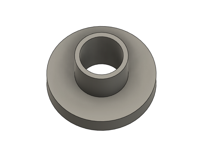

I do not know if a 3d printed bushing (100% infill) can take the abuse.
the inner diameter of the bushing (spacer) will be 12mm (the rod diameter), and the outer diameter is the id of the shaft. this is only for centering, I do not see any torsional loads will be exerted on such piece (both elements rotating) unless the nut wants to get loose with vibration. which may present other safety consequencies more than damaging the spacer.
with such 3d printed piece, I use vey thick washer to be able to torque the draw bar nut to the shaft. I have to use some locktite.
If the 3d printed part fails, I think I can machine one out of aluminum using the same machine that I want the bt30 spindle for. I will use a high speed spindle with precautions.

this is what I mean

McMaster-Carr sells grade 12.9 metric all-thread. Add a flanged heavy hex nut to the top and a bearing washer between the nut and your 'top hat' centering bushing.
Coat everything (nut, washer, top hat, drawbar) lightly with never-seize. It also helps to machine or grind the nut and washer very flat, but you can sand & polish them flat on a surface plate to reduce friction while torquing the drawbar.
Pin the nut to the all-thread and you've got a no-machining drawbar.
For your bushing a 3d printed item will be fine to locate the drawbar radially, but if the drawbar compresses the bushing flange when tightening it'll fail.

For the 3d printed part, I will have to agree that it will not stand a chance when tightening the nut against it.
