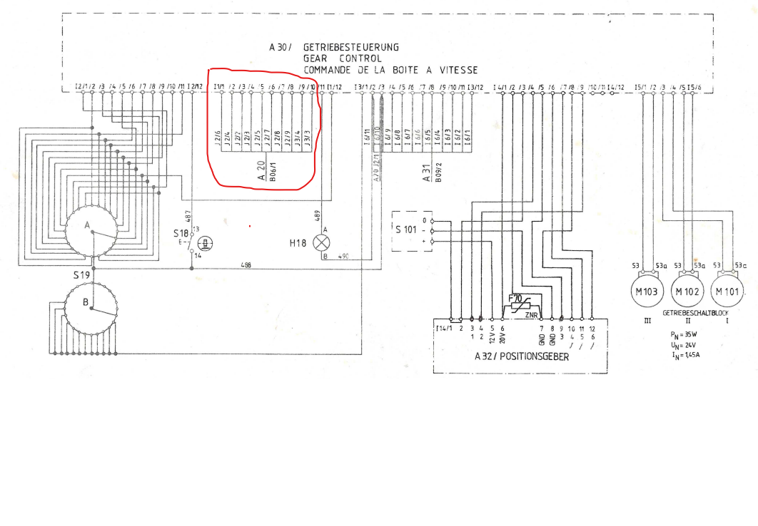

06 Dec 2021 23:13 #228481
Replied by tommylight on topic Mikron WF 2/3 DCM
Are there supposed to be two of the same pictures ?
We would need the other picture with A20 in it.

01 Dec 2022 21:51 - 01 Dec 2022 21:52 #258263
by Vojta333
Replied by Vojta333 on topic Mikron WF 2/3 DCM
I have complete manual for Mikron WF 40 C (31,5-3150 RPM) and hire is the bitcode for speeds and for M03,M04,M05 codes
docs.google.com/spreadsheets/d/15ErQ2TpD...xoE/edit?usp=sharing
I have TNC 145C and Bit 1 is J2/2, Bit 2 is J2/3 ... Bit 8 is J2/9
