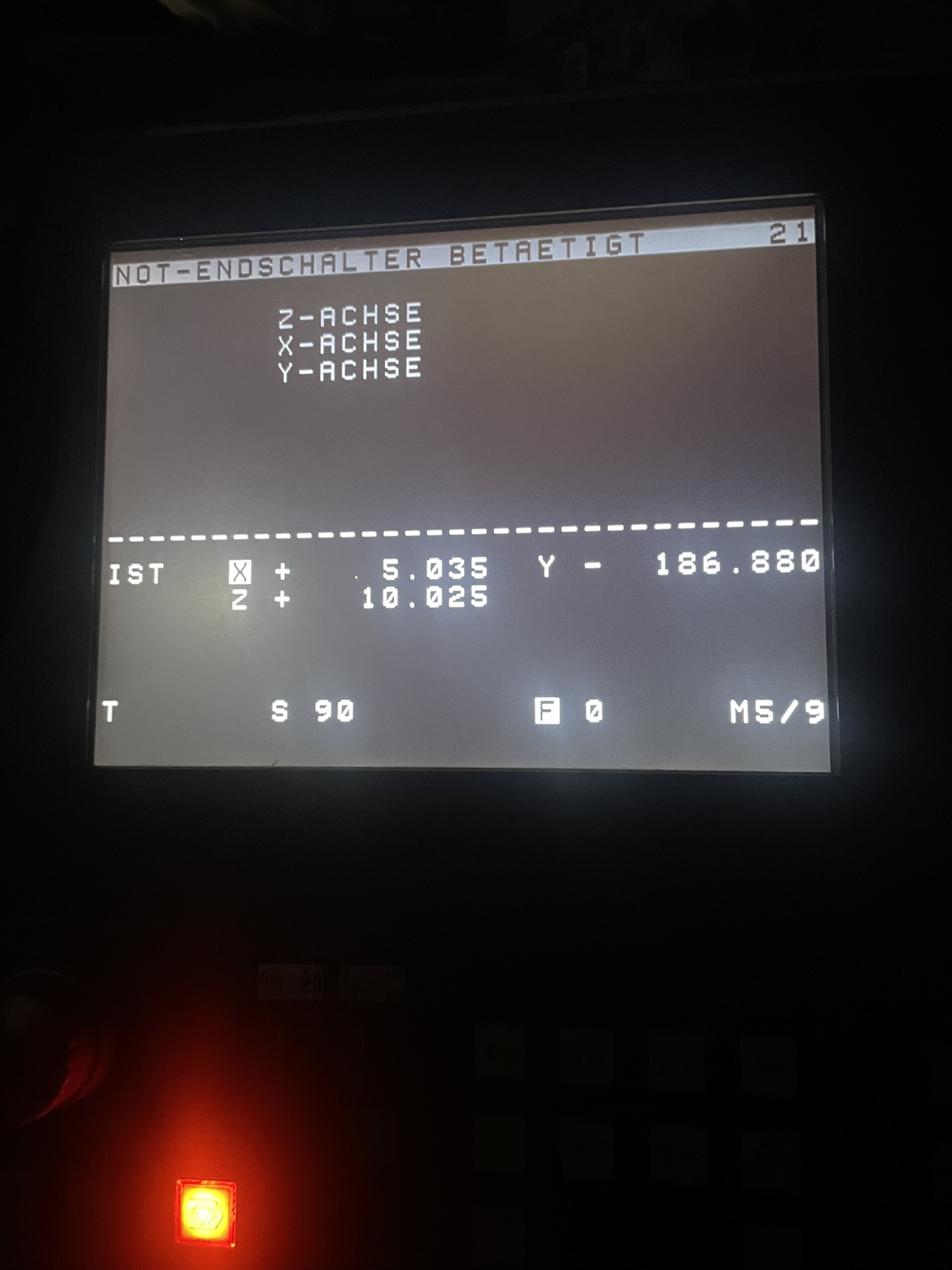

06 Jan 2025 20:35 #318260
by Masiwood123
Replied by Masiwood123 on topic Fehlmann Picomax 100 Retrofit
Hello, can you tell me if limit switches are NO or NC 24vdc...I have a similar machine and I am trying first of all to bring it to the factory control.. it throws out errors that one of the limit switch is on , control allows me to reference
to the z axis, xy will not reach the switches. linear scale on x is also filled with dirt and have to figure out how to clean it. thank you very much

14 May 2025 12:54 #328442
by anfänger
Replied by anfänger on topic Fehlmann Picomax 100 Retrofit
If its still of interest, the limit switches are normally closed, and go over a relay to the controls.
