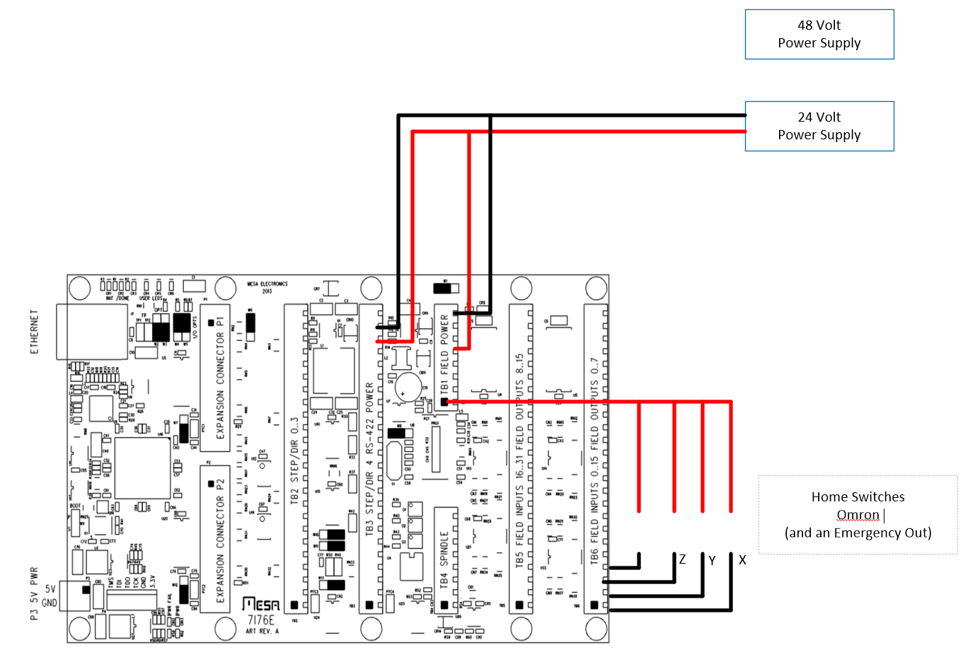

- powering the MESA 7i76e (see picture)

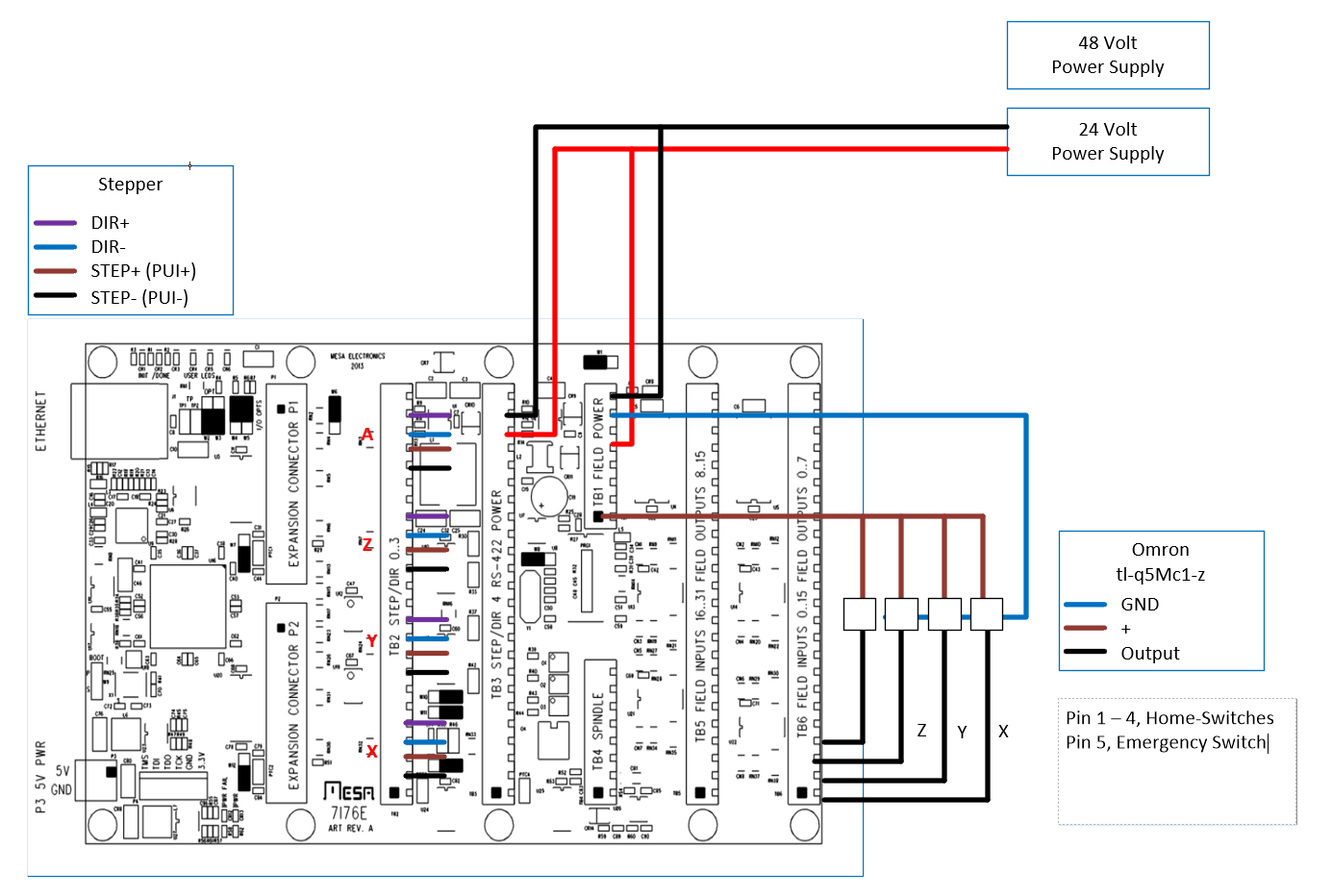

- connect the Stepper-Motors (should be quite clear - see scheme)
Stepper Drv________Driver (7i76)
PUL+ _____________STEPx+
PUL- _____________ STEPx-
DIR+ _____________ DIRx+
DIR- _____________ DIRx-
- connect the home-switches (see attachement 1)

Power it, connect to PC, set the network connection and ping the card to verify the connection.powering the MESA 7i76e
That should work, so for now move to testing by doing a config, see below.connect the Stepper-Motors
Use the built in "show hal configuration" to check if the switches are wired properly and they trigger.connect the home-switches

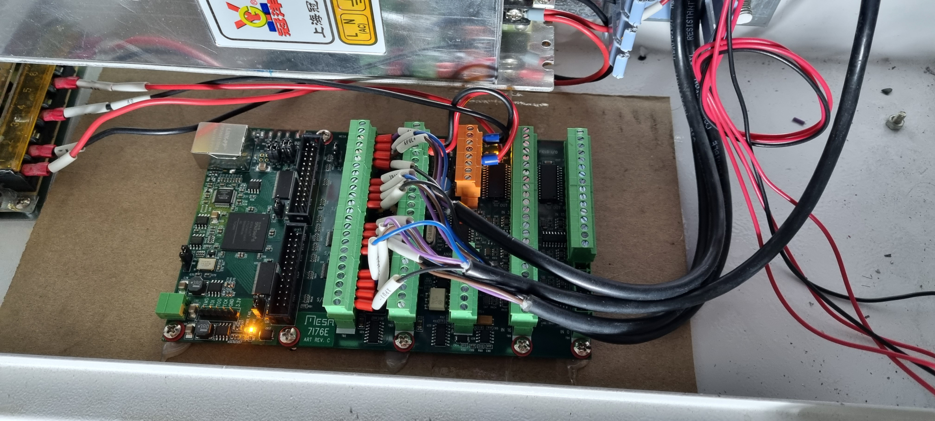

A Some progress today:
- power supply to the MESA Board is done
- cabeling of the steppers
- connection of the home switches
(getting GND of TB1/PIN7 is a temporary solution until a power distribution bar arrives) - connection of the emergency switch
- the linux installation has been updated
Thats the new connection status:
Here a picture of the switched on card (temporary placement in the housing)
One question:
If I do a PncConf - I write a totally new configuration? Right?
Which files do I have to copy to save the current one? I spent a lot of time during my first trials to configure the WHB0-4B-4 wireless wheel and I would like to save that work somehow.
