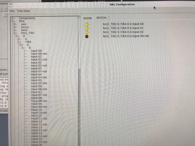

Have started getting the 7i92/7i85 going with the 7i84 io board initially. Flashed the 7i92_7i85xD.bit, connected the 7i84 to serial 0 and hooked power to everything. Made a simple HAL file attached with e-stop as an input and linuxcnc loaded up perfectly. I am however getting funny behavior where the input-00 is held high without anything connected to the pin (can be seen in the screenshot of HAL Config). Toggling 24V to the input pin doesn't change the pin state. Is there anything I have done wrong in the HAL definition?

Replied by PCW on topic Bridgeport Series 2 Interact 4 Retrofit
No, I don't think you can affect that in HAL
Looks like a bad or damaged 7i84.
All 7I84s must pass a loopback test (output to input test)
that tests all inputs and outputs, so whatever is wrong s something
that's changed on the card.
BTW, I tested a 7I92+7I76 configuration with 7I92_7i76x1D firmware
And saw no issues so that also look like hardware.(cabling? ESD?)

Thanks for testing PCW, good to know that the config for the 7i76 I had set up was correct. Theres a good chance that the board was shorted somewhere along the line and sustained damage. It will be replaced at some point as a backup card
Bit more playing around and agreed it seems that part of the board has some issues. Bugger... Bad luck here!
On the good side I have tested TB2 of the 7i84 and it appears to work just fine. Outputs and inputs are behaving as I would expect. Poking around it seems I don't have 24V on VFIELDA so possibly an issue there linking to the TB3 inputs.
