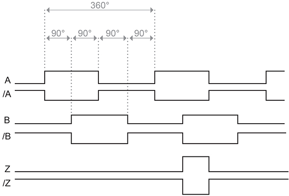

Got a easy question here I can’t figure out. On page 8 of 7i97 manual, what does the “/“ before the Q mean?
- Posts: 4819
- Thank you received: 2177
27 Jan 2022 14:57 #233276
Replied by Aciera on topic Anilam retrofit with Mesa 7i97
The following user(s) said Thank You: Kylizer
