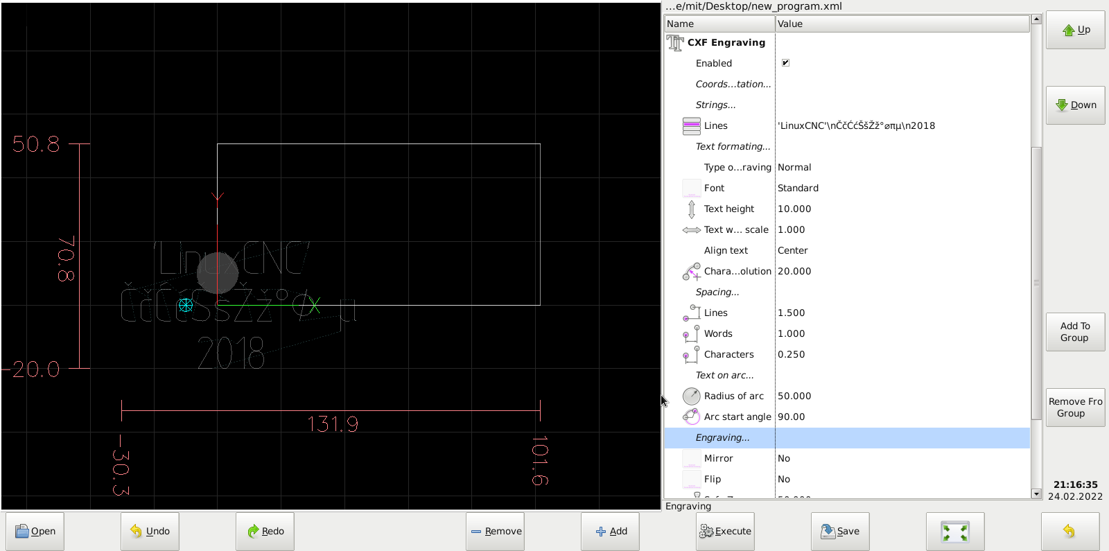

This was my attempt to engrave fonts with NativeCam.

Did you configure or install something special? I allways get errors when I try this NativeCam function.
Which NativeCam Version do you have?
