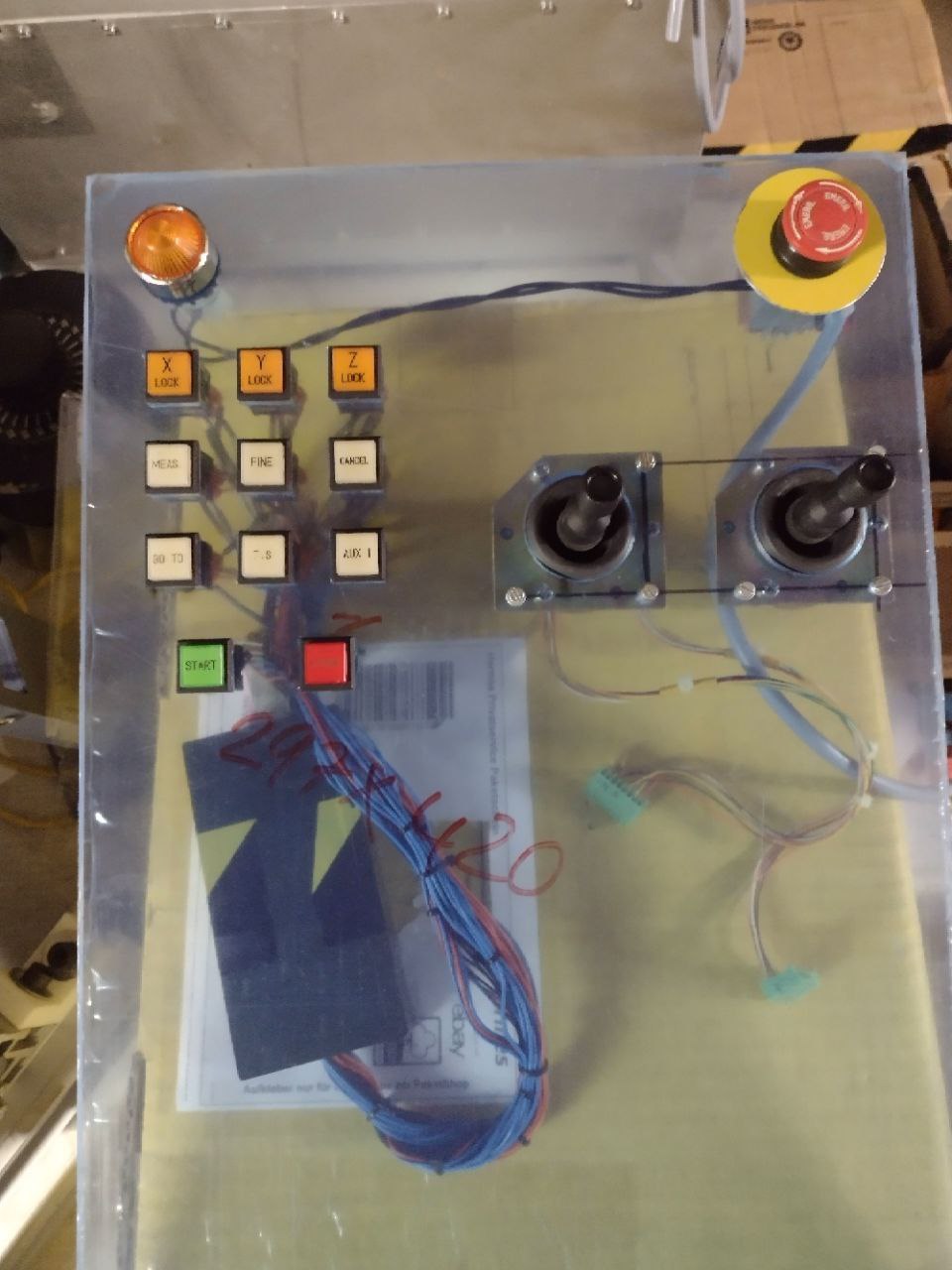

Hello everybody,
I'm building a Sinker EDM from scratch, because I find it very interesting and there isn't really a open source project to build a sinker EDM machine. I don't have any experience with LinuxCNC, but it seemed like the best solution.

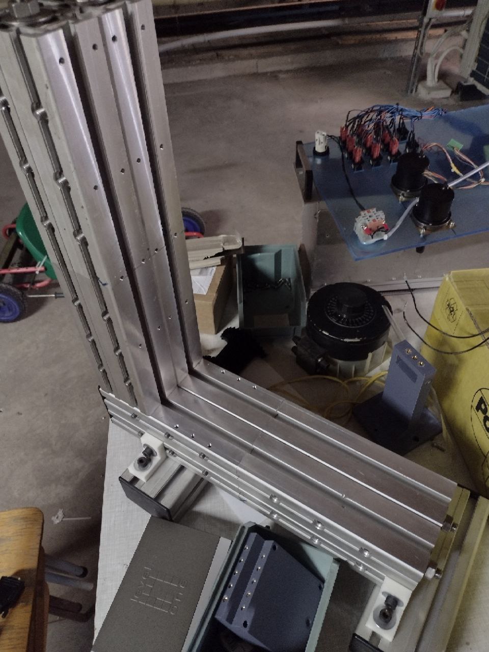

The mechanical design is fairly straight forward, like a C type milling machine with 3 axis. The X-Y stage is most likely from a microscope. The forces in sinker EDM a minimal, so the mechanical stuff won't give me much issues.

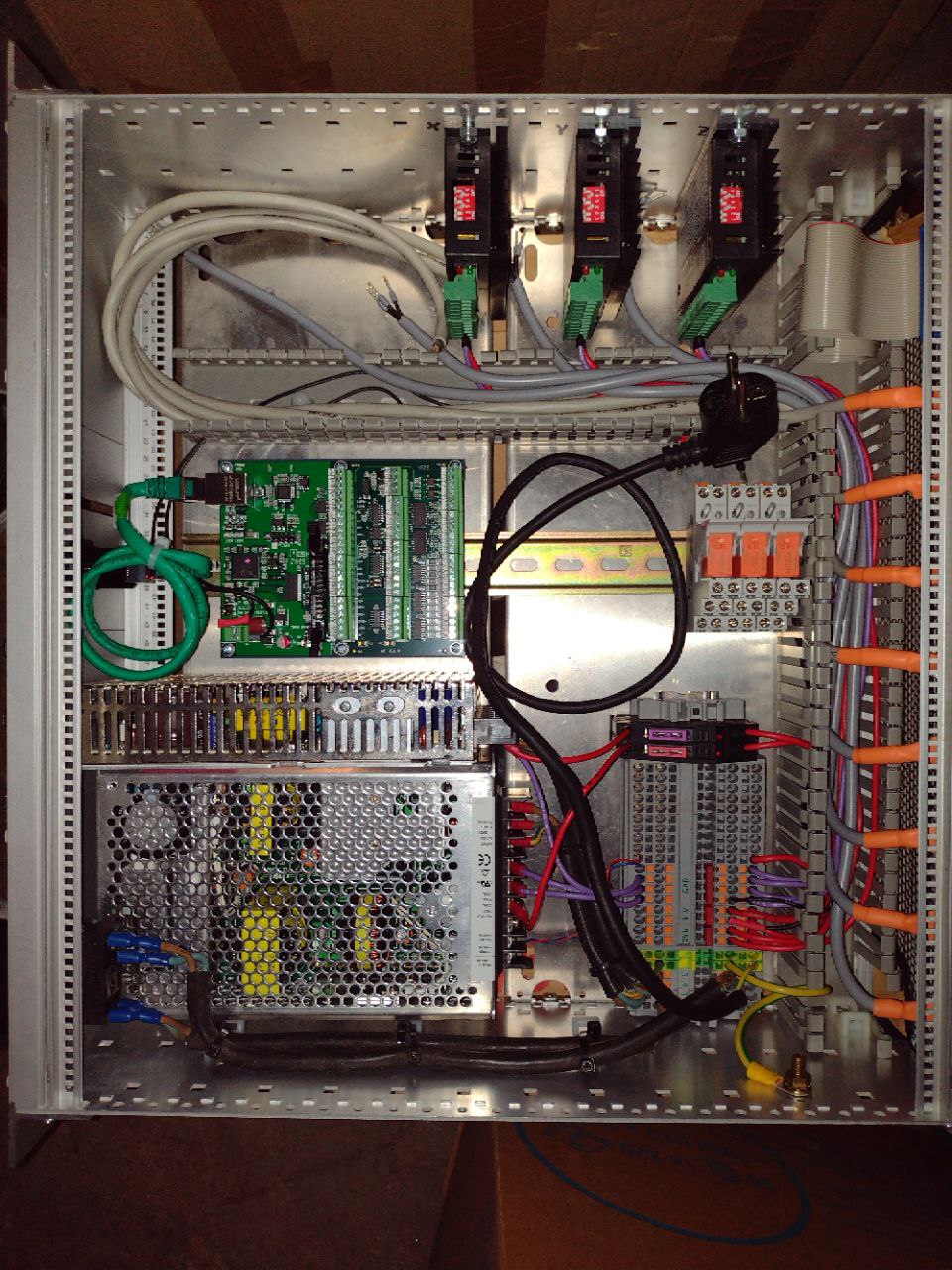

- Mesa 7i96s Card (a card with more pins would be better, but my budget is limited)

- homebuild machine base and motion system, mostly stuff of ebay
- custom flushing system (water based, because petroleum is a fire hazard and I want the machine to run unsupervised )
- fairly small build volume of 100x100x140mm

- CNC control - 70% done
- mechanical - 80% done
- EDM power supply - only exists on paper
- flushing system - all the parts, except the pumps, arrived
- control panel - 70% done
- custom control software - 0% done
