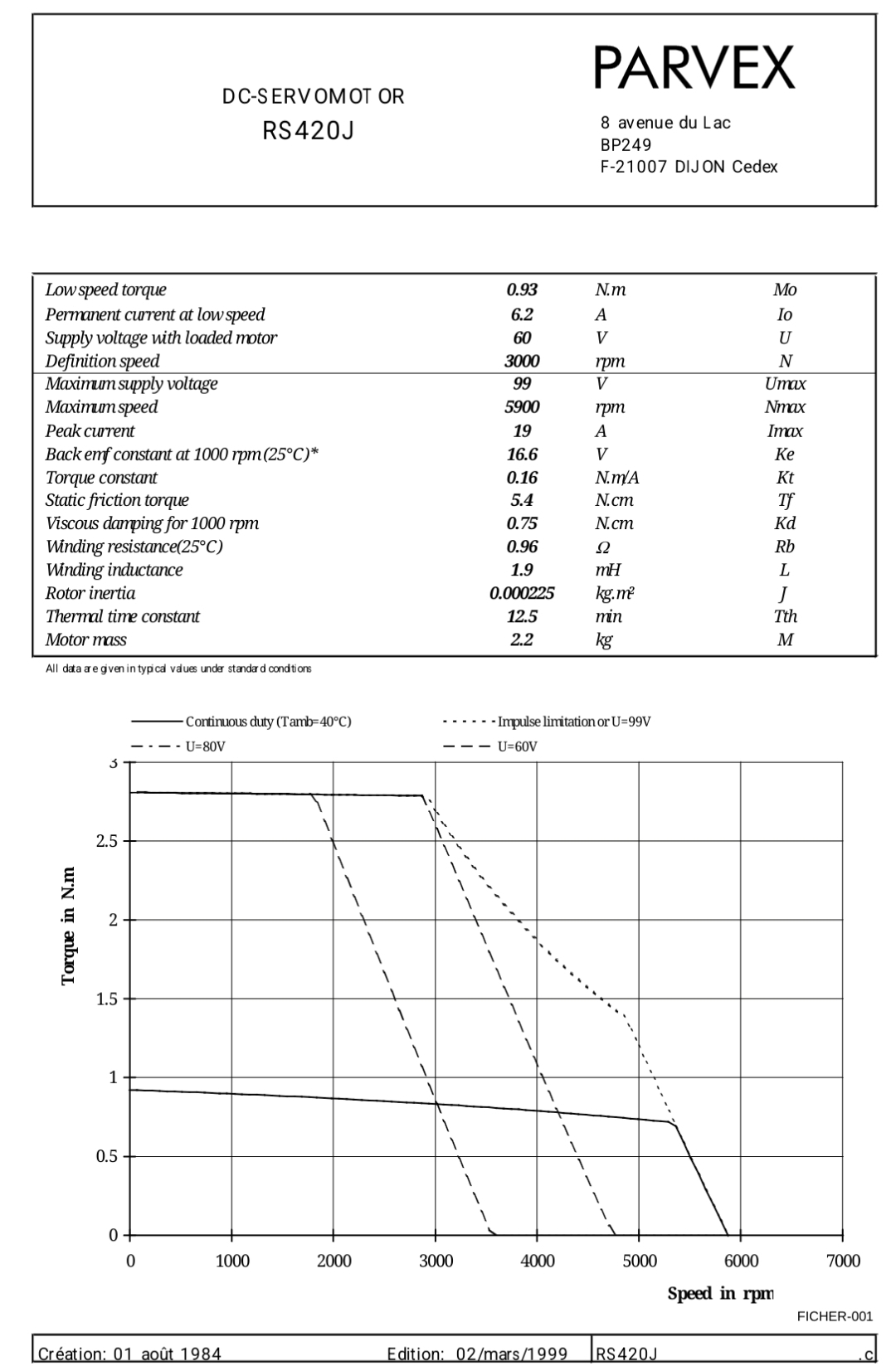

Attached is the spindle torque curve, they claim 0.93 N.m at low speed.
Also uploaded the spec for the standard 190VMC in case others want it.
Apart from rigid tapping are there any other significant benefits with having a spindle encoder? Accurate rpms I guess?
