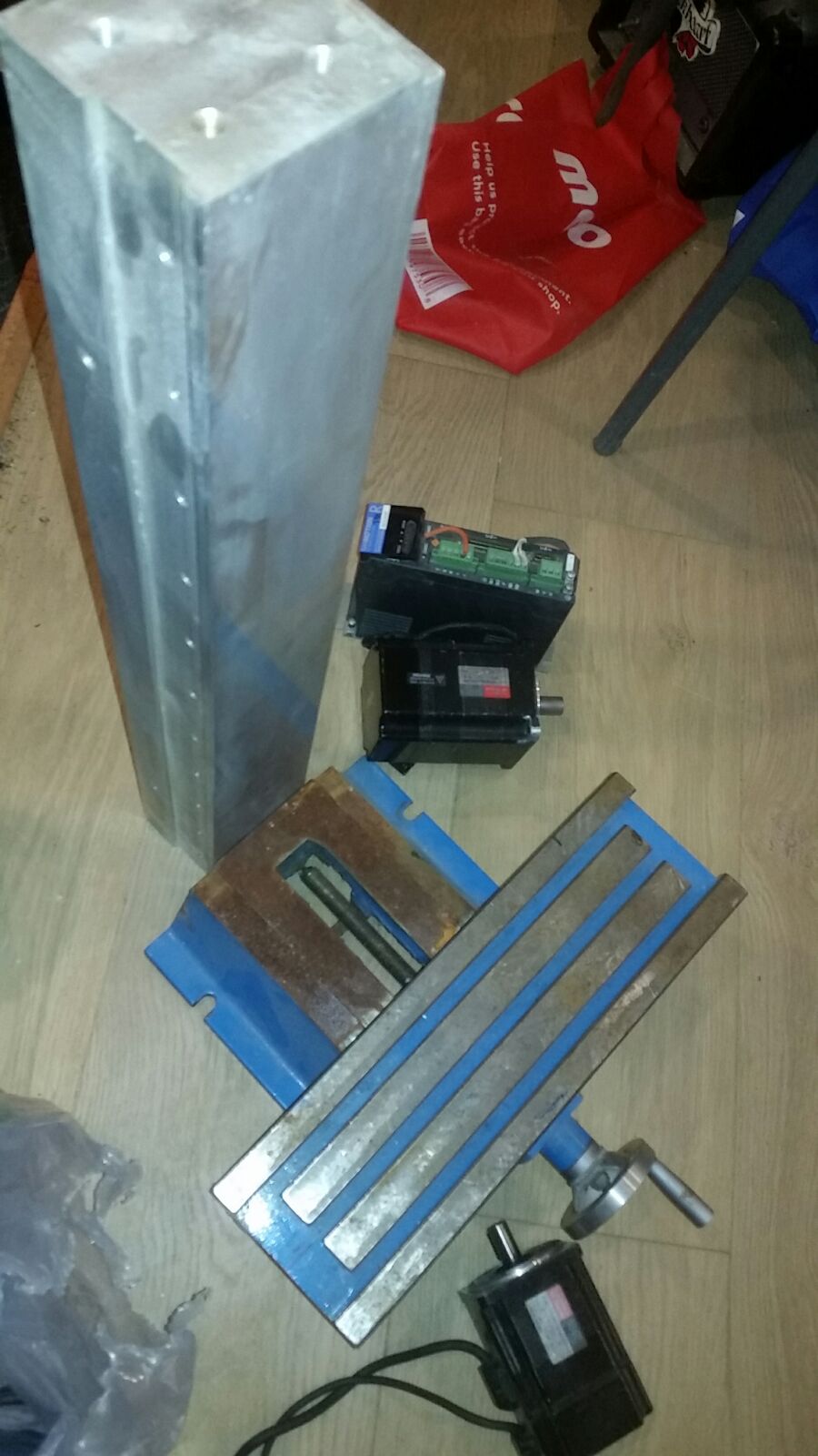

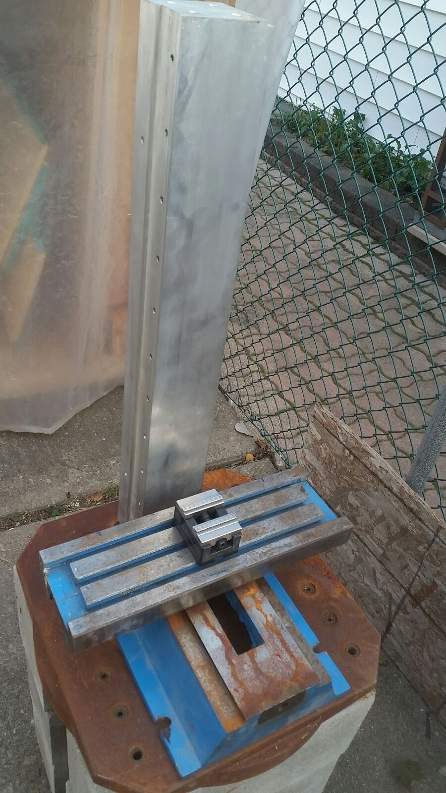

So, I need to clear some stuff out, and came to the realisation I have almost an entire mini mill in parts. So seems to me I should build it.
Got a basic plan together, working out finer details now.
The machine base and table are from a weiss wmd16v. This is the same as an optimum bf20. Table is 375mm a 120mm for scale reference. I stole one of the aluminium frame beams from my predator router to use as a column as the weiss column did not take kindly to a linear rail mod (too thin a casting). The whole thing will bolt securely to an 18x24 granite surface plate.
I need to machine a new Z saddle, and XY saddle from mic6 plate I have handy, some motor mounts for a set of way overkill sanyo servos (these motors are for a brother tapping centre!). These are newish drives and old ish motors with 2000 line encoders. not quite on part with a new delta b3, but should beat anything for the price --- free.
The xy ball screws are 1510 nsk c5 ground. I only have 2, so the Z needs a different screw. all I have is a 20mm thk ground screw which is waaaay too large. my solution is to stick it on the side of the column. the geometry is such that the asymmetry should cause an issue.
Spindle, we have 2 main options. One is to use the weiss iron head, and stick a new spindle shaft into it of a more useful taper. Then belt drive it from one of my brother/sanyo 720w servos. about 8000rpm we would get, and ample torque. The shaft i am looking at is an ebay HSK C32. It is cheap, but the gripper for it is $400. oof. And then i need bearings, another $100 (cheap ones). Then a belt and pulley set. It is a lot of work. Also the tools for hskc are expensive and rare. I also looked into an R8 shaft to use TTS tooling, but I did not find any plausible candidates.
I did look at stock belt spindles, but they are too large mostly and wind up even more money than a good electrospindle. Sooo...
Second spindle option is an 80mm atc spindle. I have a line on a couple options that are suitable for milling (as opposed to the more common light engraving models). This is relatively expensive, but probably the best choice. Tool holders are cheap and plentiful, and it is of course ATC vs simply quick change.

I found a better base. Pallet from a Maho MC5HS. 143lbs of ballast, with a top that is dead flat (once i wipe the rust off.) will be much easier too than drilling holes in granite.
Also, top photography tip from mcdonalds. If you put the worlds smallest 5 axis vise on the machine, it looks misleadingly huge.

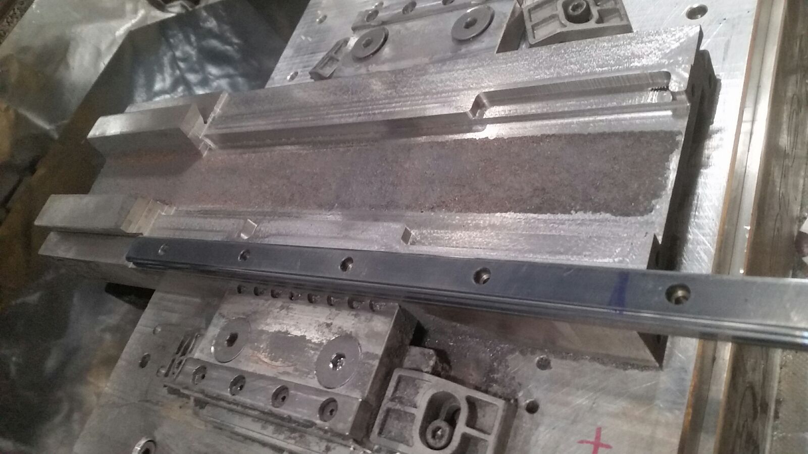

I need to get a windows pc up with serial, and then I should be able to give one of these a test. 400w one from the Y axis.... cause....

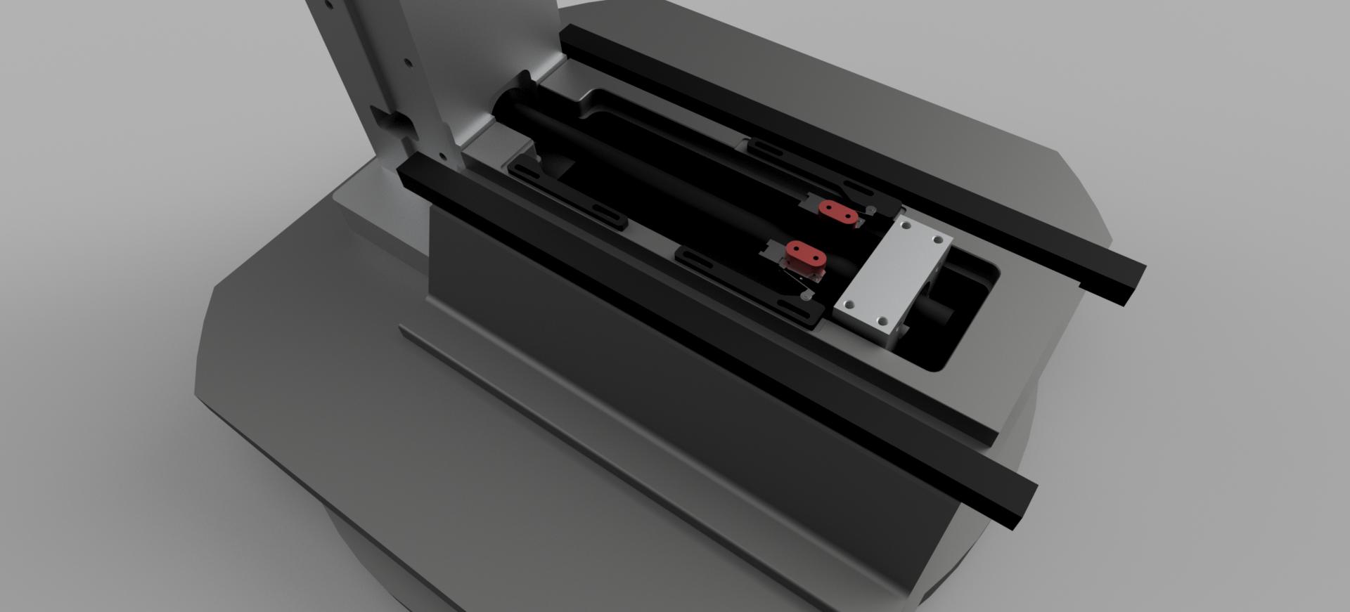

Just about ready to cut the base up. Single op on the mini router. managed to cram adjustable limits in there, 15mm ball screw, 15mm rails. I need to plan the grease hose and limit cable routing.

23 Sep 2023 03:11 #281424
by ihavenofish
Replied by ihavenofish on topic New Machine build from spare parts and a weiss wmd16v (optimum bf16)

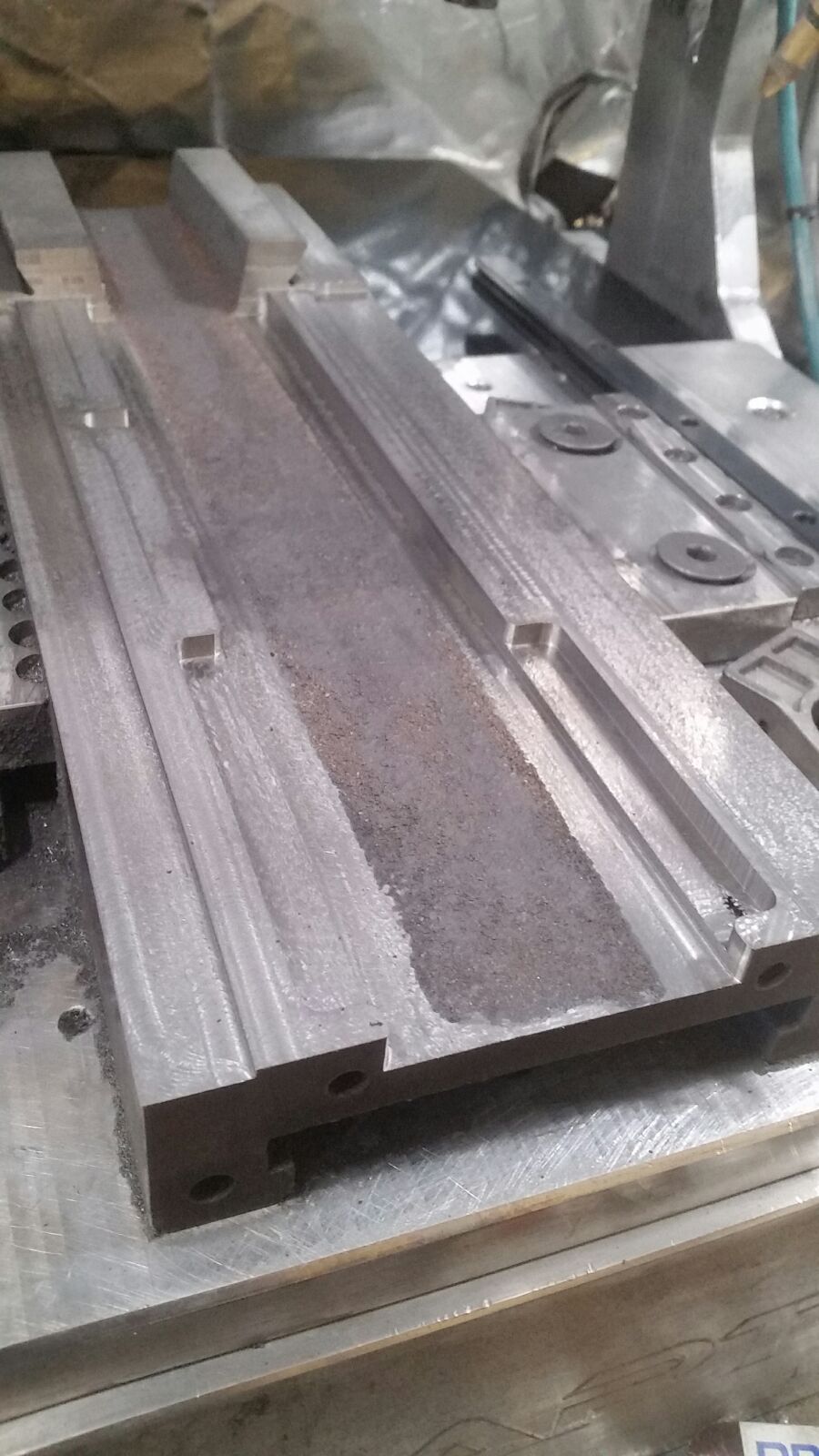

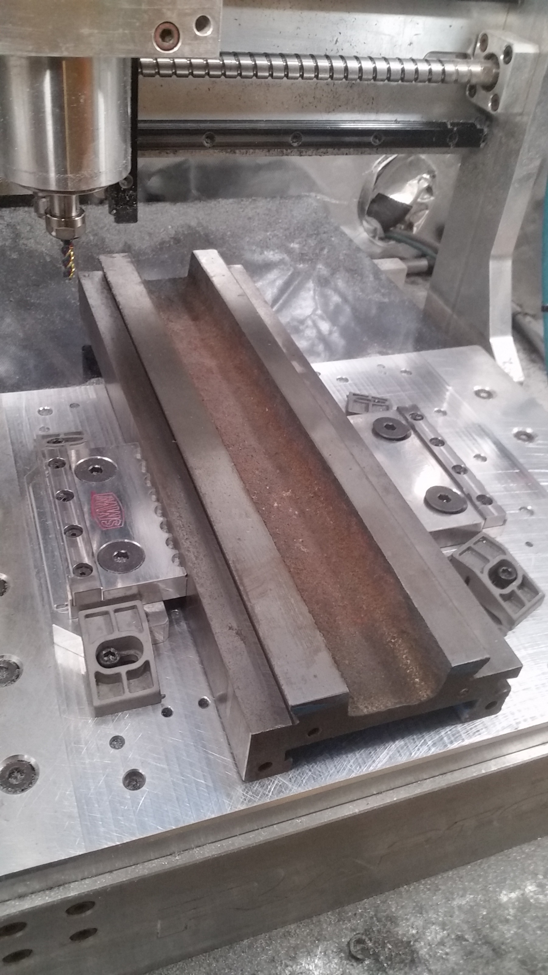

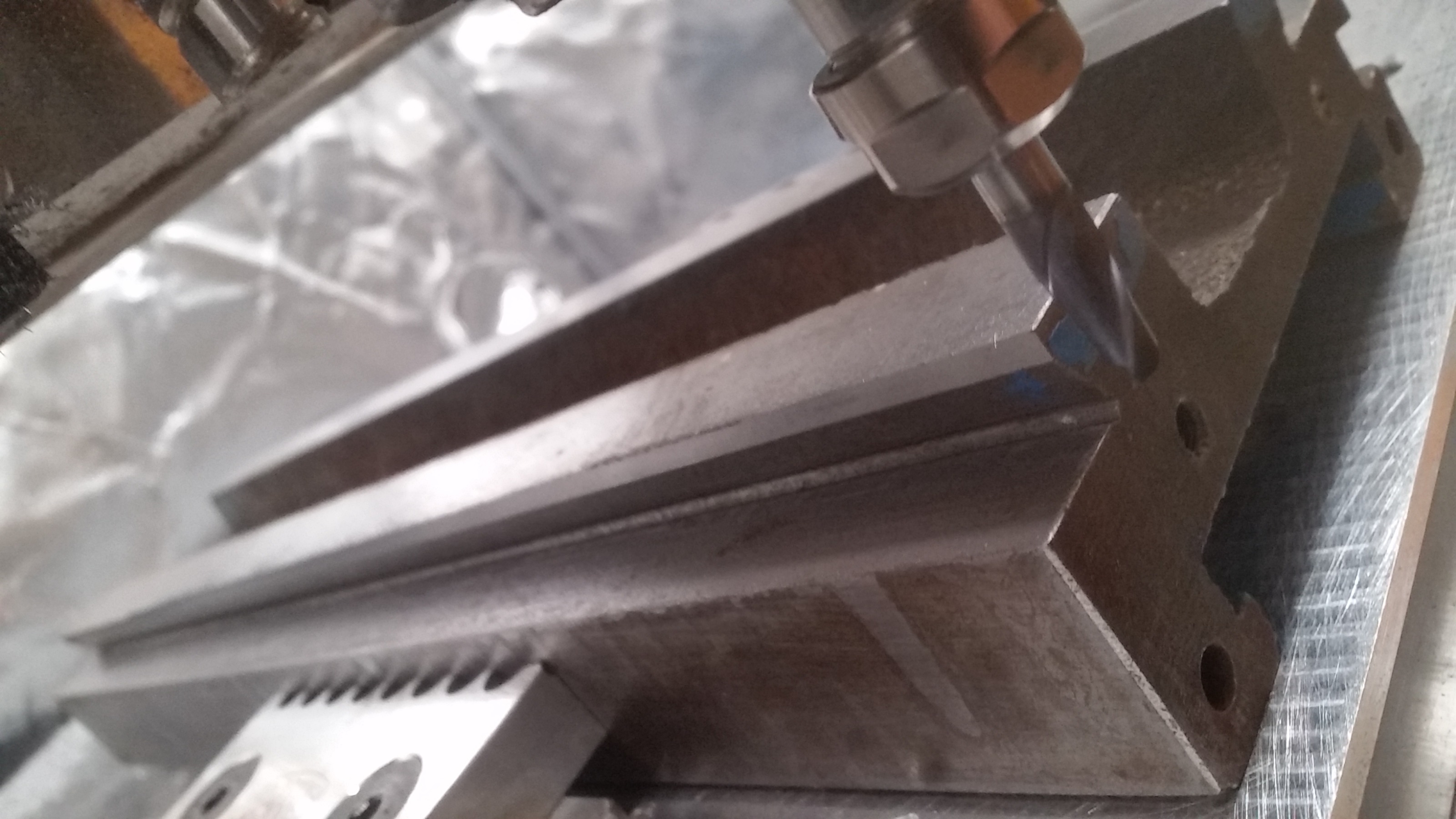

Oh dear. Milling cast iron on a router with a 40000rpm spindle is... actually fine. Go figure
I did dress the router table so it is flat at least to the machine movement. It checks out pretty flat over all - but it is still an aluminium router and not scraped it on meticulously aligned to micron level. I expect at least a little monkeying around on the surface plate post machining.
I set the feeds and speeds ultra conservative, so it will take all day in 2 setups to machine. That ok, we don't want to botch it. It is shockingly expensive to by these parts from grizzly post pandemic.
