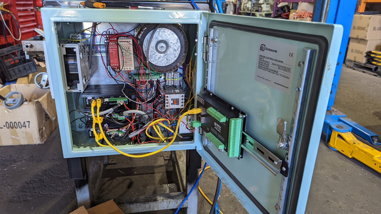

Spumco has good advice.
I would not buy a drive from a random amazon supplier who does not provide documentation.
Looking at the Stepperonline docs www.omc-stepperonline.com/digital-steppe...nema-34-motor-dm860t
I see they can take an AC voltage so they don't even need the Amtek AC-DC rectifier so just a bare AC toroid will suffice. I would use a 60 volt toroid about 12 amps as you say.
Wait, thats exactly what I did on a similar sized mill except I used closed loop ethercat stepper drives.
