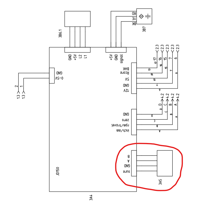

I'm in the process of CNC converting my Optimum MH50V milling machine (
link to build thread
) and as a part of that process I'd like to upgrade the encoder on the machine so that I can do rigid tapping later on.
The encoder that came with the machine looks like this:
The manual for the machine doesn't say much about the encoder itself, here is a snippet from the schematics:
Given that this encoder most likely doesn't have and index signal I realize it will have to replaced. Does anyone here on the forum have any hints on what could be a suitable upgrade option given the physical layout of the machine?

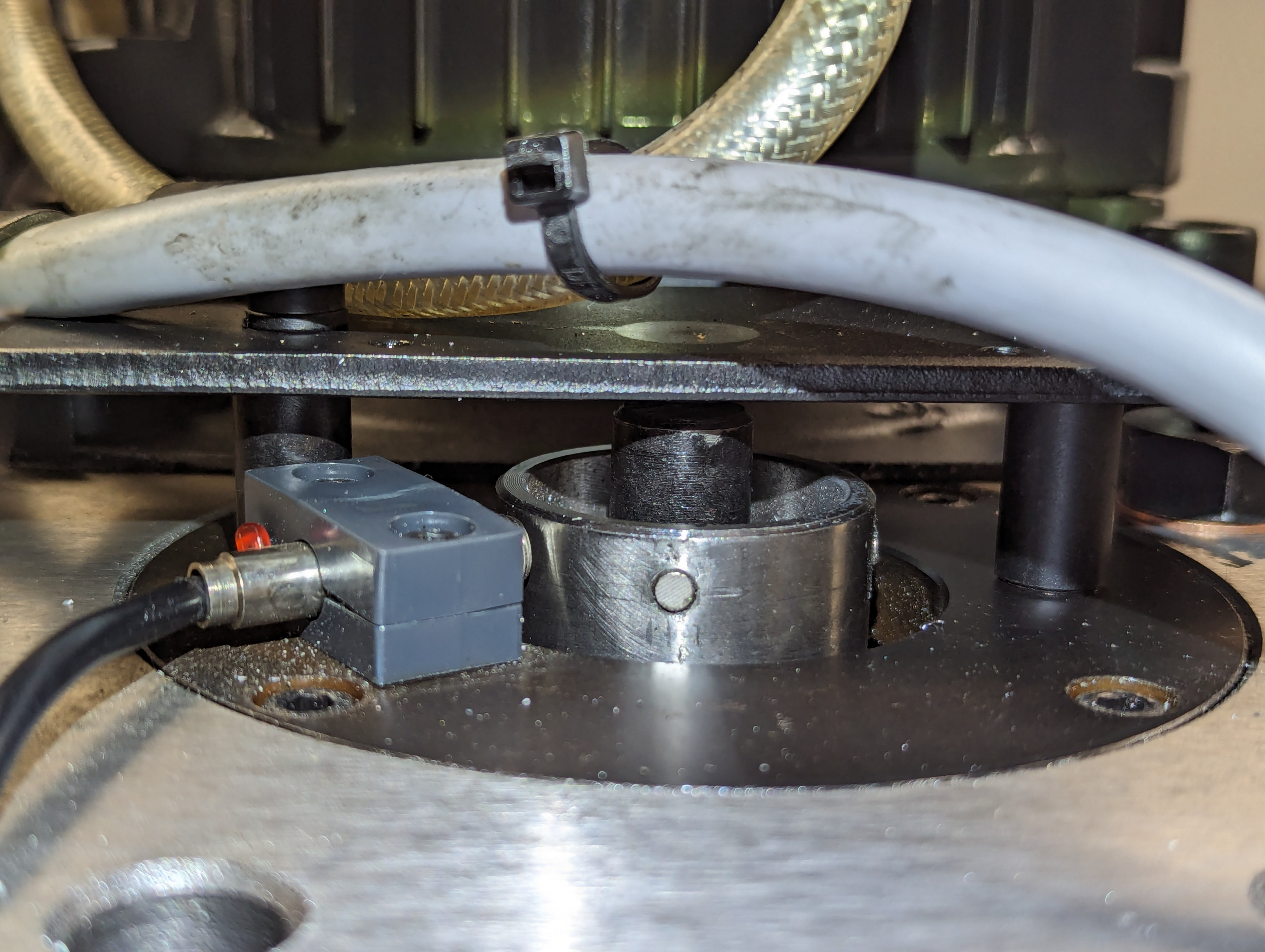

The shaft for the spindle has an OD of 40 mm and the maximum OD which can fit before hitting the supports on the side is 68 mm. Pressing on some kind of gear here shouldn't be much of a problem if that's a suitable way to go.

An incremental rotary encoder with A/B/Z (TTL signals) will be sufficient for sync motions e.g threads and speed/velocity. Assuming you have a vacant input pin for the index signal secured already, it's then just a matter of ensuring that the input VCC of the new encoder is within range of your system output voltage. Apart from the physical mounting aspect.
Another selection factor to consider is the PPR (pulses per revolution). The higher ppr = better sync motion accuracy. However from the schematic you posted it's hard to tell if there are any hardware constraints. Signal input optocoupler max freq/speed (if any mind you) to name one. If there aren't any detailed schematics avail, a hd pic of the board could help with that part.
Curious. What is the S.U.R.E. input (output?) for?

What is the OD of the encoder magnet carrier you attached in the first post? Asking because it might be possible to bore out a narrow timing pulley and sneak it on that magnet mount thing and run a belt to a small shaft encoder.
I did this on my lathe spindle and it's working well. Bored a GT2 9mm wide pulley out and shrink-fit it on the spindle - there wasn't enough thickness left for a set screw or keyless bushing. Matching pulley on the encoder and everything's all set.

The OD of the magnet carrier is 40 mm so your approach might actually be the simplest way to go. I'm currently looking a HTD 3M belt and pulleys which seem to be pretty slim.
