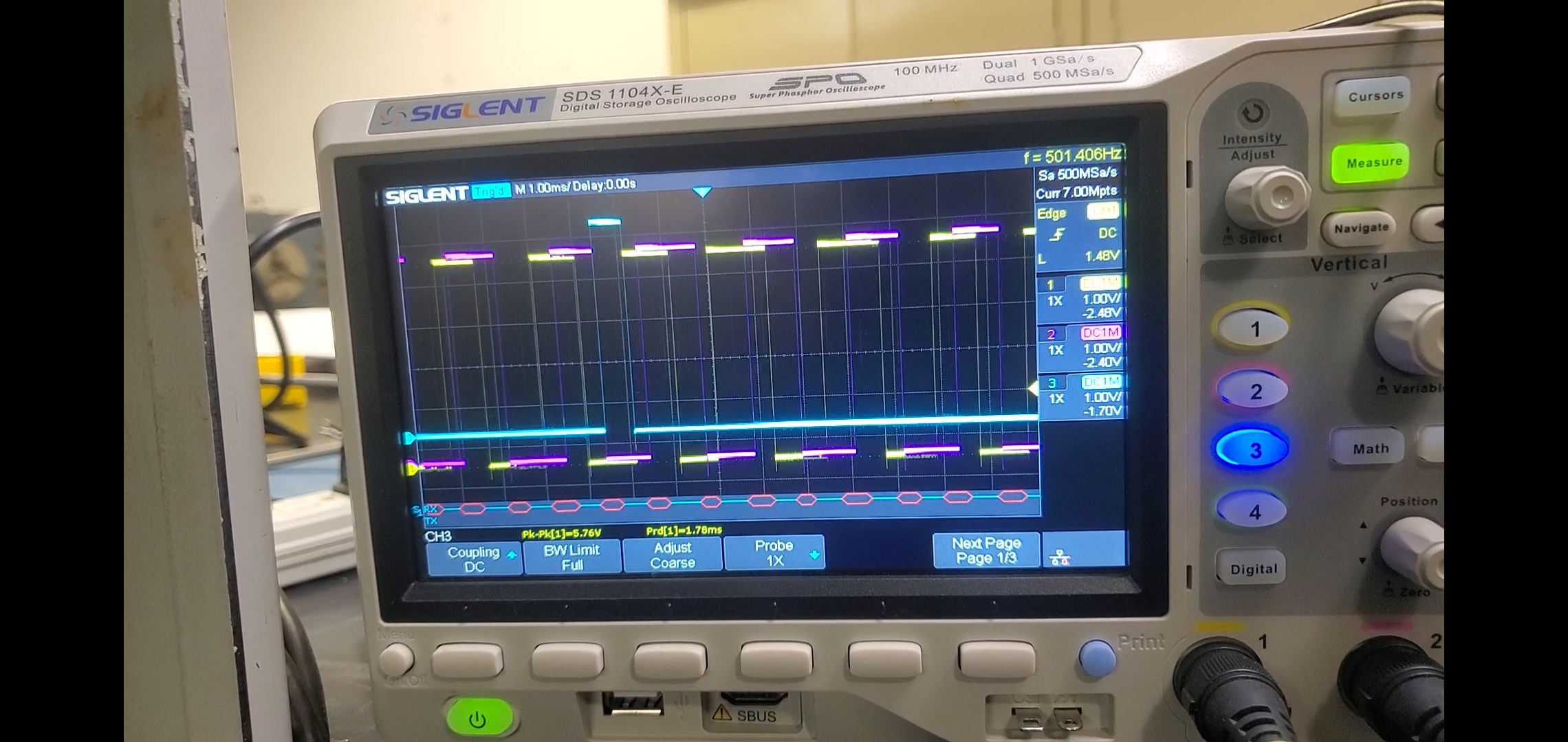

Hmm looking at the photos I posted on the forum just now and the encoder has 0500 at the end of the part number. Maybe thats the resolution. Quick google search lists only old parts at high prices!
- Posts: 22049
- Thank you received: 7509
21 Jun 2024 17:33 #303520
Replied by tommylight on topic Tree Kira VTC30 Retrofit
Here i go again bursting bubbles ...
If it is an incremental encoder, and by the pictures it sure looks like it is, then the outputs should be square wave, and at least 3.5V peak to peak with no load, usually 4.2-4.5V.
Looking at the scope, having 540mV or 0.54V is no good, having a triangle to near sine wave signal is even less good.
Question, are you sure the scope probe is set at 1X, not 10X ?

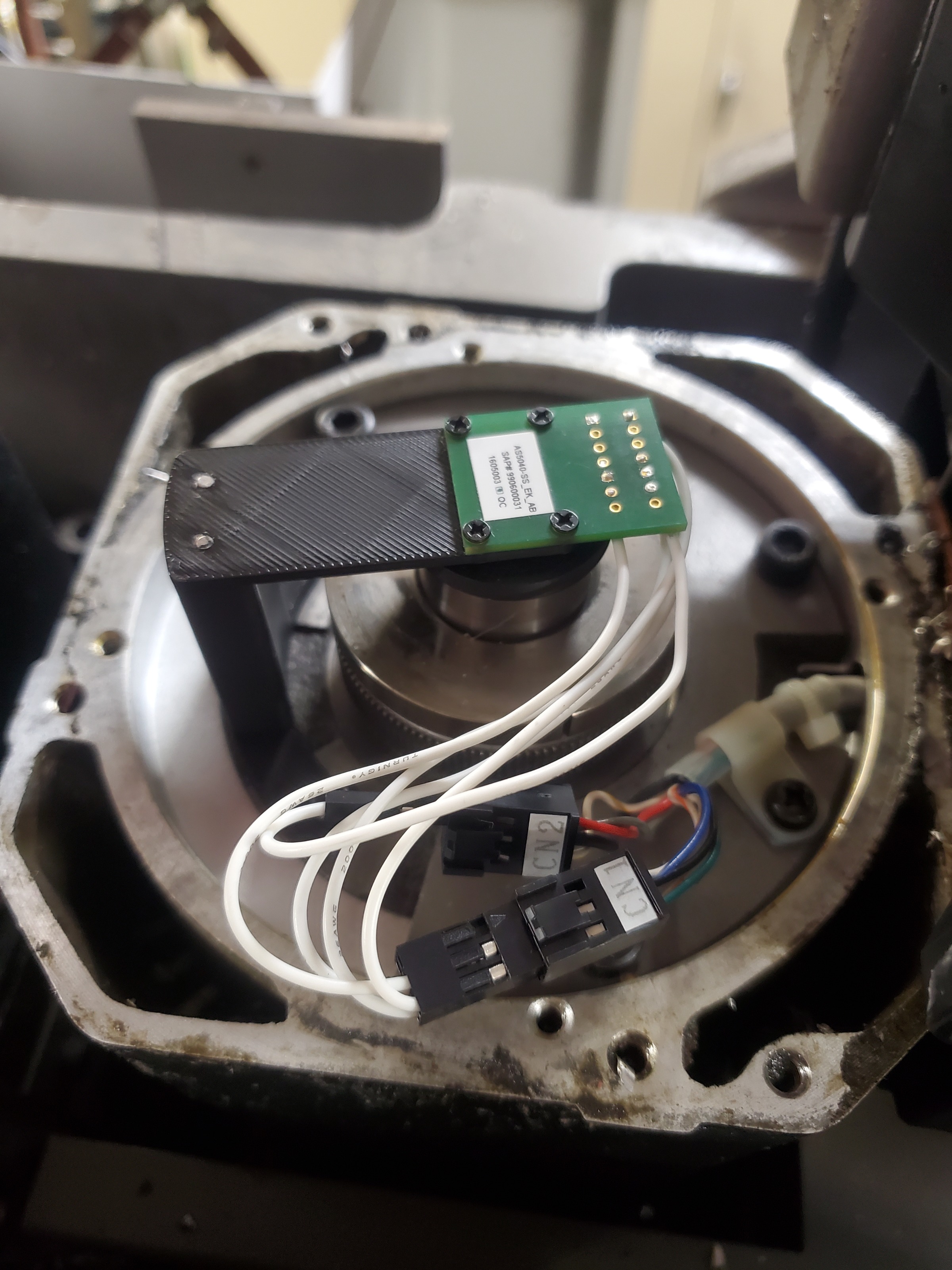

After some deliberation I decided to replace the encoder and try one of these cheap hall effect chips (AS5040). I chose this one because its 10 bit resolution matches the max I read in the WJ200 manual.

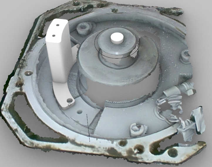

I 3d scanned the top of the servo drive to get the locations for things. (loving this Einstar scanner)

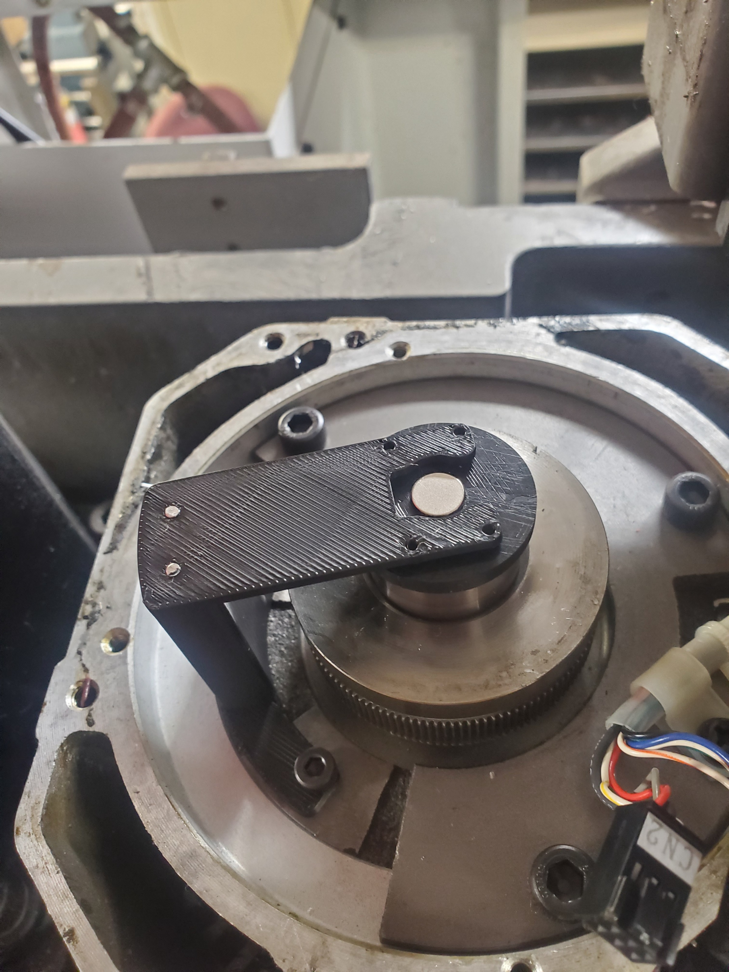

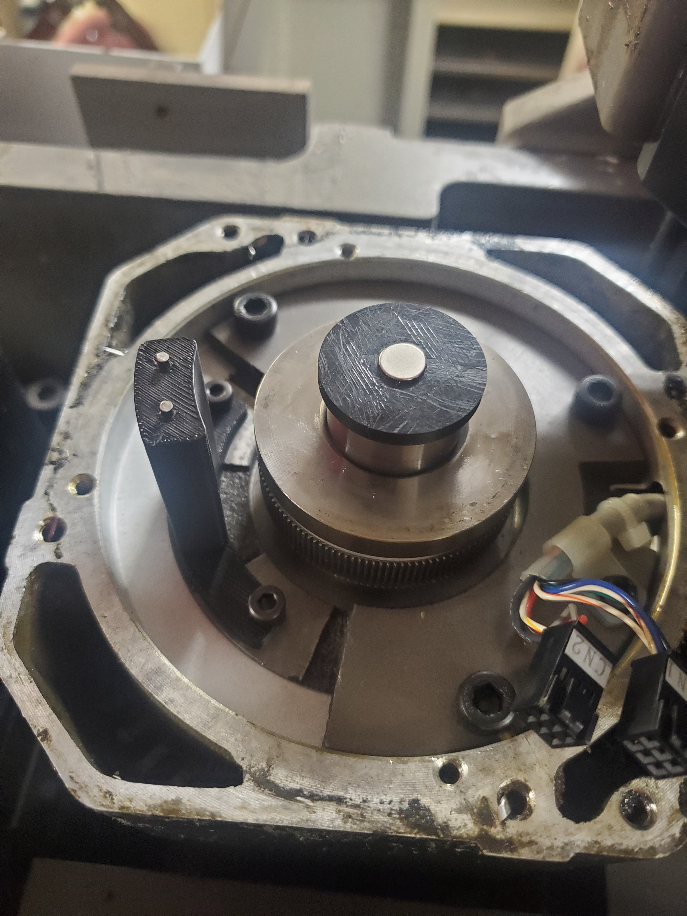

The scan wasnt perfect so I iterated the top diving board twice to dial it in.
Then I soldered up some wires and fed them to the fanuc wiring already in place.
Now I have a good 5v square waveform on A B and Z.
I will likely replace the 3d printed parts with metal parts once the machine is up and running. I wouldn't want to have problems because the servo gets warm down the road.
