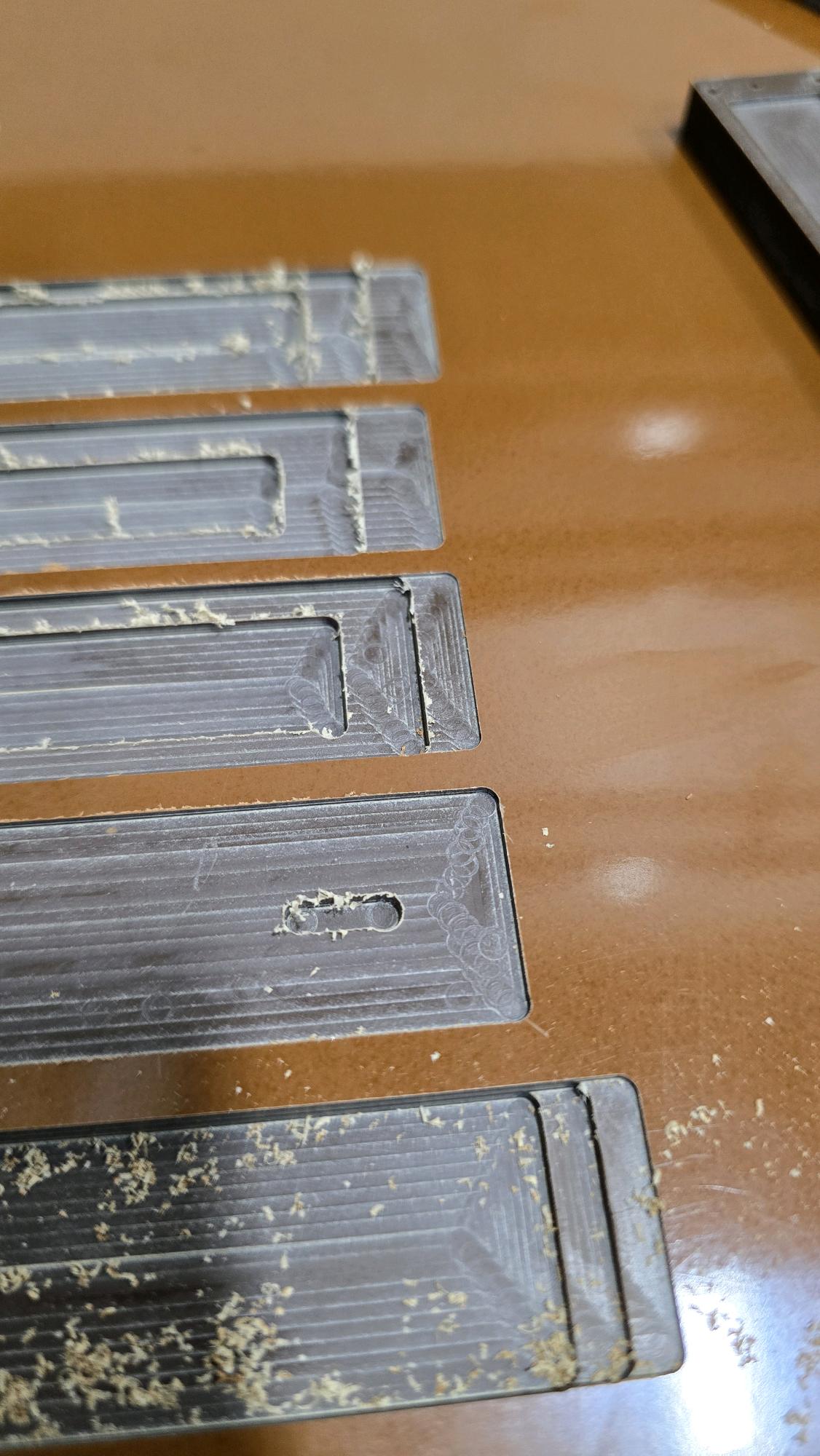

16 Jul 2024 22:17 #305426
by sandersjrs
Replied by sandersjrs on topic Dimensions Slightly Off
Here is an example of what I am experiencing
. Each run is a different pocket run with the steppers at different microstepping values. Each time the bit goes down to start pocketing a new layer, the edge of the X axis of each is off from where it was from the layer above. What's weird is that each layer is lined up with itself in the X axis.
I'm not getting latency problems. I did input random high values (I think 20000 ns for each field) for the driver setup page because there is literally no information online about that (yes, I did contact the manufacturer - Troy).
I'm about ready to throw in the towel and buy new stepper drivers, but the things is, the drivers worked just fine not one week ago with the old controller.

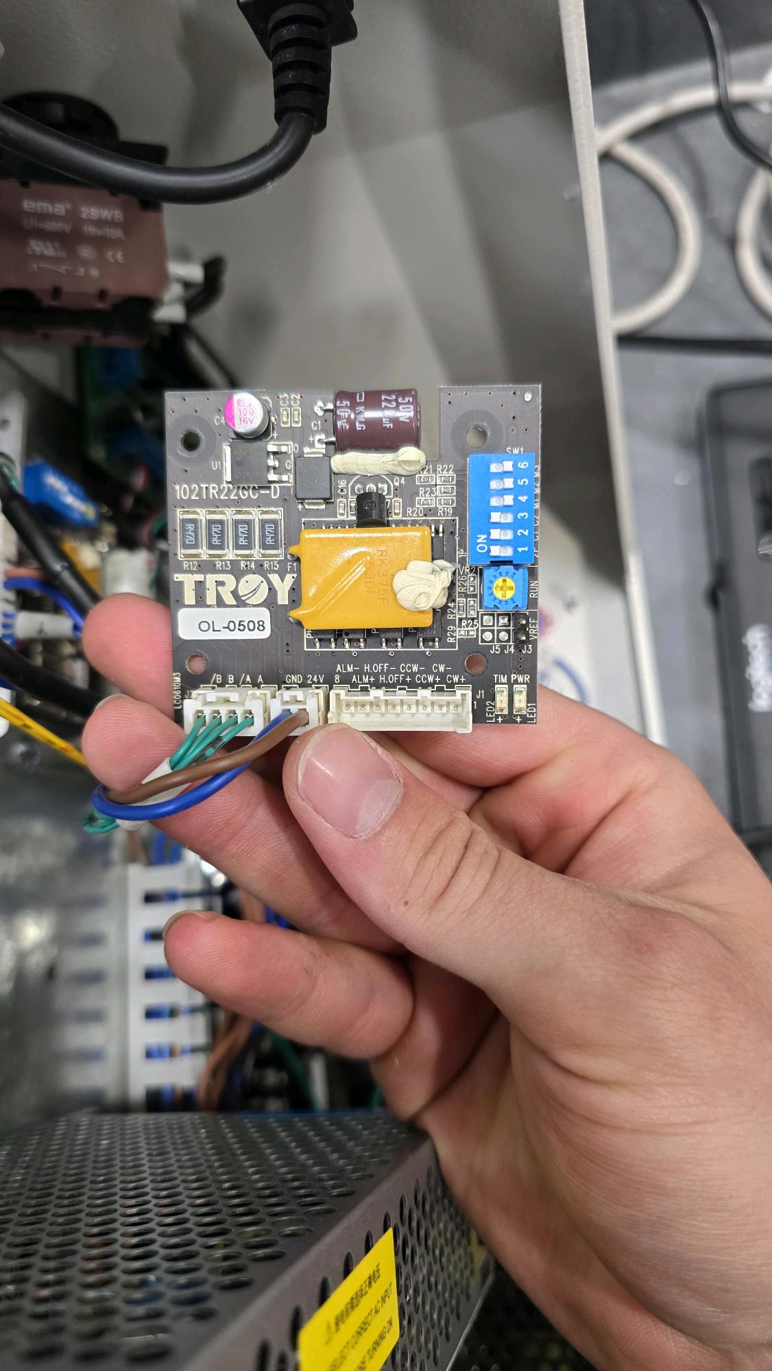

What drivers are being used ?

- sandersjrs
- Posts: 16
16 Jul 2024 22:58 - 16 Jul 2024 23:02 #305430
by sandersjrs
Sorry about the .hal and .ini. Try these:
Drivers being used are old Troy (chinese) drivers (that worked fine with the old RichAuto controller):
User manual here (drive file because it's too large for forum limits): drive.google.com/file/d/1BSWBPFRsO2LLnaD...kK4/view?usp=sharing
I did switch the X and Y axis steppers and the issue still happened on the same axis.
