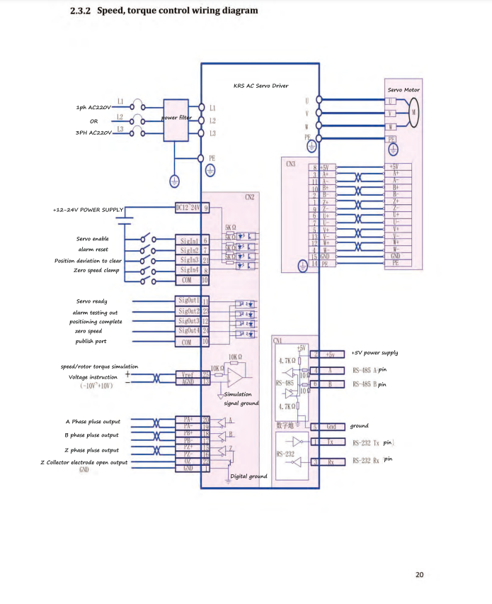

30 Aug 2024 20:00 #309061
by PhilipME
Replied by PhilipME on topic servo motor for a spindle
here is the wiring for speed mode

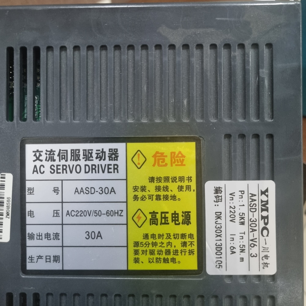

30 Aug 2024 21:12 #309066
by COFHAL
Replied by COFHAL on topic servo motor for a spindle
What is the model of your servo driver?
- PhilipME
- Posts: 176
- Thank you received: 14
30 Aug 2024 23:33 - 30 Aug 2024 23:43 #309072
by PhilipME
Last edit: 30 Aug 2024 23:43 by PhilipME.
