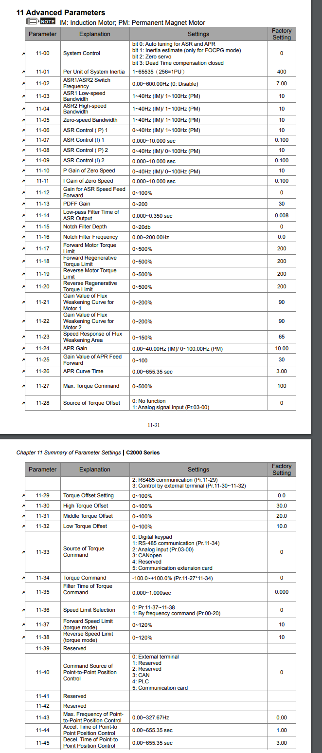

drive  have 3 control loop
the first is current loop can auto tuning with motor parameter
second is speed loop and third is position loop if need
delta C2000 look like have speed loop auto tuning, but maybe need mod by manual

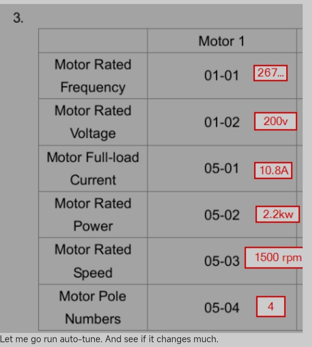

I think there is a mistake here.  Rated Frequency should be for 1500rpm
ps. Parameter 01-00 specifies the maximum motor frequency

motor rate fequency is 50hz
