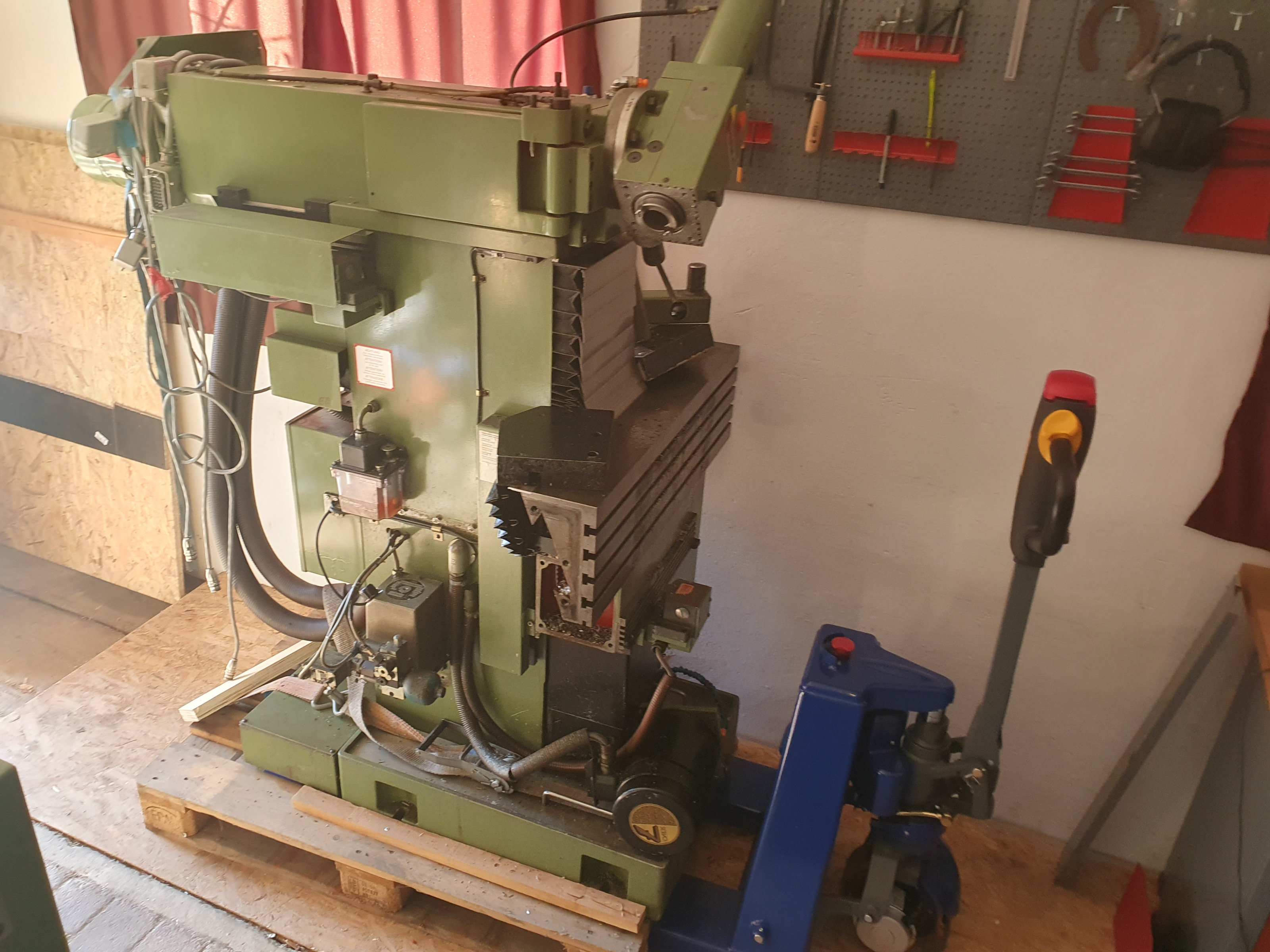

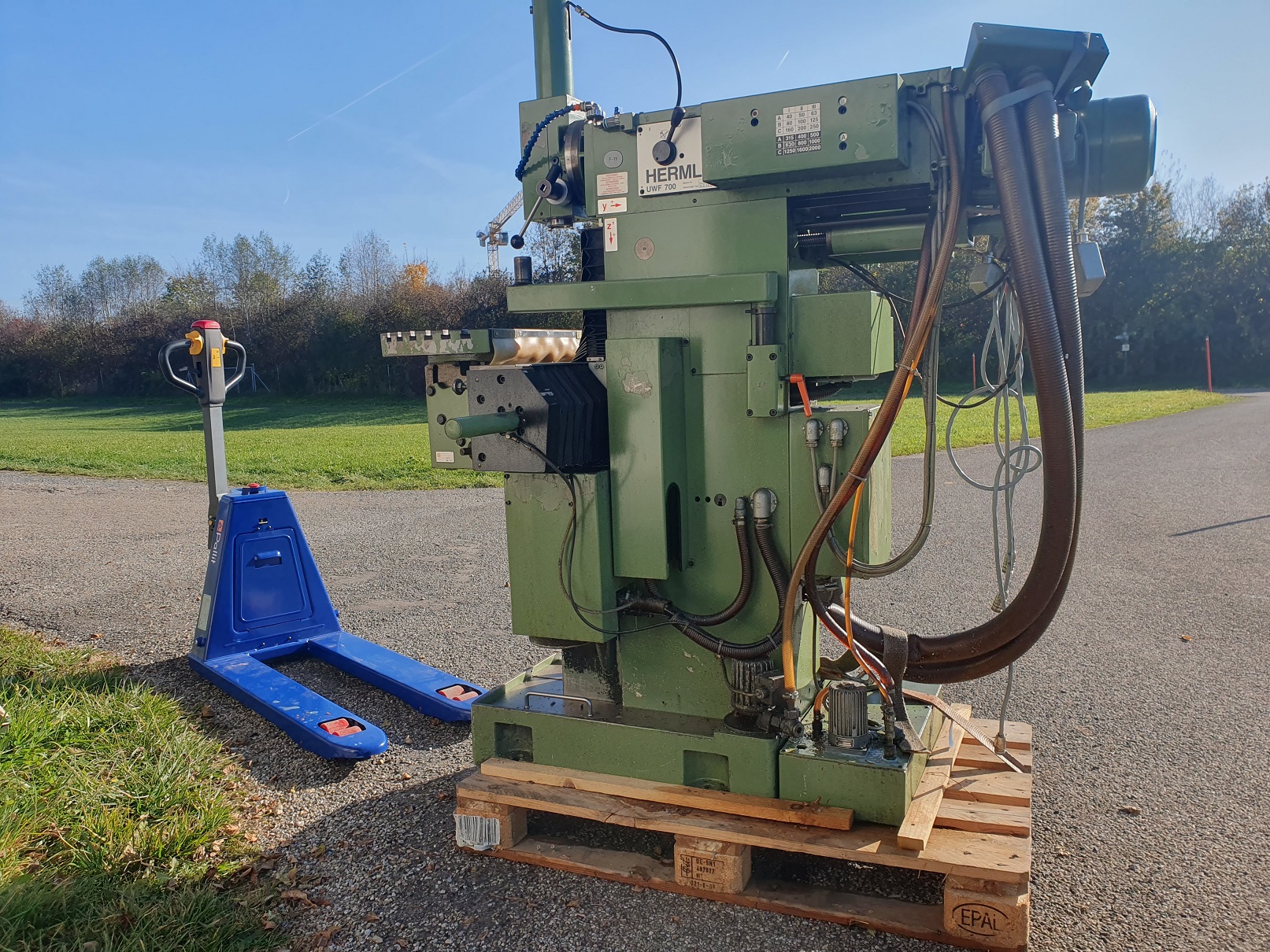

I started a new project, a retrofit of a Hermle UWF 700. It was made in 1984, 40 years ago. The mechanical condition is very good, no signs of wear anywhere, although that might also be due to the automatic lubricator. The mill has a 18-speed gearbox, maxing out at 2000rpm's. The electronics were not working anymore, so I only got the machine itself. I did get a lot of nice documentation however. Tool clamping works by a hydraulic cylinder. The gears are lubricated with an oil spray system with a seperate oil pump.This is what the Hermle looks like:
And inside my small shed:

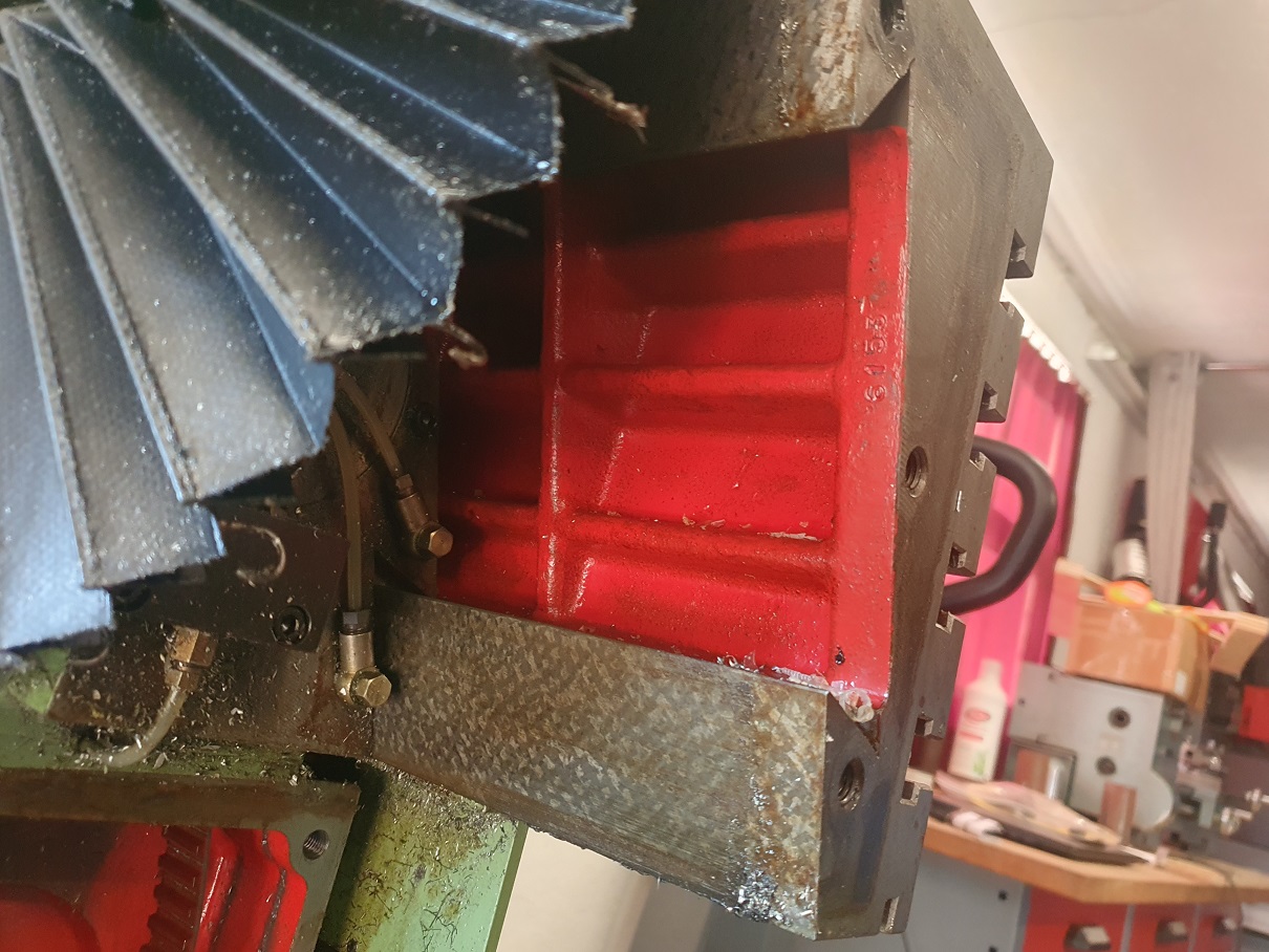

The ways still look pretty good:
