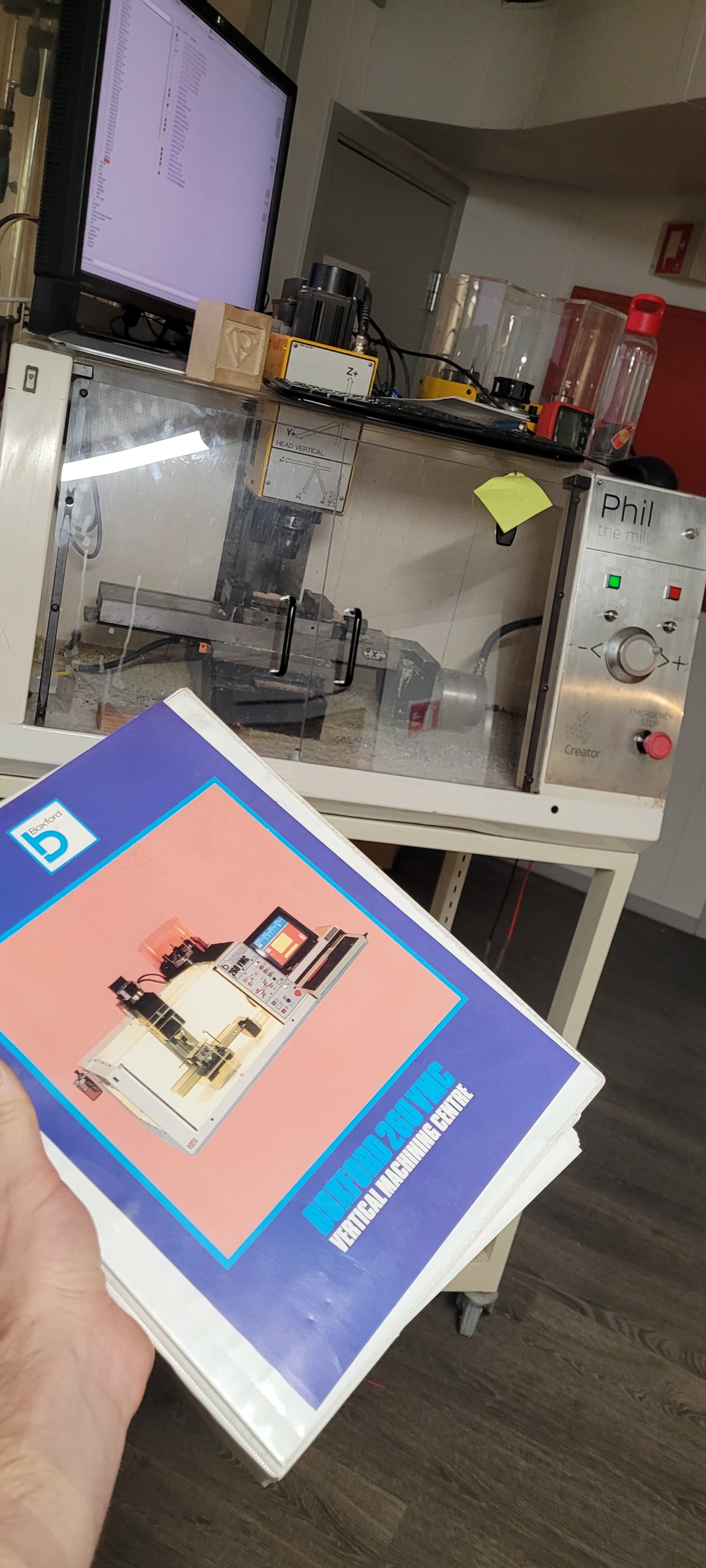

by Rune_cnc
Boxford 260 CMC 1989 mod was created by Rune_cnc

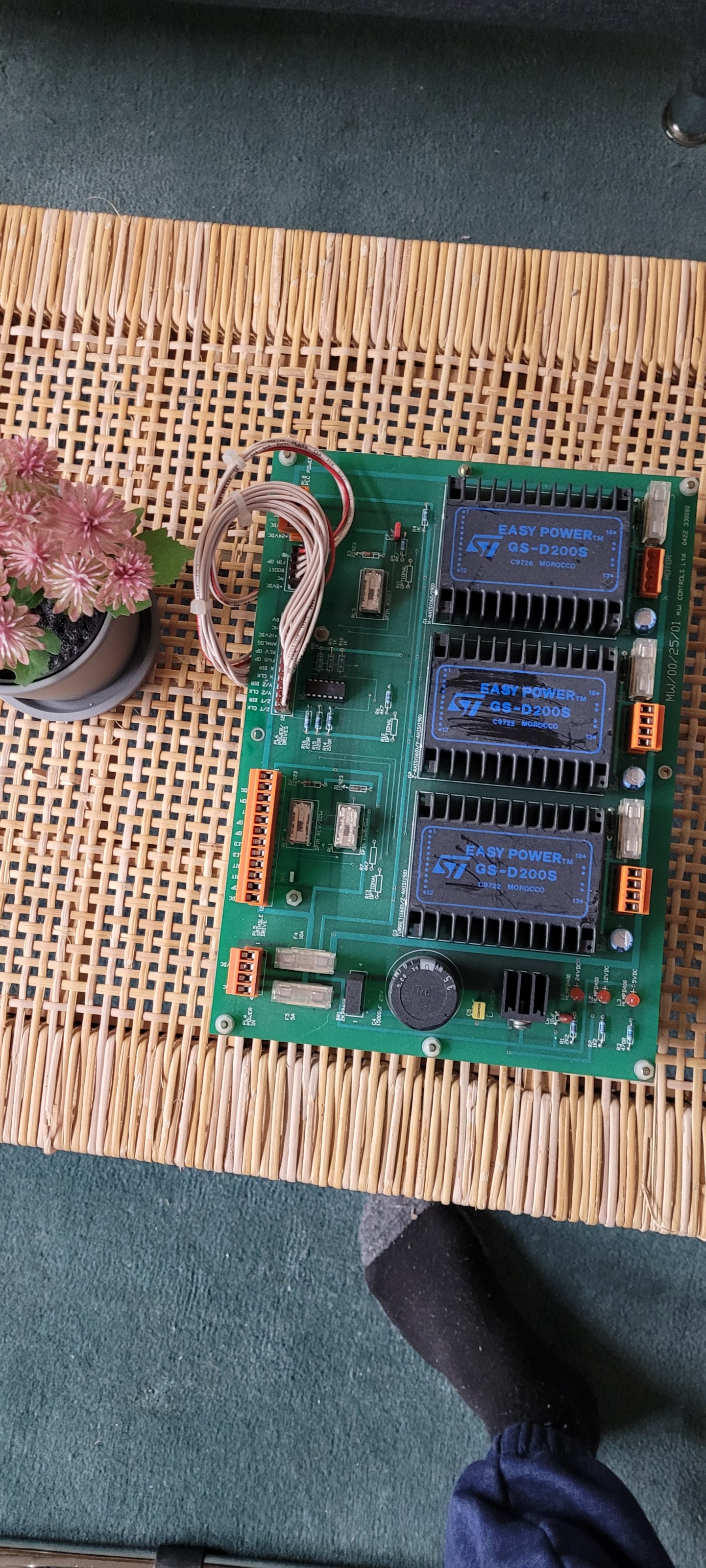

27 Dec 2024 00:03 #317445
Replied by tommylight on topic Boxford 260 CMC 1989 mod
Seems easy enough, the board has all the pins written on it, so wire a power supply, get an old PC with parallel port and install LinuxCNC from the downloads page, wire the Xclk and Xdir and the rest of Y and Z, test.

by Rune_cnc
Replied by Rune_cnc on topic Boxford 260 CMC 1989 mod
Yeah just showing off the machine.Im putting mesa card as replacement. Do you know if there is a retro look user interface. For the linuxcnc.

27 Dec 2024 14:32 #317476
There are a lot of GUI's included with LinuxCNC, you can find them by starting it from the main menu in the config picker, most are under SIM folder and all those run without any hardware so you can run and test them as much as you like.

28 Dec 2024 00:02 #317521
Replied by andypugh on topic Boxford 260 CMC 1989 mod
It's called "Phil" to rhyme with "Mill".
Maybe they also had a Dave the Lathe?
Where did you get it from? This has a vague feeling of hackspace humour.

05 Jan 2025 23:15 #318179
by Rune_cnc
Yea phil rime i get it.
And we do have the mini lathe too.
Been at a school in norway.
Sitting still for 6 years.
Got it working again.
But need to add safety stuff like e stop limit sensor ect
