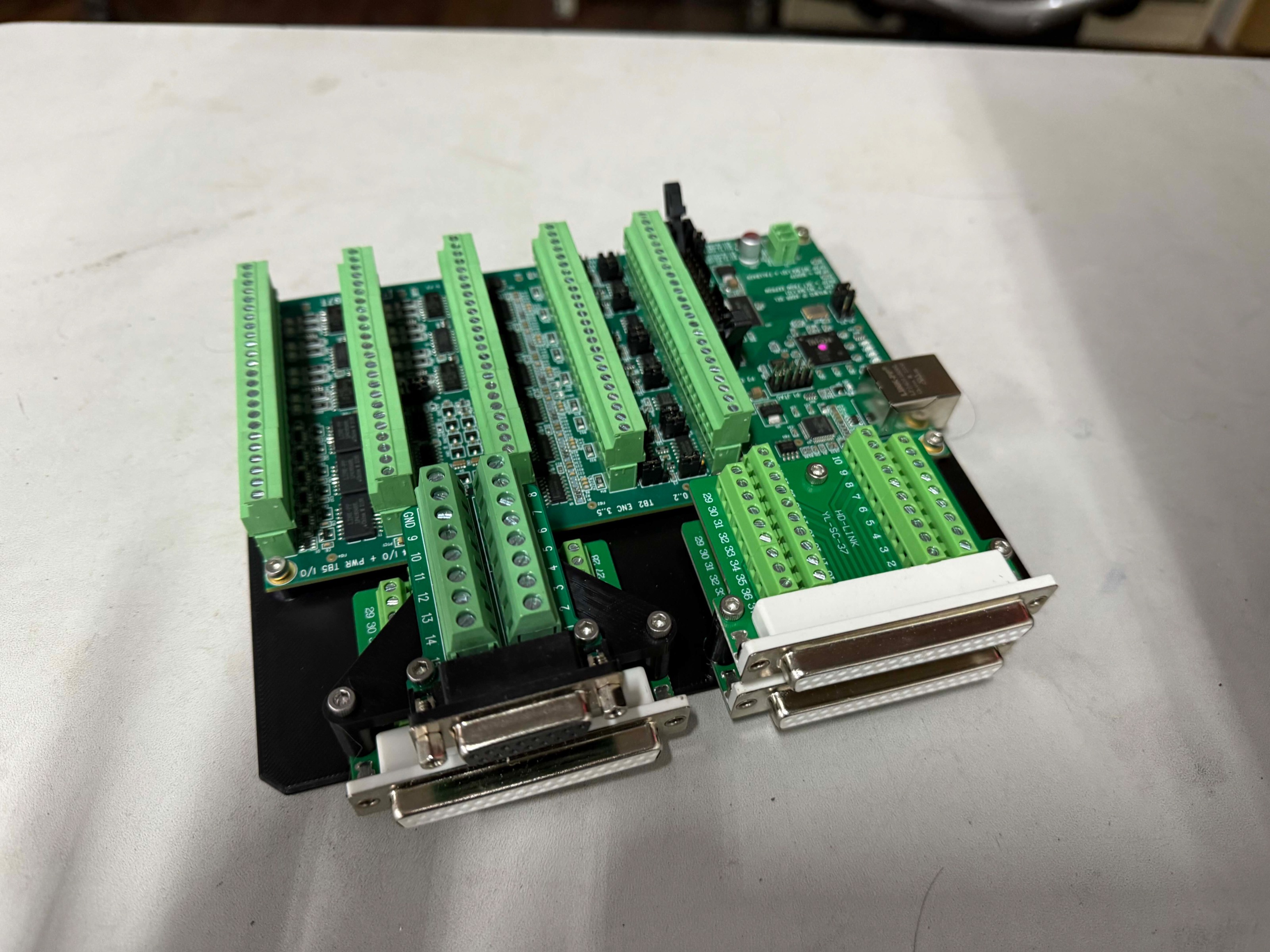

My local makerspace has a pair of donated Journeyman 325s. I am retrofitting one with LinuxCNC. We have a small form factor PC that should work with a 7I97T I purchased a while back.
My plan is to leave the wiring alone as much as possible. Using 3 DB37 breakouts and a DB15 breakout. Later I will use more of the existing wiring to wire front panel switches.

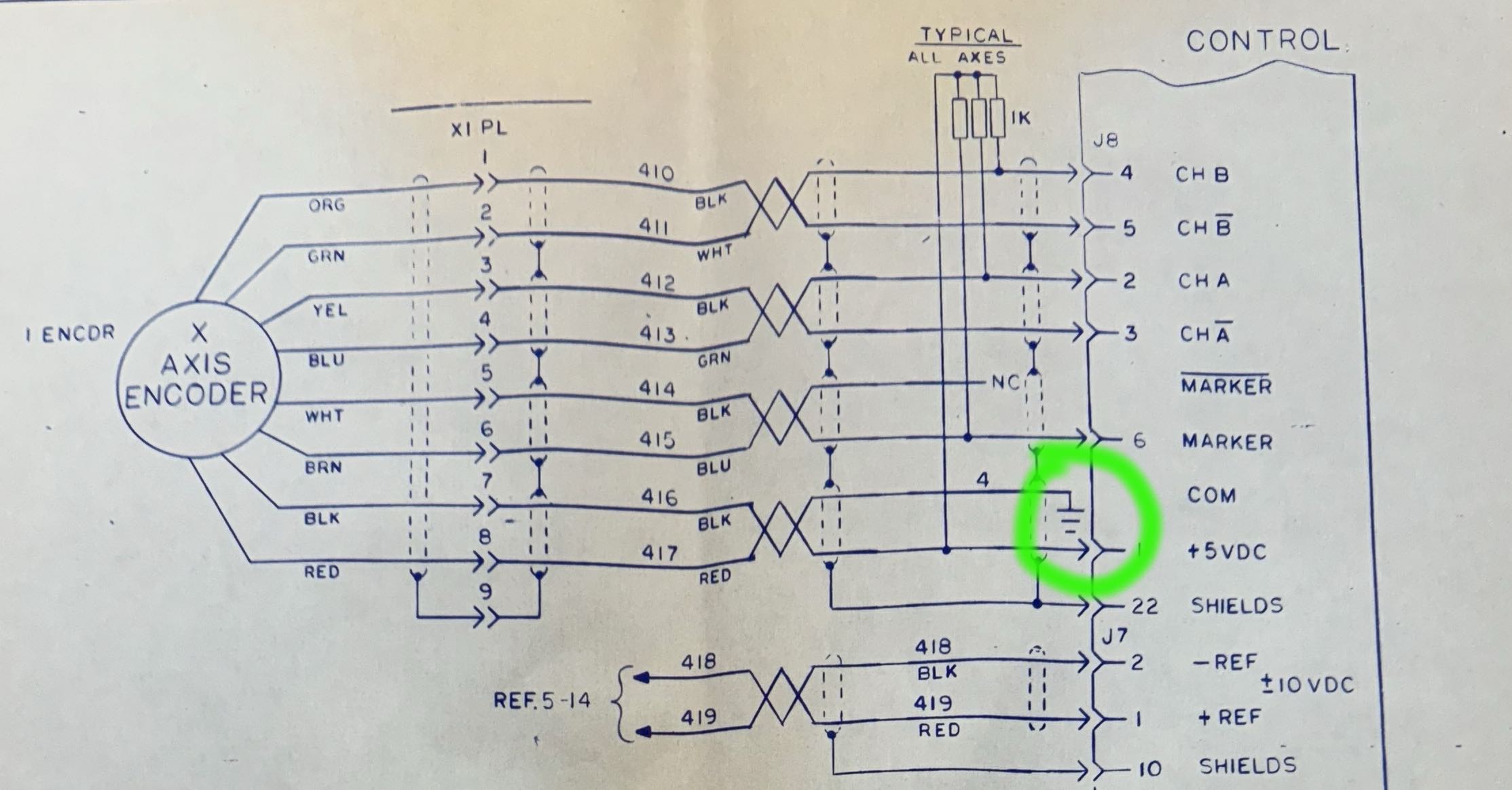

So this is pretty weird. Most of the encoder wiring is pretty straightforward but the 5VDC common is not wired. See attached schematic. I looked at the plug that is associated with the x-axis servo and sure enough there was no pin. I checked at the terminal block and found that the 5VDC common was wired to case ground. The same is true of the servo tachometers so that was the manufacturer's original intention. Kinda leery of wiring my MESA card's 5vdc PS to case ground.
