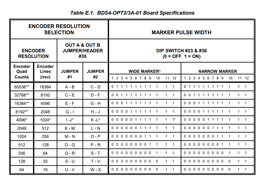

Hi all,
I tried one axis first to be safe.
If encoders are disabled in HAL file, I can move the y-axis freely. no shaking. everything is smooth.
But if encoders are enabled, I have varying results.
a lower scale (819.2) - joint 1 following error
a higher scale (4096) - no error but shaking occurs
May PID settings are
P - 50
I - 0
D - 0
Ballscrews are around 10mm
Regards,
Kibin
P - 50
I - 0
D - 0
Regards,
Kibin

Hi All,
Good day. Managed to wire the ENA to the servo drive enable.
My current problem is overshoot. It is overshooting. lets say I command it y5, it will go until y6 then go back to y5. Overshoot increases as feed speed increases. I estimate it to be 1mm per 100mmpm. so 100mmpm has an overshoot of 1mm, 300mmpm has an overshoot of 3mm.
PID settings are
P = 1.5 (If i add more, it shakes at higher speed)
I = 0
D = 0 (any increase and the system shakes)
Scale : 1225 (0.01 accuracy even with overshoots)
PID settings are
I = 0

Hi all,
After countless revisions. managed to make it work.
PID settings are
P = 1
I = 0
D = 0
FF0 = 0
FF1 = 0
FF2 = 0
Scale : 1225
It was staring at my face the whole time. On a whim i just decided to 0 everything, and it worked!
Regards,
Kibin
