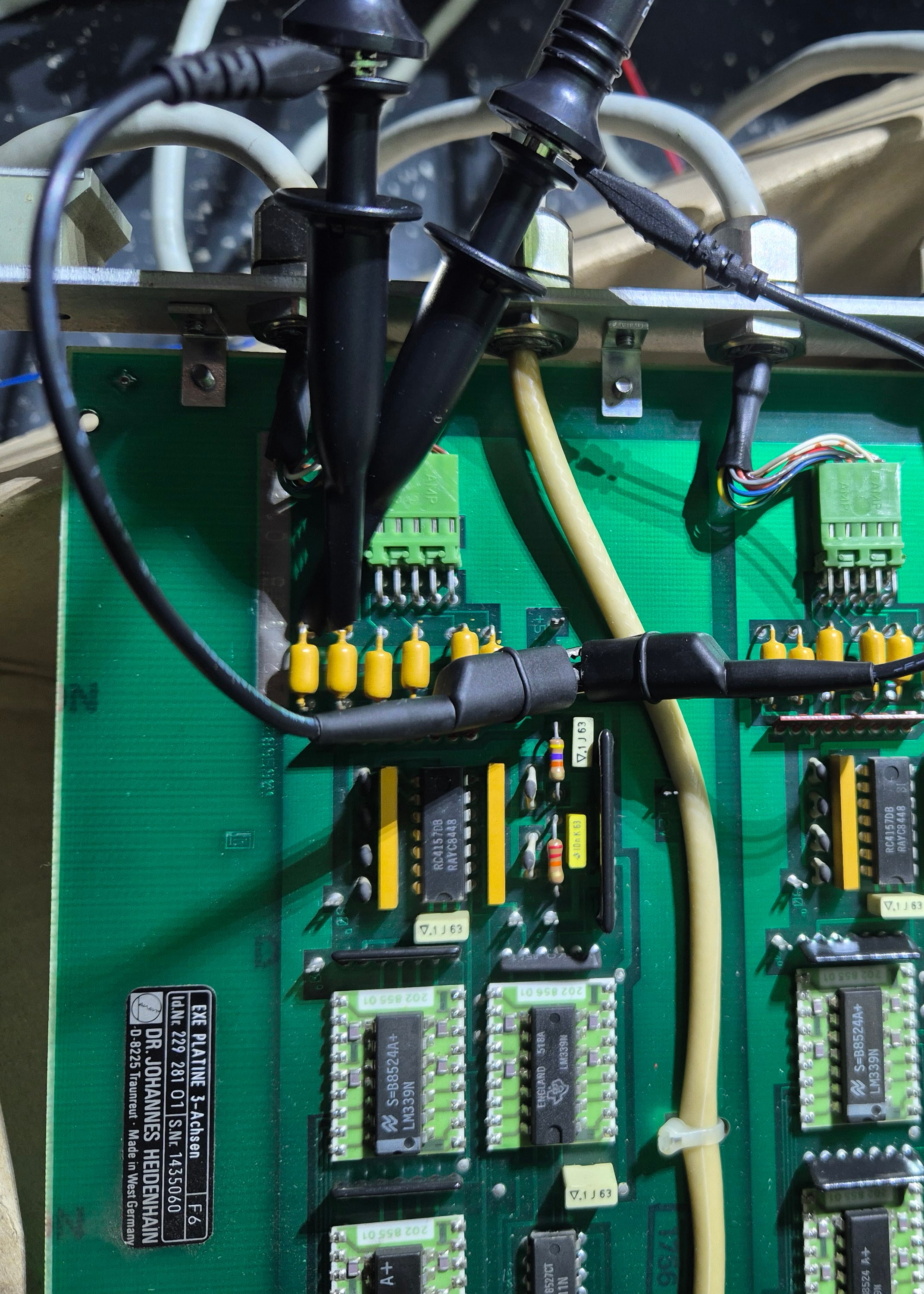

Hi all,

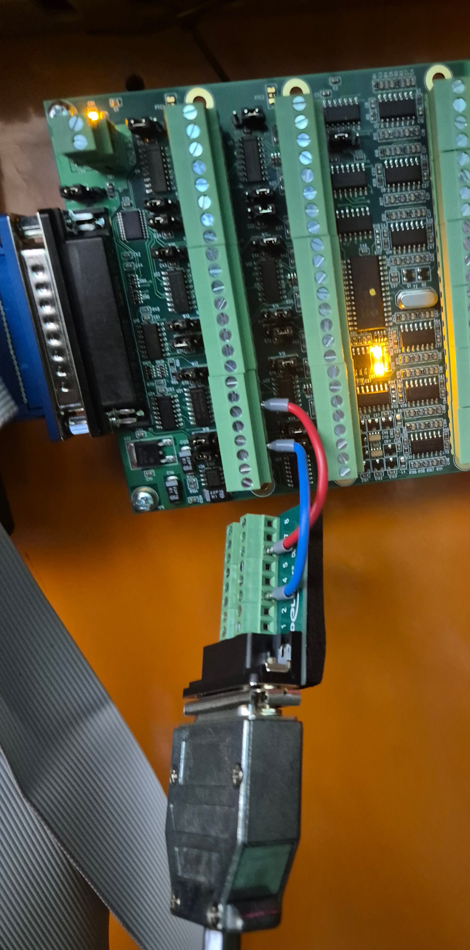

I’m trying to troubleshoot a Heidenhain LS403 linear encoder (1Vpp analog output) that’s connected via a Heidenhain 1Vpp-to-TTL converter to a Mesa card in my LinuxCNC setup.
We weren’t seeing any motion or position data in HAL, so I decided to check whether the encoder is still producing valid analog signals.
I’m fairly new to working with encoders — and also still learning my way around the oscilloscope — so I might be missing something obvious. That said, here’s what I’ve done so far:
- The encoder is powered via the Mesa card: 5 V and 0 V are confirmed and stable.
- For testing, the signal wires are disconnected from the Mesa. I’m only using it to supply power.
- Based on voltage levels and scope behavior while moving the encoder, I’ve identified A+, A–, B+, B–, R+, R–.
- When I probe A+ or B+ relative to 0 V, I see a flat ~2.0 V line. A– and B– show ~1.5 V. Moving the encoder slightly only causes minor fuzz — no visible sine wave.
- When I move the encoder head, the line does become “noisier” — in the sense that it gets visibly fuzzy — but I never see a clean sine wave.

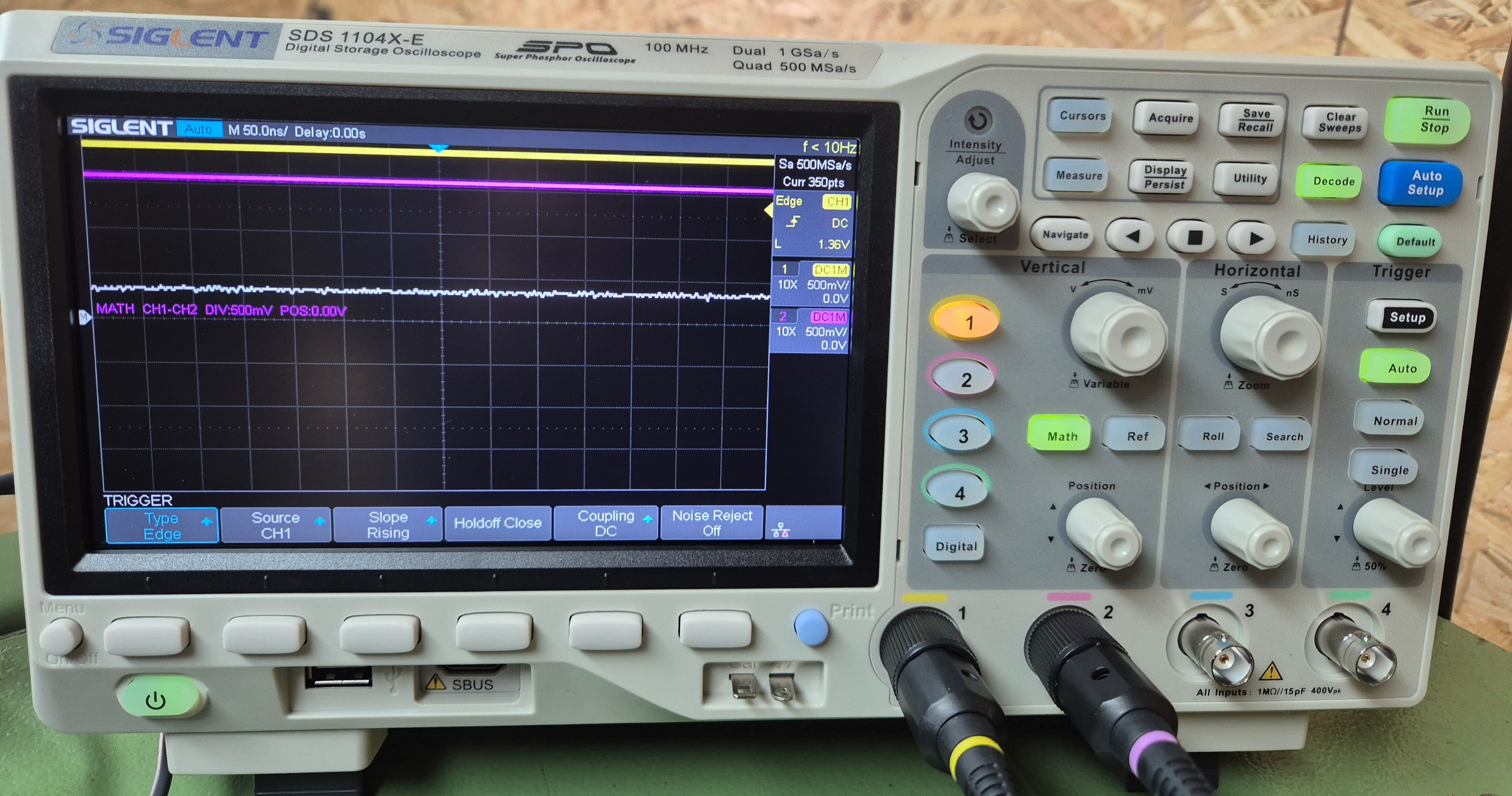

- I also tried using two probes and a CH1 - CH2 math channel on a Siglent SDS1104X-E to simulate differential probing, but still no sine wave appears.
- I’ve played with timebase, voltage scale, trigger settings, etc., without much change.
At this point I’m unsure whether:- The encoder might be dead,
- The signal needs a specific load to show up properly,
- Or I’m simply not probing it correctly.
Any tips or guidance would be very welcome — especially from folks who’ve scoped Heidenhain 1Vpp encoders before. Thanks in advance!

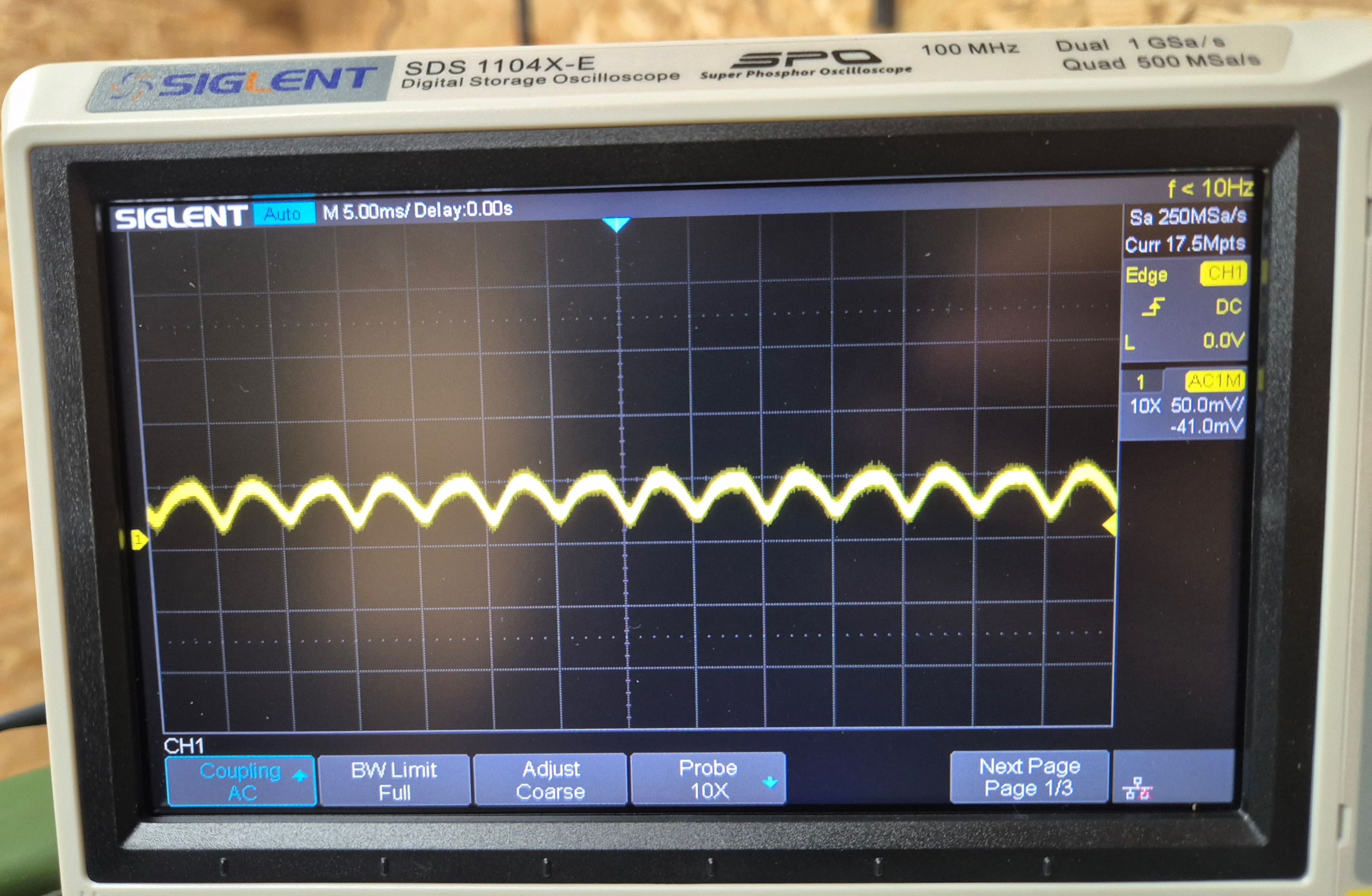

Thanks for the quick reply — that already helped a lot!
I switched the scope channel to AC coupling and used a drill with an Allen bit to move the spindle. Now I can finally see a sine wave (kind of).
However, two things are still puzzling me:
Any idea what could be causing the “thick” waveform, and why the amplitude is so low?
- The sine wave appears very thick on the screen. My guess is it’s some kind of electrical noise, but I’m not entirely sure.
- The amplitude is only around 50 mV, which is way lower than the expected 1 Vpp.

29 Mar 2025 19:33 #325276
Replied by PCW on topic Trouble probing 1Vpp signal from Heidenhain LS403 with oscilloscope
Yeah, that's not a sine wave (more like a rectified sine wave)
This may be something wrong with how you are measuring this
differentially (scope setup). Measuring single ended as Hansu suggested
would eliminate this possibility.
Is this connected to the converter? According to Heidenhains docs
the 1V P-P signals need a 120 Ohm (across 1V+ and 1V-) termination
The fuzzyness is likely just noise.
I suspect a problem with the encoder if you don't get ~1V sine waves when properly terminated

29 Mar 2025 23:21 #325289
by HansU
This could be done with a differential probe, or you could power the encoder with a galvanic isolated power supply.
But that is not important now, I only wanted to check if there is a signal at all.
I think the low amplitude level is also ok. I have a Heidenhain rotary encoder and also some linear magnetic scales l worked with -- they all have a level much lower peak-peak value than 1V.
Replied by HansU on topic Trouble probing 1Vpp signal from Heidenhain LS403 with oscilloscope
Yeah you will probably get a sine wave when you measure it differentially.Yeah, that's not a sine wave (more like a rectified sine wave)

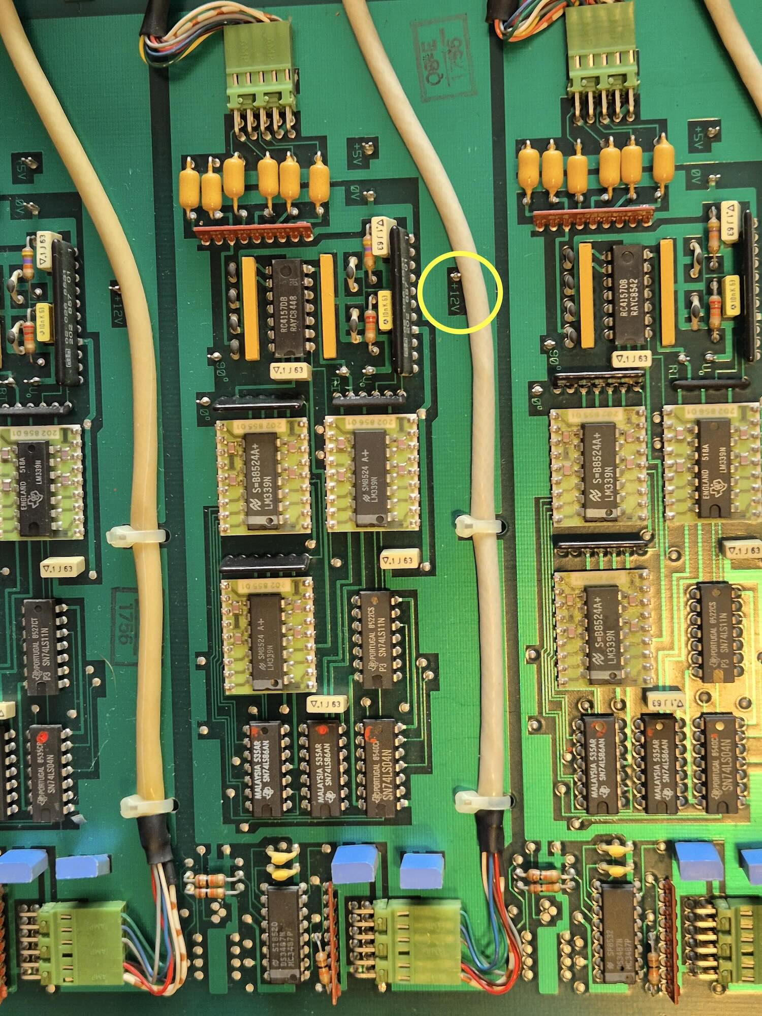

I noticed there’s a 12V pin on the board (right next to the white cable), but I originally assumed this was only used in other configurations. Now I’m starting to suspect it might actually be required for the board to function properly — possibly to power some signal conditioning or amplification circuitry.
Do you happen to know if this 12V input is normally used in setups with Mesa hardware? The 7i77 doesn’t provide 12V, so I’m wondering how this is usually handled. Is it common to add a separate 12V supply just for boards like this?
I haven’t applied 12V yet, since I don’t want to risk damaging anything.
Thanks again for the help!
I did some more measurements and I’m starting to learn a lot. It’s definitely a bit trickier working on a real machine compared to those nice clean test setups we often see on YouTube or datasheets

- Posts: 18111
- Thank you received: 5330
01 Apr 2025 19:55 #325478
Yes, a missing power supply may be the issue
All 7I77 encoder circuitry is 5V, so you would
need a separate 12V supply.
Do you have the converter manual? it should show
the 12V connection.
the 12V connection.

04 Apr 2025 19:47 #325711
Replied by andypugh on topic Trouble probing 1Vpp signal from Heidenhain LS403 with oscilloscope
The 0V, 5V and 12V pins highlighted look like test points to me. I wouldn't expect them to be scattered about the board like that if they were power inputs.
