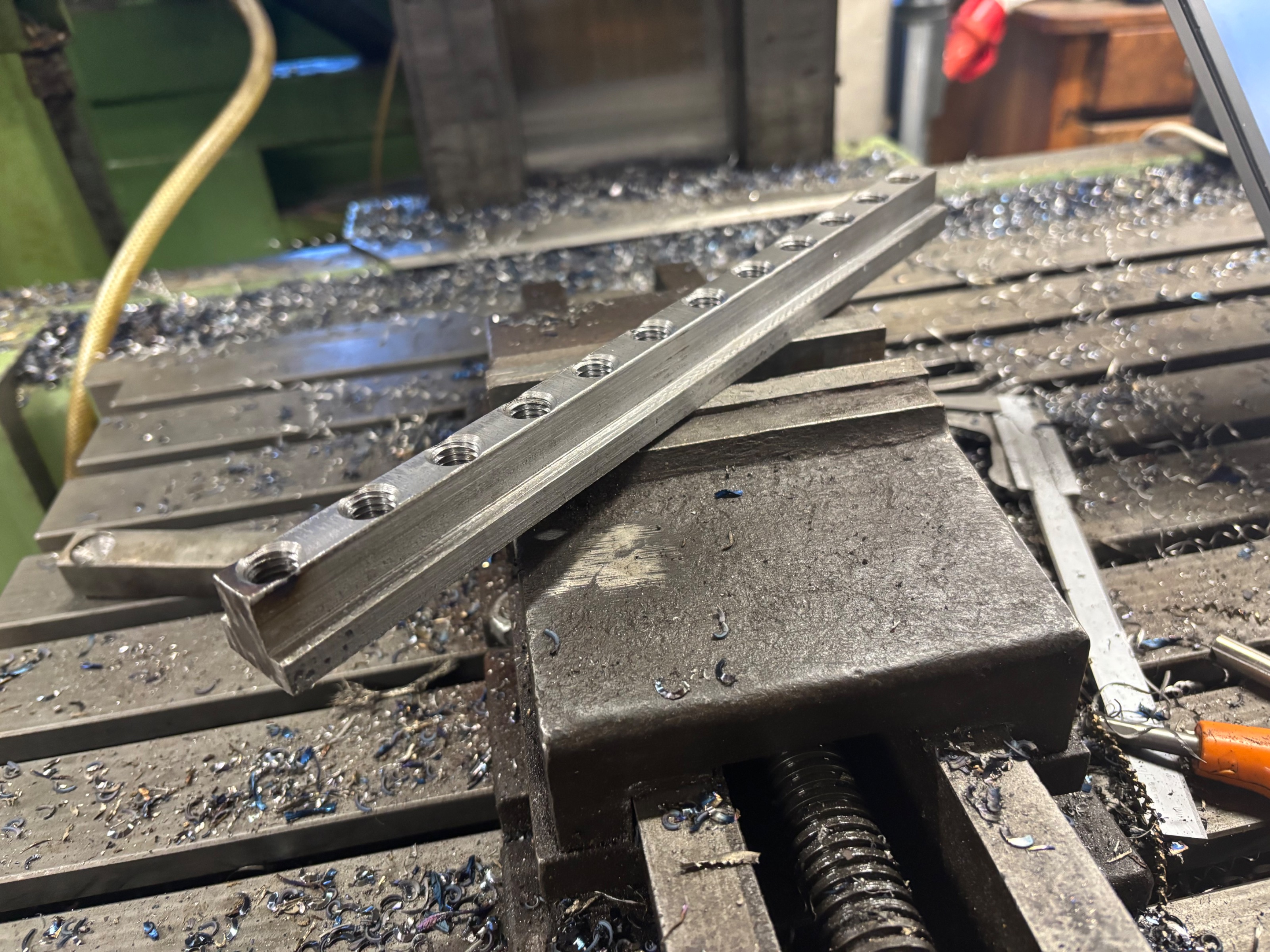

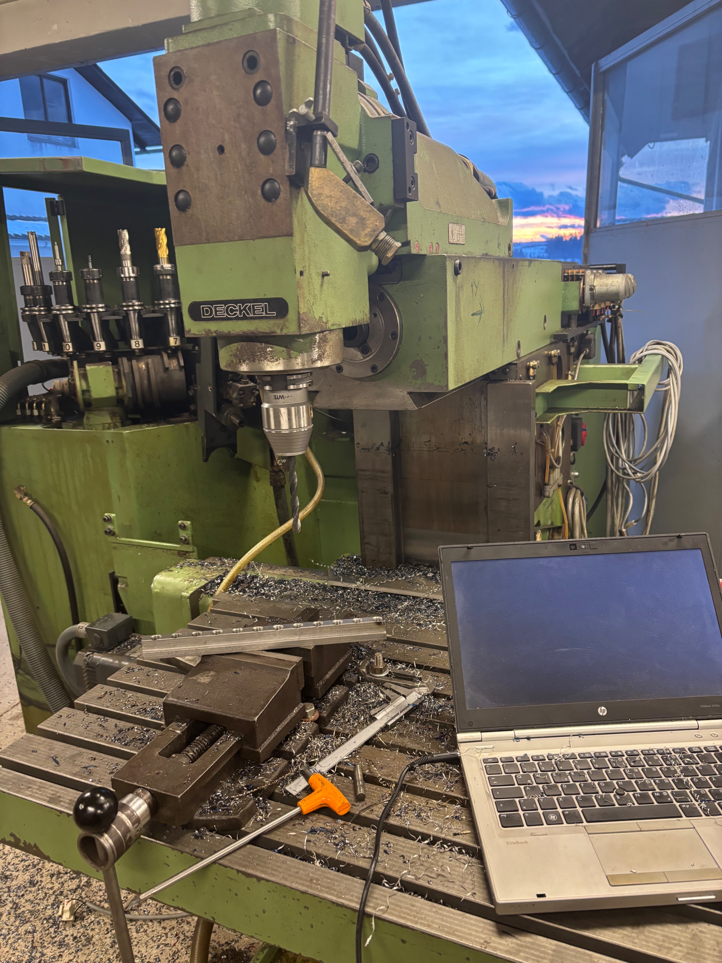

And finally the references work! I only can drive the joints very slowly to find the index. Is there a way to drive faster? The index is only 0.001mm wide. sometimes it wont pick up.
I also milled the first pices! It works great!
I have already recived the 7i74 und the 7i84U´s for the extentions.
On the weekend i will hook up these so i can use the diffrent gear for the spindle.
