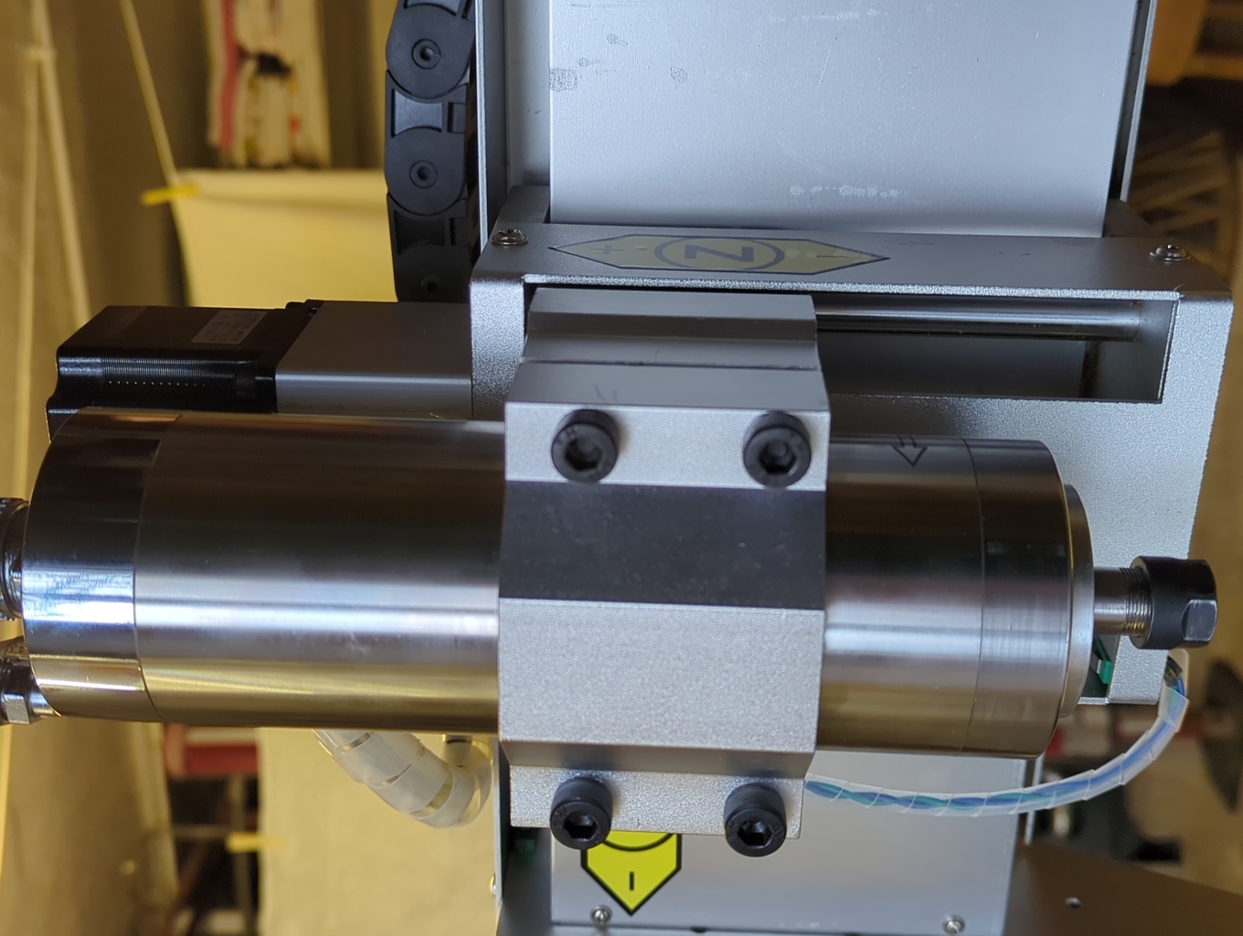

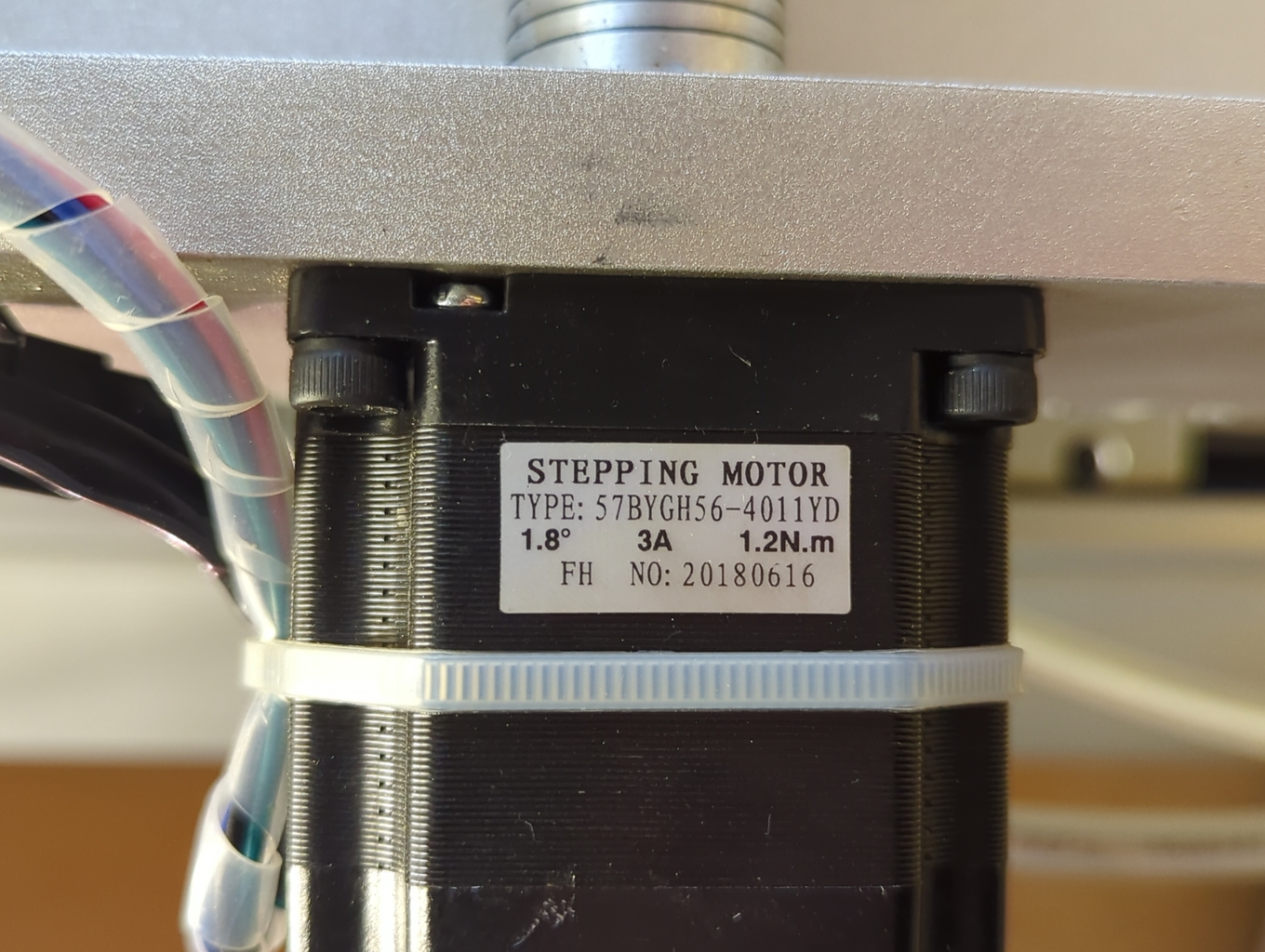

It is a Chinese 6040ZH router, 60x40cm bed, 4 axis, rod rails on all axis, 1.5kw spindle, 57BYGH56-4011YD stepper motors (1.26Nm holding torque, 2.8A), 24V system, running mach3 with a USB connection.

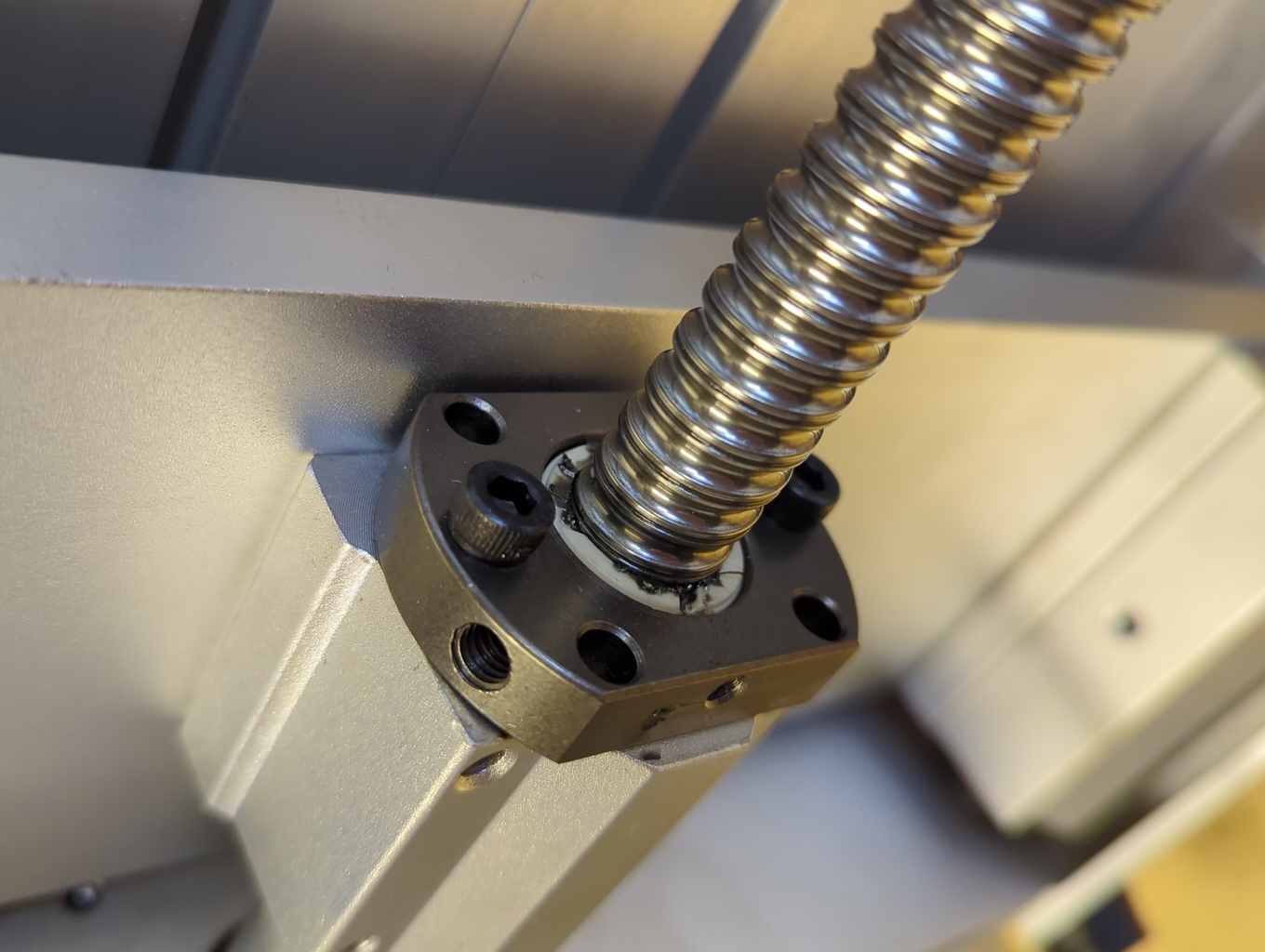

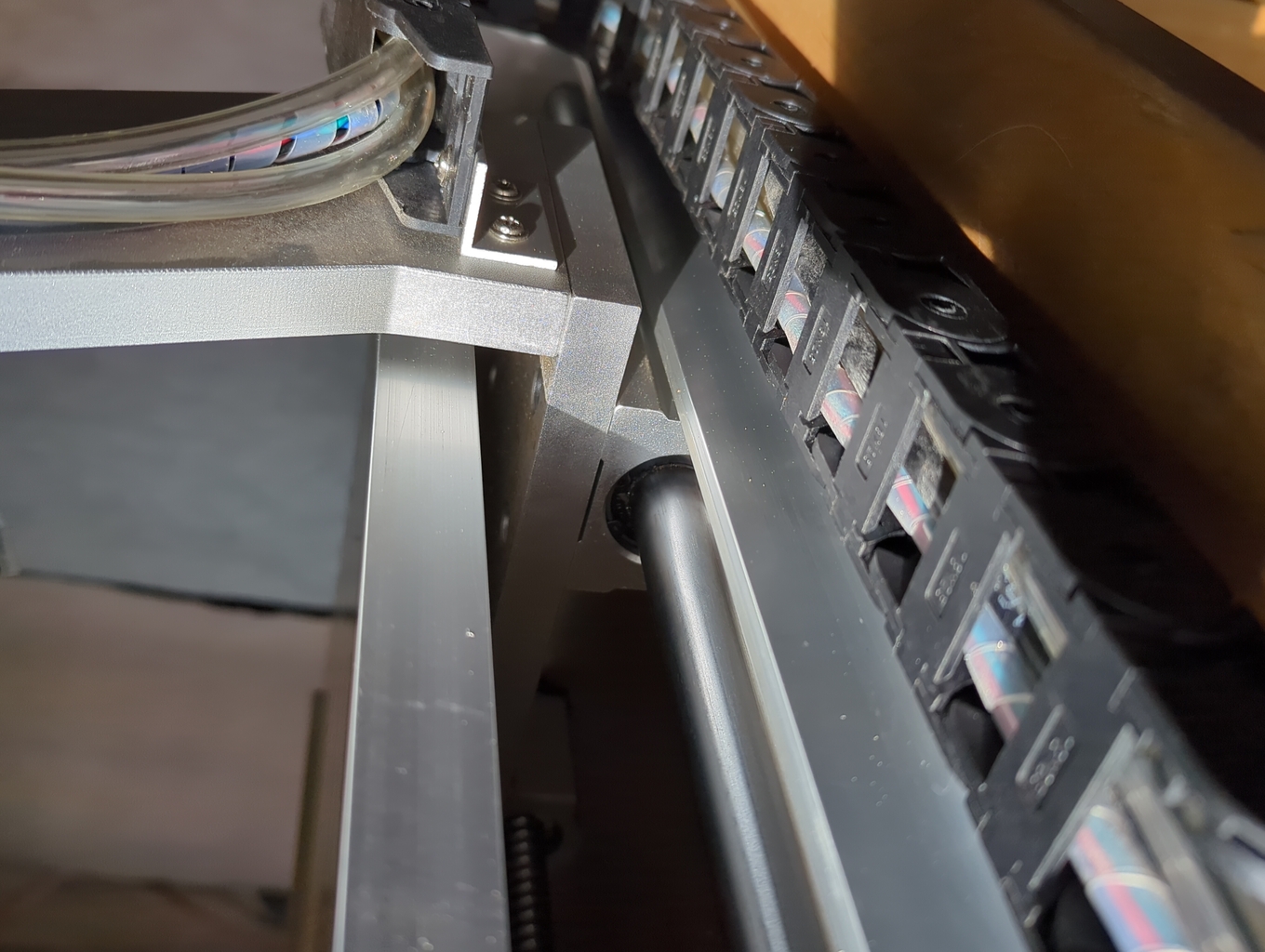

I' ve decided not to invest much into the machine because it has some mechanical design flaws and try to make the best out of it.

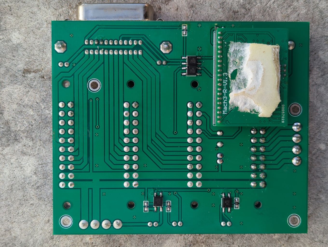

Since the controller board runs with a USB-Connection there is no way to run it directly with LinuxCNC. I wanted to know if its possible to reuse the electrical components and it seems so, the stepper motor controllers and the VFD for the spindle. Untested so far.
My plan is to use a MESA i796S board. If you have another suggestion let me know. Unfortunately they are out of stock currently.

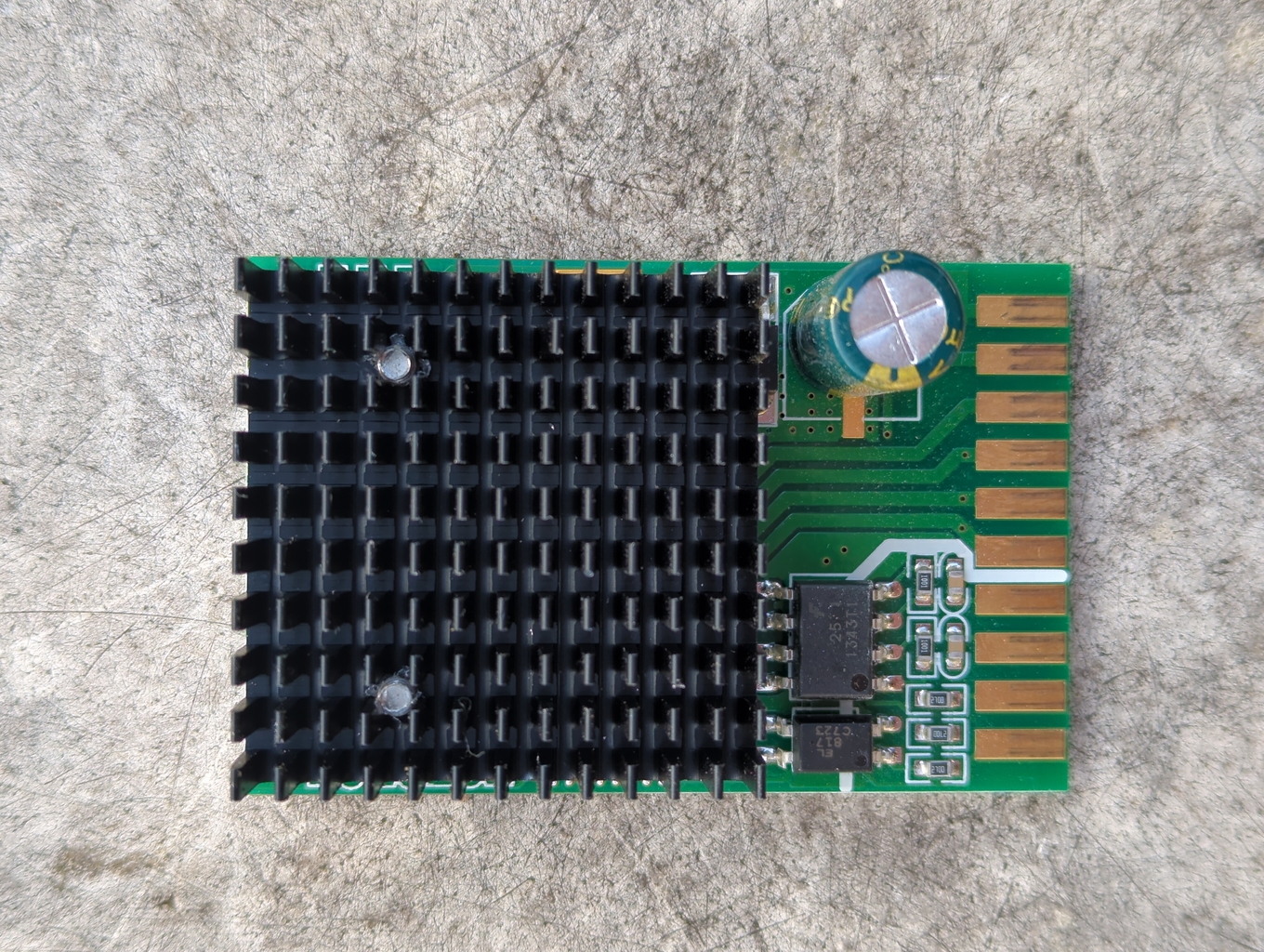

The stepper motor controllers are 20 pin modules that stick on some kind of motherboard which also hosts the Mach3 controller, namely a Mach3-R-V1.3. With some reverse engineering I'm confident that I could figure out the function of the pins of the stepper motor controllers. The IC of the drivers seems to be a TB6600HQ or a clone. It has a voltage range of 8-42V, supports operating current of 4.5A, about 150w. It says www.shyidiao.com on them.
Front side from left to right (with the heat spreader remove from the IC. On the bottom left are two optocouplers):
GND, +5V, Pulse, Direction, Stepper RED, Stepper BLUE, Stepper GREEN, Stepper BLACK, +24V, +24V
Back side from left to right (reversed direction from above):
+24V, +24V, Stepper BLACK, Stepper GREEN, Stepper BLUE, Stepper RED, GND, GND, GND, GND
The soldering joints are very likely determining the microstepping of the drivers. If the configuration is from left to right: 1, 1/2, 1/4, 1/8, 1/16 and 1/32 then they are set to a reasonable 1/8.
- It has rod rails and not linear guides
- The leaver arm on Y-axis to the rod rails is bigger than it needs to be. The rods could have been placed higher

The blue short Centronics connector on the back of the case/on the board upper left, seems like it is for MPG and knowing how lazy chinese are, i would venture a guess at having step/sir pins for all drives on it, so grab the TB6600 datasheet and a DVM and measure continuance between those pins on the chip and on the connector.
That should save you a lot of time even if you do not have the connector for it as it is easy to solder wires to those connector pins.

Thank you for the interesting idea. I think it would not work to drive the stepper motor drivers from the blue Centronics connector because the drivers have each two Optocouplers, for STEP and DIR (see white frame on the front side of the driver board).

Nope, those are motor traces from drives to the connector, so that idea is a dud.
Cutting the step/dir traces on the drives or the main board then ?

I think what I might try with that, would be to figure out which traces on the motherboard are step and direction for each axis. I would cut each trace on the motherboard somewhere between the I.C. and the blue card edge connectors in locations where I'd have a chance of bridging the cut with solder in case I later wanted to undo it. This would tend to be near the solder points where the blue card edge connectors are soldered in. This is to prevent the original I.C. from interfering with the signals from LinuxCNC.
Then I would solder maybe 24 AWG wires to the solder pins of each step and direction on the back side of the card edge connectors for wiring into a 4 or 5 axis parallel port bob that can be bought at low cost.
This would allow the power and motor connections to stay original. Spindle and e-stop signals I would wire direct to the bob. Make sure to connect bob's ground to a common ground on that motherboard.
Hope that helps.
