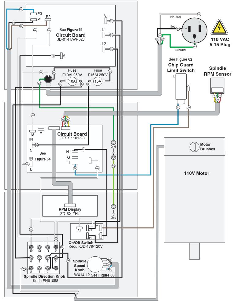

Help wiring G0704 Spindle to Mesa 7i96s

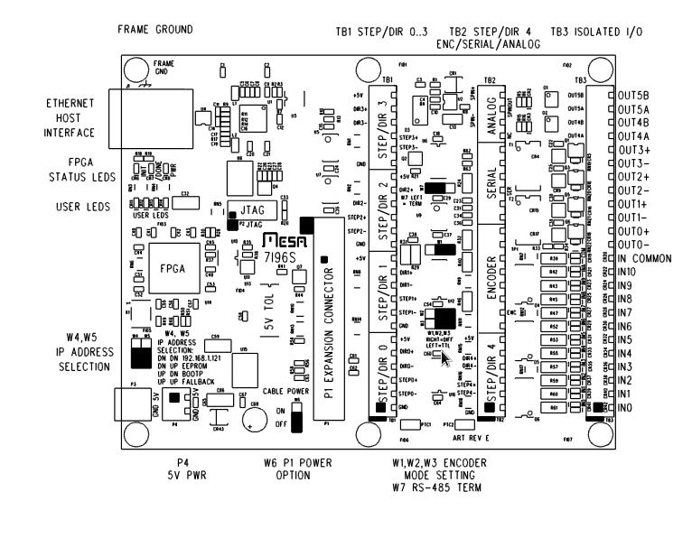

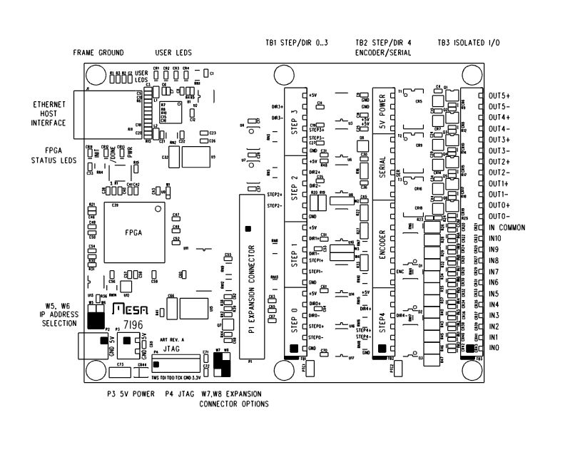

Do you have a Mesa 7i96 or 7i96S?
Your tittle says 7i96S but the attached picture is for 7i96, so what gives?

Whoops, got the wrong image. It's a 7i96s

I did finally get my spindle to work. I removed everthing from the spindle control cabinet and replaced them with a KBSI-240D signal isolator paired w/ a KBMM-125 DC drive. Relatively simple wiring, I can put together a simple diagram if needed. Now I'm working on trying to get RPM feedback from the existing tach.
