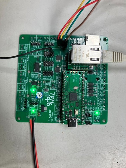

I am not sure if Linux CNC is really cheaper than GRBL.
www.grbl.org/single-post/a-peek-at-the-picocnc This is an example based on the Raspberry Pi Pico, all documented and possible to recreate "in the flesh". I bought the Pico boards for like 3€ a piece. The base board was more expensive, but not too crazy.

Exactly! The PC (raspberry Pi or similar), power supplies and stepper (or servo drivers) can be basically the same. What I think is that the mesa card is not worth it, when you stay with open loop stepper motors and the mechanical system is not made for high speeds. But once you start using the I/O and Encoder inputs it is a real help to have a system that is easy to use, supported and works (happy customer of Mesa Plug n go kit).
For the picoCNC I paid roughly (guessing) 130-140€. Some things come with minimum quantities, others are discounted. It ends up at approx. 30€ a piece +-. I would have just bought the successor of it for 50$, but shipping would have doubled the price. To me it was more about the assembly challenge than the actual need for it. But there are "ready to go" options.
