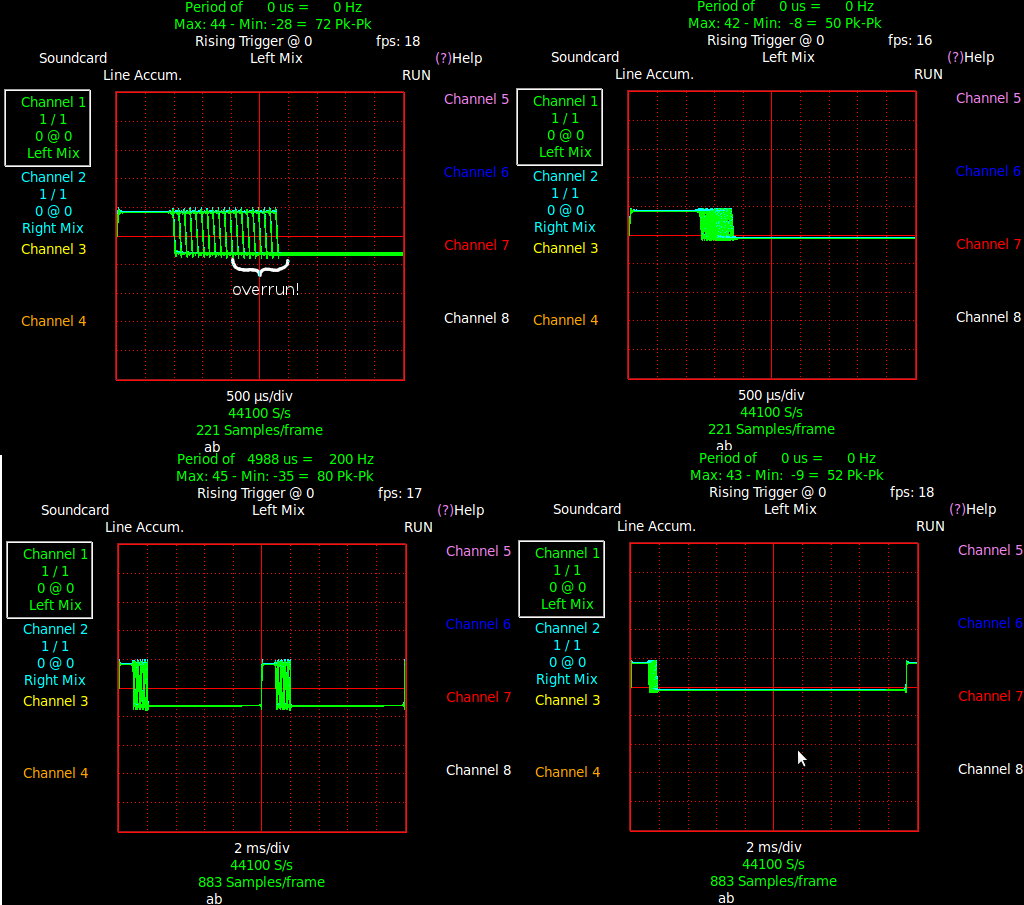

Hi!
It was my misuse of Axis GUI, i'm very sorry. I should never touch 'Spindle Override' slider, after which i get strange behaviour. But if i don't touch it, PWM is well controlled from both '+' and '-' buttons from GUI, as well as via telnet and MDI mode. So Stepconf Wizard not contain an error.
But...
I found that i can't fine tune pulse width. :-( When i set duty cycle range from 0.2 to 0.8 (default), it is looks to be well controlled (but not useable by RC car ESC). But when i try to set in in 0.075 to 0.1 range, i get pulse width steps change which is not precise enough. I try to change 'setp pwmgen.0.dither-pwm true', when it's 'true' it is helpful to smooth the integral long-term duty cycle (which can be measured also as output DC voltage), but not affect pulse witdh change step.
In other words, it looks that main clock frequency of the PWM generator is too low.
Can it be as high as at least 20 kHz? Then i can get i hope ten different pulse width in range 1.5 to 2 ms, i.e. i need 1.5, 1.55, 1.6, ..., 2.0 ms.
Thank you very much!

03 Nov 2011 10:50 #14540 by andypugh
Replied by andypugh on topic Re:PWM not quite working
That depends on your PC. if you have a base_period of 25,000nS then the PWM base frequency is 40kHz, so you can get the resolution you want.
What base period do you have (it is in your INI file) and what is your latency test result?
If you want a 1% resolution in 0.5mS pulse width then I think you need 200kHz, and you are never going to get that with software step generation.
A 16-bit hardware PWM should have no problems, you get 15nS resolution on a 1mS base frequency. You could use a Mesa card (but they cost money) or perhaps set up a microcontroller (an Arduino is easy to use) which measures an incoming 0-100% duty cycle PWM and outputs a 0-0.2% duty cycle.
03 Nov 2011 16:20 - 03 Nov 2011 16:21 #14554 by jpka
Replied by jpka on topic Re:PWM not quite working
So i now understand why people uses microcontroller here, instead of cheap DIY-like glueless connect :-)
Max jitter, ns, Servo thread: ~9000; Base thread: ~7000.
BASE_PERIOD = 100000
SERVO_PERIOD = 1000000
I also set 'Base period maximum jitter' in StepconfWizard to 10K instead of default 15K. (This lead to very rare 'unexpected realtime problems')
So i get some useful results. While step tune is still too coarse, hopefully my aircraft ESC have ability to use entire 1...2 mS range to drive in only one direction, in compare to 1.5...2mS default / typical, but i think it is quite non-standard. (maybe it standard for aircraft but not car ESCs, because aircrafts never use reverse :P )
(my esc is 'TUR 150A Brushless Motor Speed Controller RC ESC BEC' from Ebay). It is gluelessly connects to LPT port. So this setup can be useful in real life.
My PWM settings are:
PWM Rate  100
Speed1 0
Speed2 1000
PWM1 0.1
PWM2 0.2
and removed 'setp pwmgen.0.dither-pwm true' from .hal file.
I also attach waveforms taken from Xoscope via line input sound card directly connected to PWM input of ESC. At left is EMC out, at right is signal taken from small RC car.
Note the overrun pulse lengths which occurs if i press '+' spindle speed in Axis GUI more than 10 times.
Hope it helps someone who try to use brushless motor! :-)
