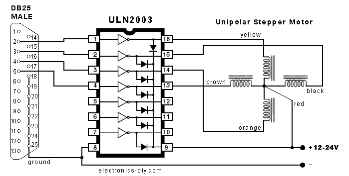

Hello everyone,
I am a pretty big noob when it comes to CNC and LinuxCNC and am having trouble getting my system working.
What I have is a really basic two axis setup that I made myself from some old 5 wire stepper motors out of a printer. I would like to control them with a pair of ULN2003 Darlington array ICs (because they are amazingly cheap and I already have them). I have found a few sites/forum posts that say that this setup is possible with LinuxCNC and hint at how to do it but most of them are quite old and I can't get it working.
From what I understand I need to edit my .hal file and change stepgen from type 0 to type 5 as well as edit some other items in that file which will assign the proper output pin configuration. It also looks like I have to remove some items which only apply to type 0 but I can't figure out what. Is there an example .hal file for a type 5 stepgen anywhere? I have read the stepgen documentation but I am still lost.
The attached file shows how my configuration is wired.
Thanks for any help you can provide and sorry if this is in the wrong section!
-Liam
24 Sep 2012 20:17 #24593 by BigJohnT
Replied by BigJohnT on topic Re:Driving a ULN2003 Darlington array IC
In your hal file you will find the line that loads stepgen and change the type0 to type5.
loadrt stepgen step_type=type0,type0,type0
to
loadrt stepgen step_type=type5,type5,type5
John

25 Sep 2012 10:27 #24601 by PCW
uln2003.hal:44: parameter or pin 'stepgen.0.stepspace' not found
Is the problem, stepspace only exists in stepgen modes 0, and 1
so you need to delete or comment out all the setp stepgen.X.stepspace 0
statements in your hal file
For more information, take a look at the stepgen manual:
type
man stepgen
in a terminal window

27 Sep 2012 22:29 #24675 by BigJohnT
liam2317 wrote:
Thanks for the help guys but I still can't quite get it working!
I have done a lot of reading and messing around with my .hal file but still have no output.
BigJohnT wrote:
A far easier way is to return the first 3 back to type 0 and add one more as type 5 and see what pins are created for this and work from there.
I have not been able to figure out how to do this unless you mean running something like this in hal command: halcmd loadrt stepgen step_type=0,0,5 ctrl_type=p,p,v
I tried that but it doesn't generate any pins or anything. How else could I do this?
Open your hal file and find the loadrt stepgen line and change it to:
loadrt stepgen step_type=0,0,0,5
John
28 Sep 2012 04:13 #24679 by liam2317
Replied by liam2317 on topic Re:Driving a ULN2003 Darlington array IC
As far as I can tell doing that does absolutely nothing. Where should I be looking? What do I do after that? Running that hal file doesn't give an error but it doesn't make another axis show up or anything. Looking at it's Show Hal Config page doesn't give me any new info either.
Now I'm really confused.... :S
28 Sep 2012 05:14 #24680 by liam2317
Apologies for the double post,
I have made some changes to my .hal file and am now seeing much more positive results however it is still not working.
First I changed:
net xpa => parport.0.pin-02-out
setp parport.0.pin-02-out-reset 1
to:
net xpa => parport.0.pin-01-out
setp parport.0.pin-01-out-reset 1
I now have all four of the pins I wanted showing output.
I also changed to stepgen type from 5 to 6 because this generates the same type of signal as my arduino uses which makes comparing the two easier.
The problem, I have realized now is with my parallel port or some setting involving output pin voltage. When a parallel port pin is driven high it is only reading 0.32V (low is about 0.09V) when high should be near 5.0V! Any ideas what the problem could be? Do I just have a bad parallel port? I have measured the voltage by sticking a pin the the parallel port so I know it is not the cable.
Thanks!
  • andypugh
  • andypugh's Avatar
  • Away
  • Moderator
  • Moderator
28 Sep 2012 10:29 #24687 by andypugh
Replied by andypugh on topic Re:Driving a ULN2003 Darlington array IC
You absolutely do not want RESET active in this setup.
Reset sets a pin low reset-time after the parport-write thread runs. This is good for step/dir drives as it doubles the available step rate. It is disastrous for direct phase generation like you are attempting.
When a parallel port pin is driven high it is only reading 0.32V (low is about 0.09V) when high should be near 5.0V! [/color][/b] Any ideas what the problem could be?
Is this the case even with nothing connected?
What are you measuring with?
