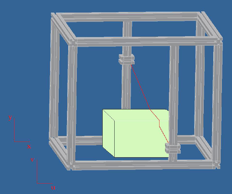

Together with a collegue student I am making a wirecutting machne for cutting expanded polystyrene.
Our first challenge is to make it work in 2D.
We chose for the XYZA configuration, and set the parameters for the X and Y axis. After we have done that, we set the parameters for the parallel port in the 'standard pinout' file. So we sent 'X dir' and 'X step' to 2 different stepper motors, and the same for 'Y dir' and 'Y step'. The result is that both axes move together, but as a result of different usage of gear boxes, the axes do not move at an equal speed. What can we do to solve this problem ?
We thought to configure al four XYZA axes, where we use the Z configuration for our U axis, and the A configuration for our V axis, but then we've got the problem that we don't know how to make them move together...
Thanks in advance for your help,

I am not sure I understand what you are asking. If you have two stepper motors with the same gearing driving both sides of the x axis they should move together. The same for the y axis. The maximum speed of a coordinated move of the x and y axis will be determined by the slowest axis.
So you limit the speed of a move to that of the slowest axis. On the other hand if it is more complicated than that look at the Integrator Manual Chapter 27 Kinematics in EMC2. If you use a four axis setup and want to make a move where one side of the x axis is x and the other side is the u and you are at x0 u0 and you set your speed to say f10 you could write something like g01 x5u5 and they should move together at the same speed. The axis for EMC2 are XYZABCUVW.

When you install EMC the manuals should be on your computer, look at the drop down menu. If not there go to www.linuxcnc.org/ and click on documentation, there are several versions from basic to in depth. What you are doing is more complex than a simple set up so you are diving off the deep end. I think you will be able to make it work. I suspect you will need a XYUV config. If set up right not only will the machine move correctly but the AXIS screen may also be correct. I think if you start with a XYZA machine you will then edit the config to add the set up the 2nd 2 axis.

you cannot use the stepconf wizzard for this type of machine, you must edit ini and hal.
I made a config for a similar machine : code.google.com/p/emc2hotwinch/
