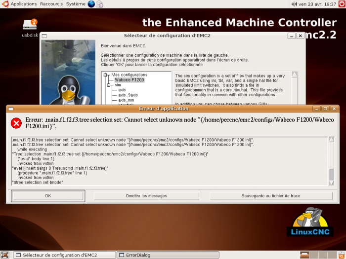

Hello,
I am new on EMC2 software and Linux.
All the installation is good, no error message.
I made de Stepconf wizard, all my axis run well and smooth.
So, in the EMC2 config folder, I can see my mill profile "Wabeco F1200".
When I run EMC2 and chose this profile, this message appear :
I erase the profile and made an other profile on Stepconf wizard.
Run well and smooth.
But always this message when I run EMC2 and chose the Wabeco F1200 profile.
Do you have an idea ?

If you create a config with the stepconf wizard then use the desktop shortcut to launch it.

I find !
I create a folder name in Stepconf wizard which name is "Wabeco 1200F".
It seems Emc2 don't recognize folder name with space.
So I create an other profil which name is "Wabeco_1200F" and .......
Youpi EMC2 recognize this mill configuration and run without problem de GCode example !
