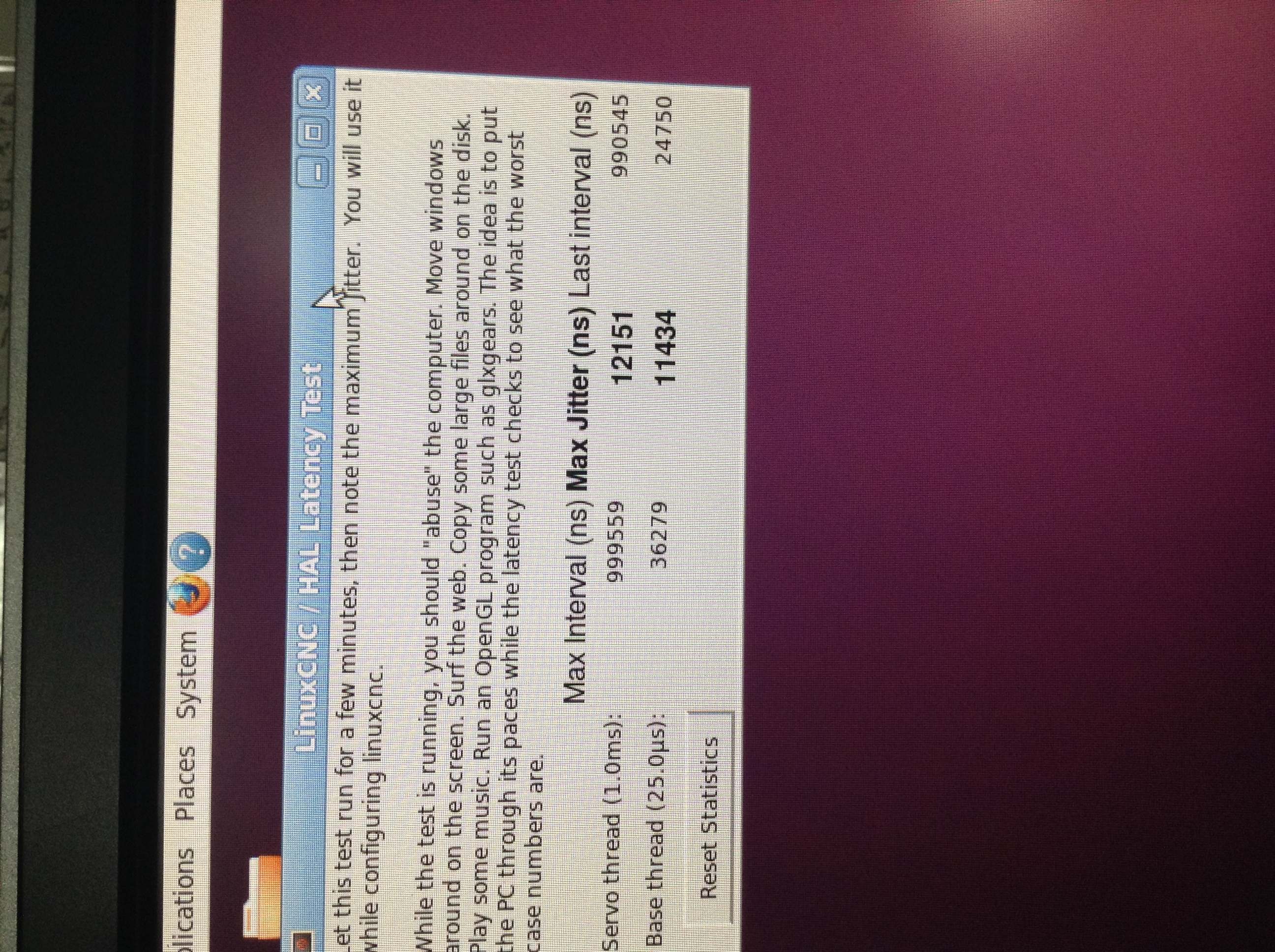

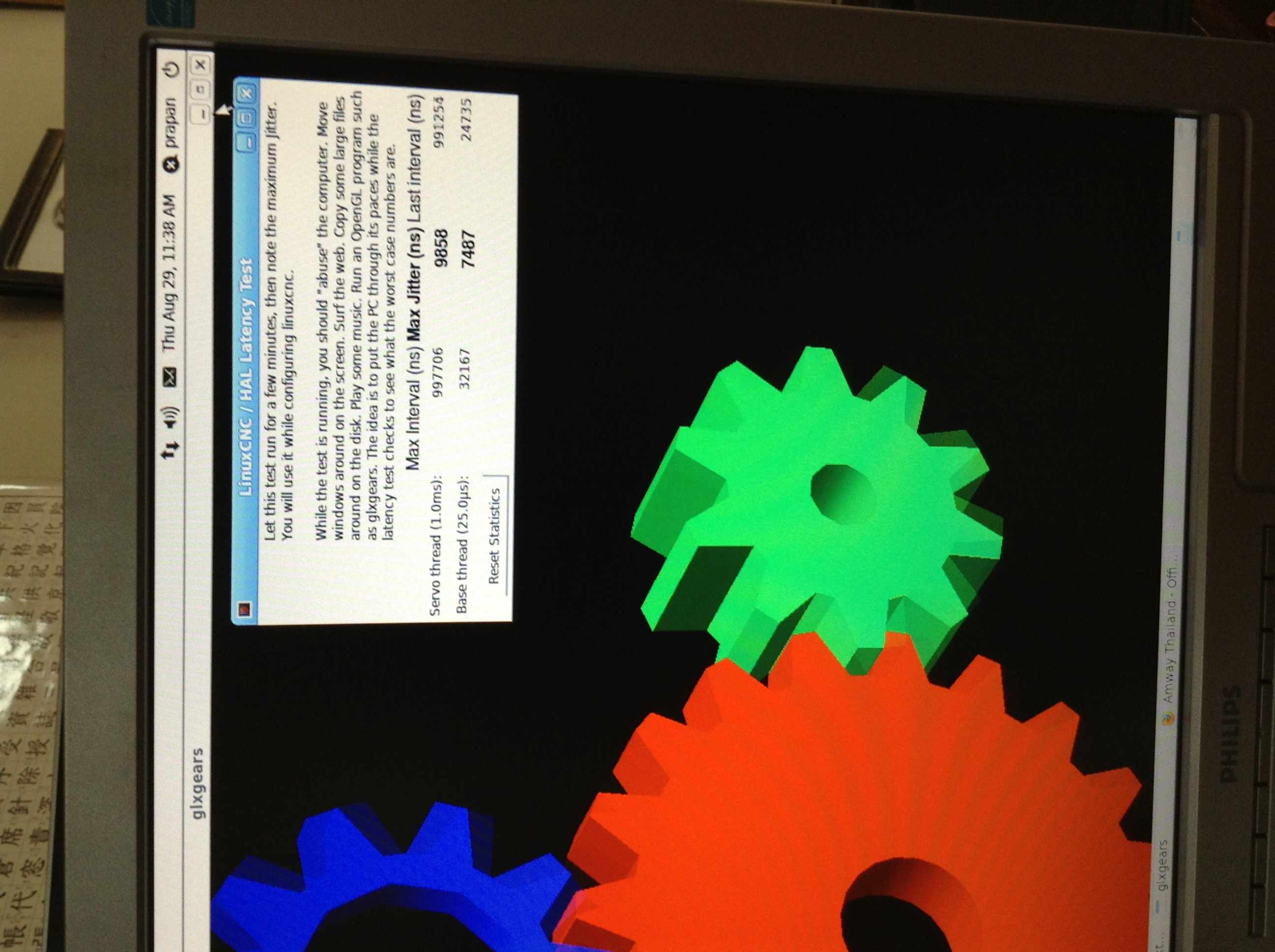

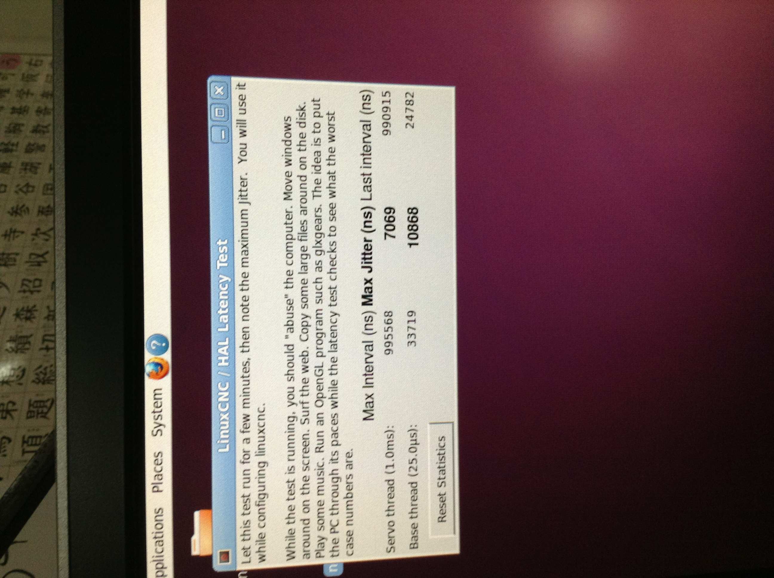

I do by after my pc boot to linuxcnc for a while 1 or 2 min. I run latency test alone. Nothing else. Just before I sleep. Then wake up I check the number. (~8hours) I also try this 10 time. I guess this is not so good right? I plan to test again but to open glxgears full screen and Firefox in background. Is that okay? Enough? Better?
And I should use the maximum number i've got. NOT the average one. Am I right?
This is number I run latency test alone.
1. Servo Thread 7069 ,Base Thread 10868
2. Servo Thread 8826 ,Base Thread 5541
3. Servo Thread 8826 ,Base Thread 6456
4. Servo Thread 7332 ,Base Thread 11597
5. Servo Thread 7916 ,Base Thread 6658
6. Servo Thread 7984 ,Base Thread 5611
7. Servo Thread 8550 ,Base Thread 5586
8. Servo Thread 7800 ,Base Thread 5632
9. Servo Thread 12151 ,Base Thread 11434
10.Servo Thread 8045 ,Base Thread 5908
