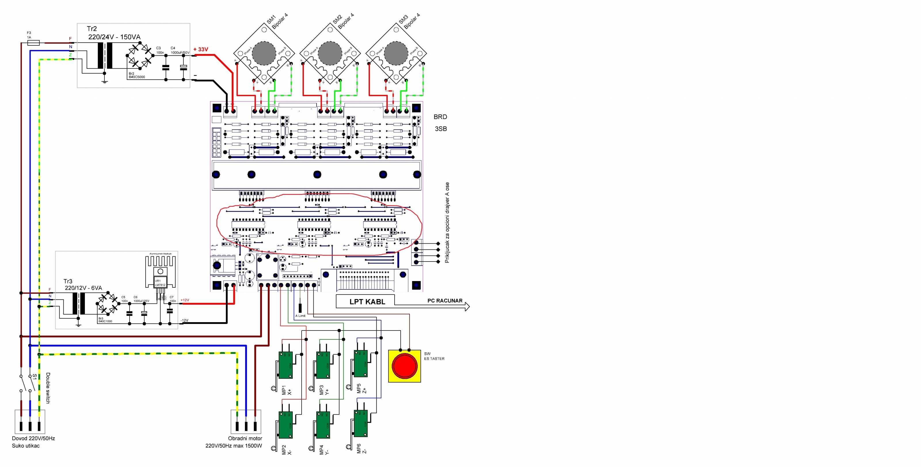

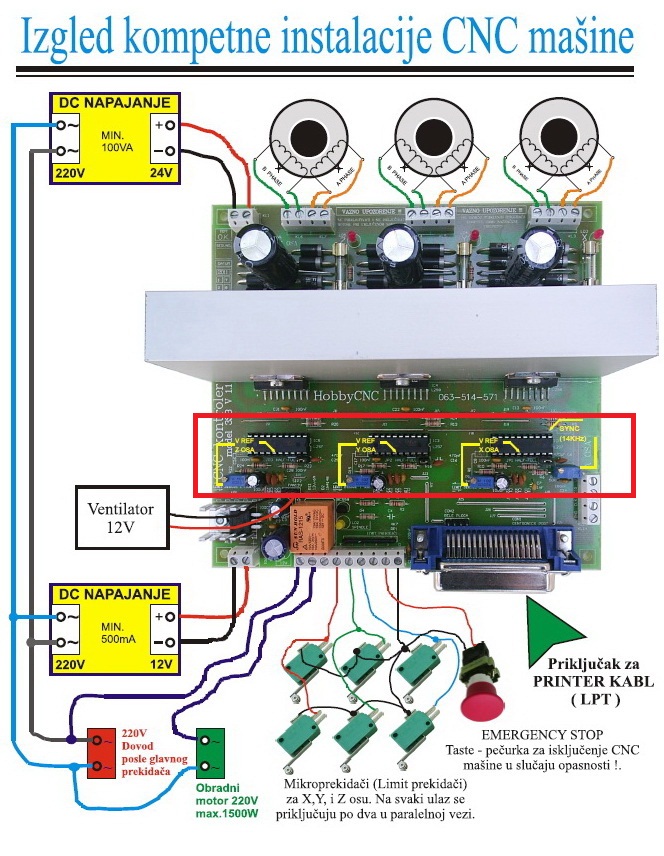

13 Sep 2013 16:45 #38756 by probamo
Replied by probamo on topic L297 controler and StepConf
Hereafter attached are files 3SB as photo and scheme of my controller (in red areas are L297) as well as data sheet of the step motors I installed.
I am not familiar with opto-isolators, therefor if you can analyze a bit attachments and let me know what to do.
I can reduce the figures, but please let me know what would be optimal range for the motors I use. Leadscrews are ball screw 5mm/rev.
13 Sep 2013 17:50 #38761 by ArcEye
Replied by ArcEye on topic L297 controler and StepConf
Ok, becoming a bit clearer
LS297 is an integrated circuit ( a chip ) not a controller board.
This board made by HobbyCNC could have any number of components which would delay the timings of the driver.
It is unclear if it has any opto-isolators, as the schematic is of components on a PCB not the circuit.
Their website has scant information, no downloadable spec sheets, you need to ask them what the timings are for the board.
