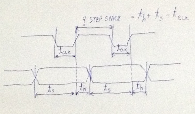

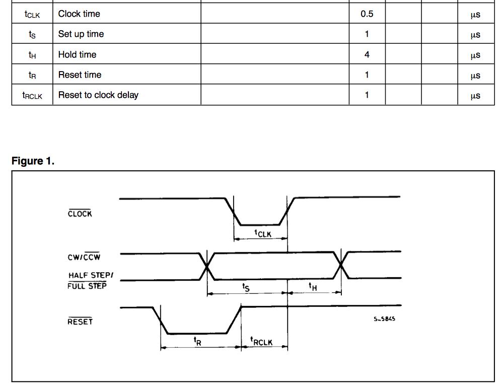

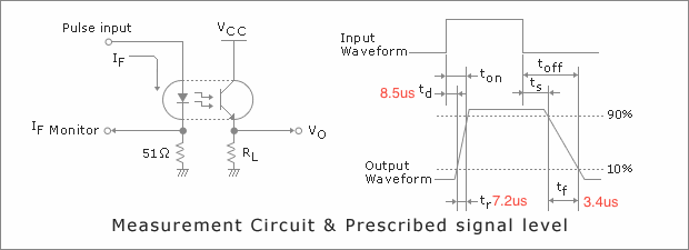

I build my Break Out board and Driver board.
- I use 4n25-Opto for protect my LPT-port
- I use L297 + L298 for driver board.
I've done some research/measure reading and by oscilloscope this is my result
1st pic is , I measure td (delay from input) 8.5us , tr 7.2us (rising edge max) , tf 3.4us (falling edge max) by oscilloscope
2nd pic is timing of L297 for driver board. tclk 0.5us , ts 1us , th 4us
3rd pic is how my calculate for STEP SPACE in StepConf that I use.

(1.) for STEP TIME ,
I do: tclk (of L297) + tr (rising of 4n25) + tf (falling of 4n25) = 0.5us + 7.2us + 3.4us = 11.1us or 11,100ns maybe I put 12,000ns for play safe. Am I correct?
(2.) for STEP SPACE ,
min space between each pulse.
So I do: th (of L297) + ts (of L297) - tclk (of L297)
but I need to add rising&falling of 4n25
So I do: [th (of L297) + tr+tf (rise&fall of 4n25)] + [ts (of L297) + tr+tf (rise&fall of 4n25)] - [tclk (of L297) + tr+tf (rise&fall of 4n25)]
= (4us + 10.6us) + (1us + 10.6us) - (0.5us + 10.6us)
=15.1us or 15,100ns maybe I put 16,000ns for play safe
am I correct or not?
(3.) for DIRECTION HOLD ,
I do: th (of L297) + tr (rising of 4n25) + tf (falling of 4n25) = 4us + 7.2us + 3.4us = 14,6us or 14,600ns maybe I put 15,000 for play safe. Am I correct?
(4.) for DIRECTION SETUP
I do: ts (of L297) + tr (rising of 4n25) + tf (falling of 4n25) = 1us + 7.2us + 3.4us = 11,6us or 11,600ns maybe I put 12,000 for play safe. Am I correct?
(5.) for delay of 4n25 (td) is 8.5us.
So I plus it with Base period Maximum jitter. Which my pc is : 7000ns
So I do 7000ns + 8.5us = 15.5us or 15,500ns maybe I put 16,000 for play safe.
But base on this: wiki.linuxcnc.org/cgi-bin/wiki.pl?Tweaki...ftwareStepGeneration "Making a step pulse requires at least two periods"
So I may plus 2times delay of 4n25: 7000ns + 8.5us + 8.5us = 24us or 24,000us maybe I put 25,000us for play safe
Which one is correct? 16,000ns or 25,000ns?
