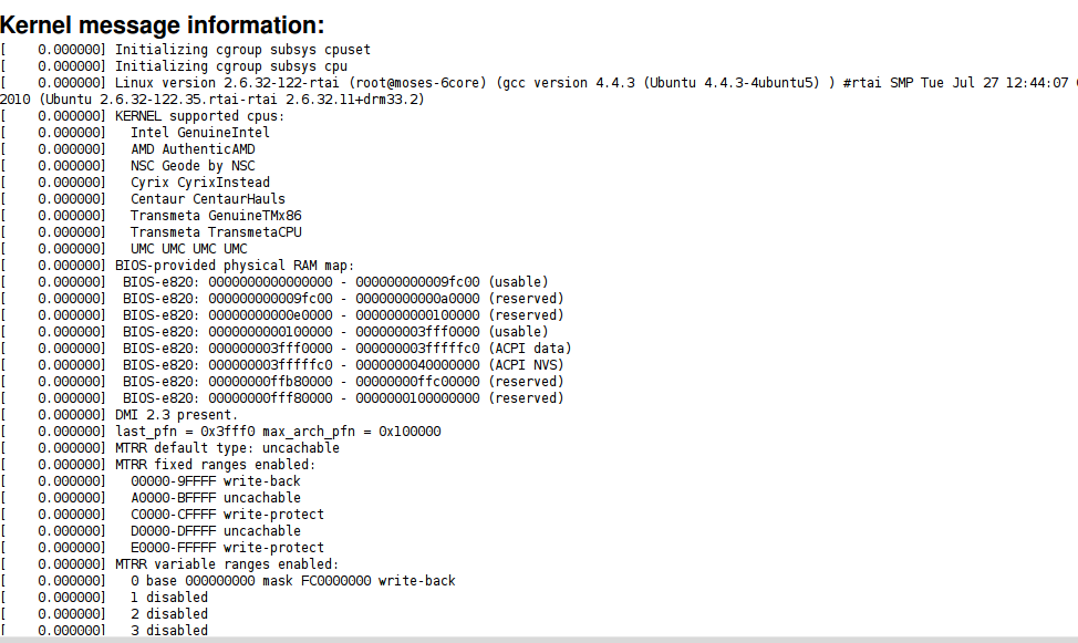

Hi
No idea, need more information, especially the end of the 'Kernel message Information'
zip your config folder and attach it and attach the resultant dmesg.txt file from running
dmesg > dmesg.txt in a terminal

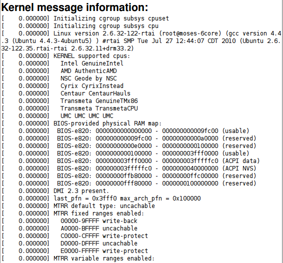

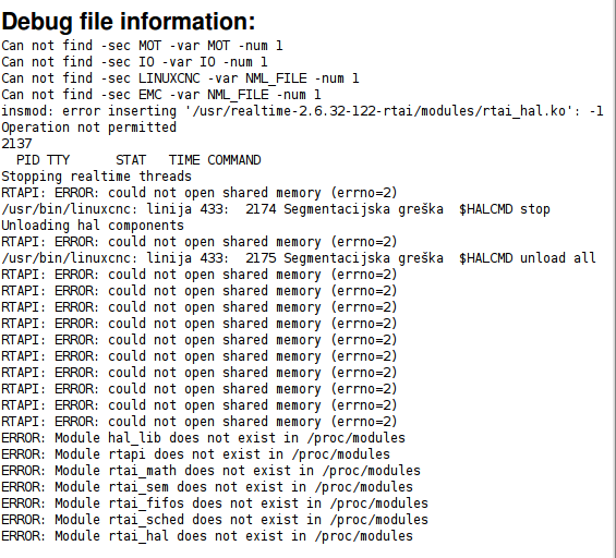

19 Jan 2014 04:26 #42989
by BosniaCNC
Replied by BosniaCNC on topic Why appears the error?

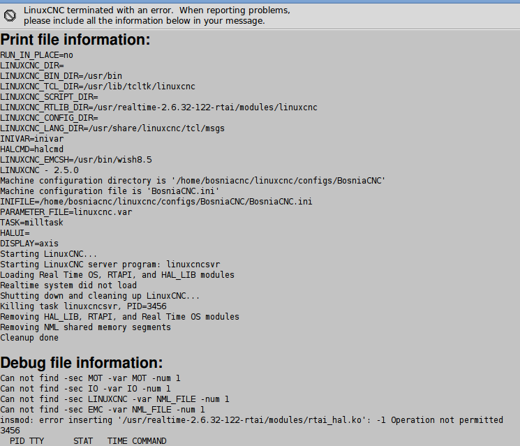

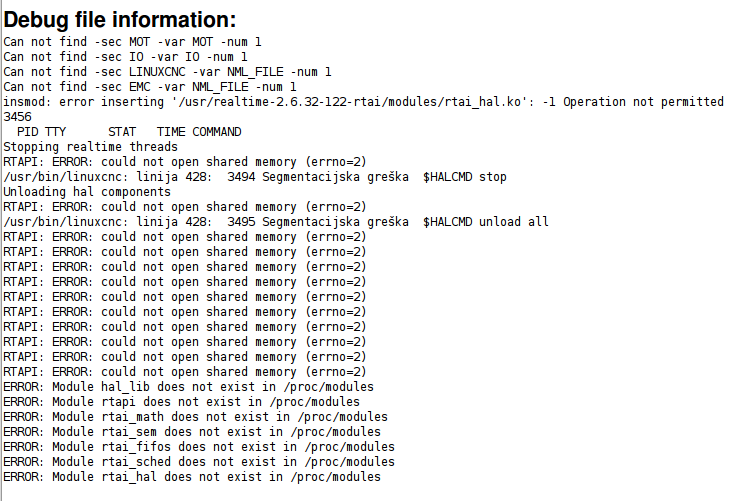

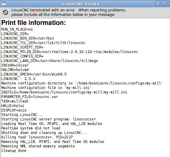

My dear friend and I have no idea why the error!Text messaging is not saved on disk.Unable to save the message to disk!
I enclose a picture and a zip file, from which it is possible to see an error message.

Can you type this in a terminal window:
dmesg > dmesg.txt
and post the file dmesg.txt here
There is not enough information to determine the error
without the full kernel log from dmesg
dmesg > dmesg.txt

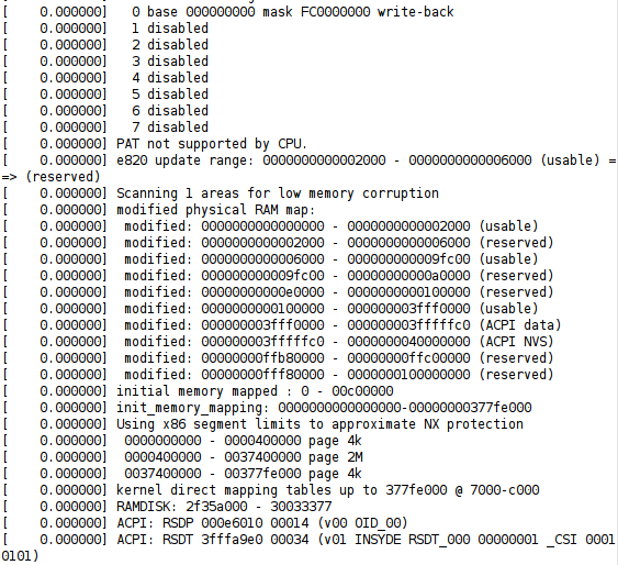

19 Jan 2014 04:50 #42994
by BosniaCNC
- Posts: 18527
- Thank you received: 5079
19 Jan 2014 05:05 #42997
Replied by PCW on topic Why appears the error?

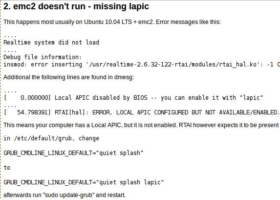

The error is this:
[ 0.000000] Local APIC disabled by BIOS -- you can enable it with "lapic"
[ 0.000000] APIC: disable apic facility
A possible solution is this:
wiki.linuxcnc.org/cgi-bin/wiki.pl?Troubl..._t_run_missing_lapic
