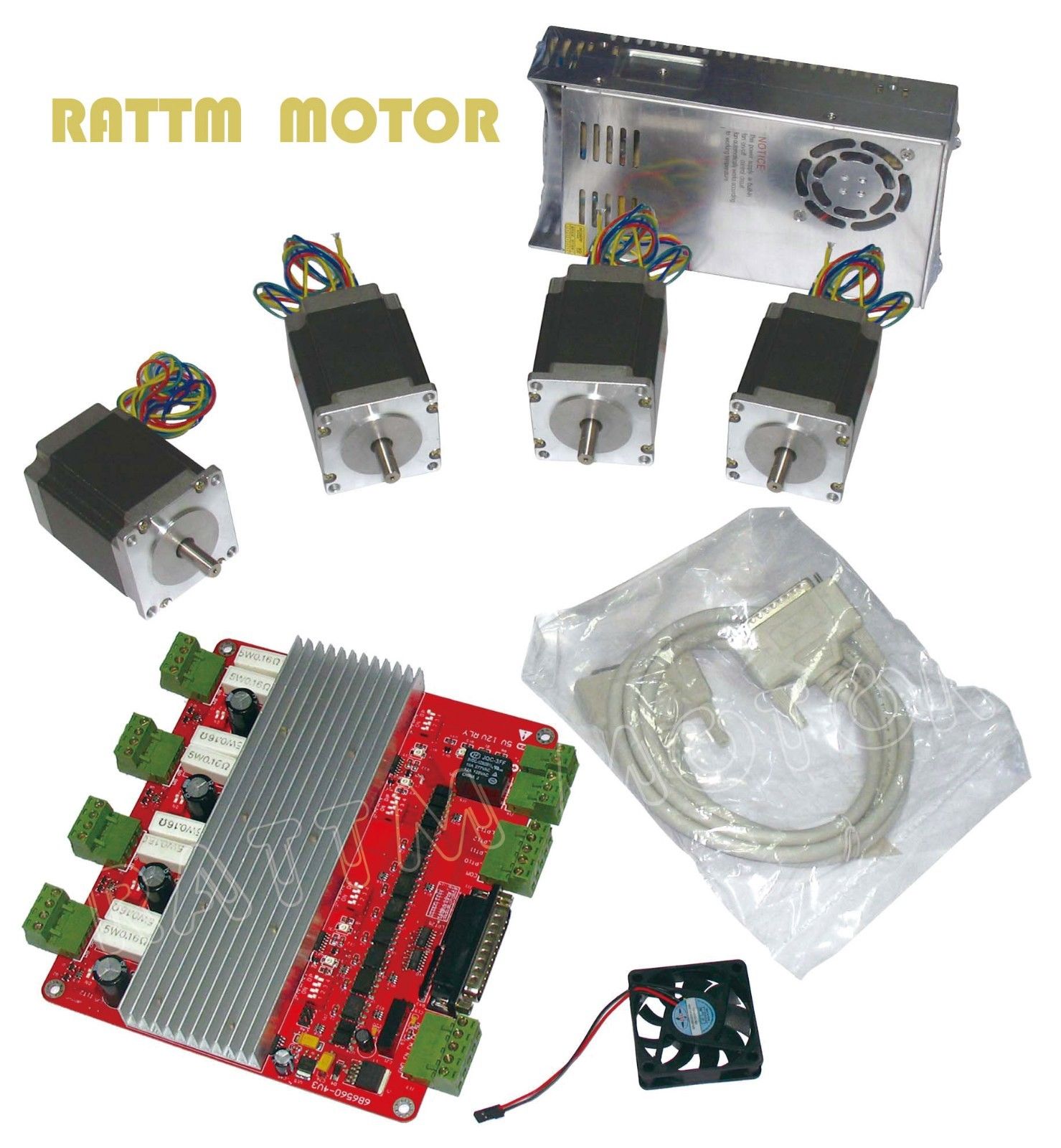

Hello I bought this Chinese board and see that is compatible with emc2, but the configure motors start and sound but do not rotate. anyone have this board and it works? . thanks
this is the full specifications
1 x 4 axis TB6560 Stepper Motor Driver board V type
4 x 23HS8430 stepper motor
1 x 350 24V/15A switching power supply
sorry for my english
this is for my little diy cnc

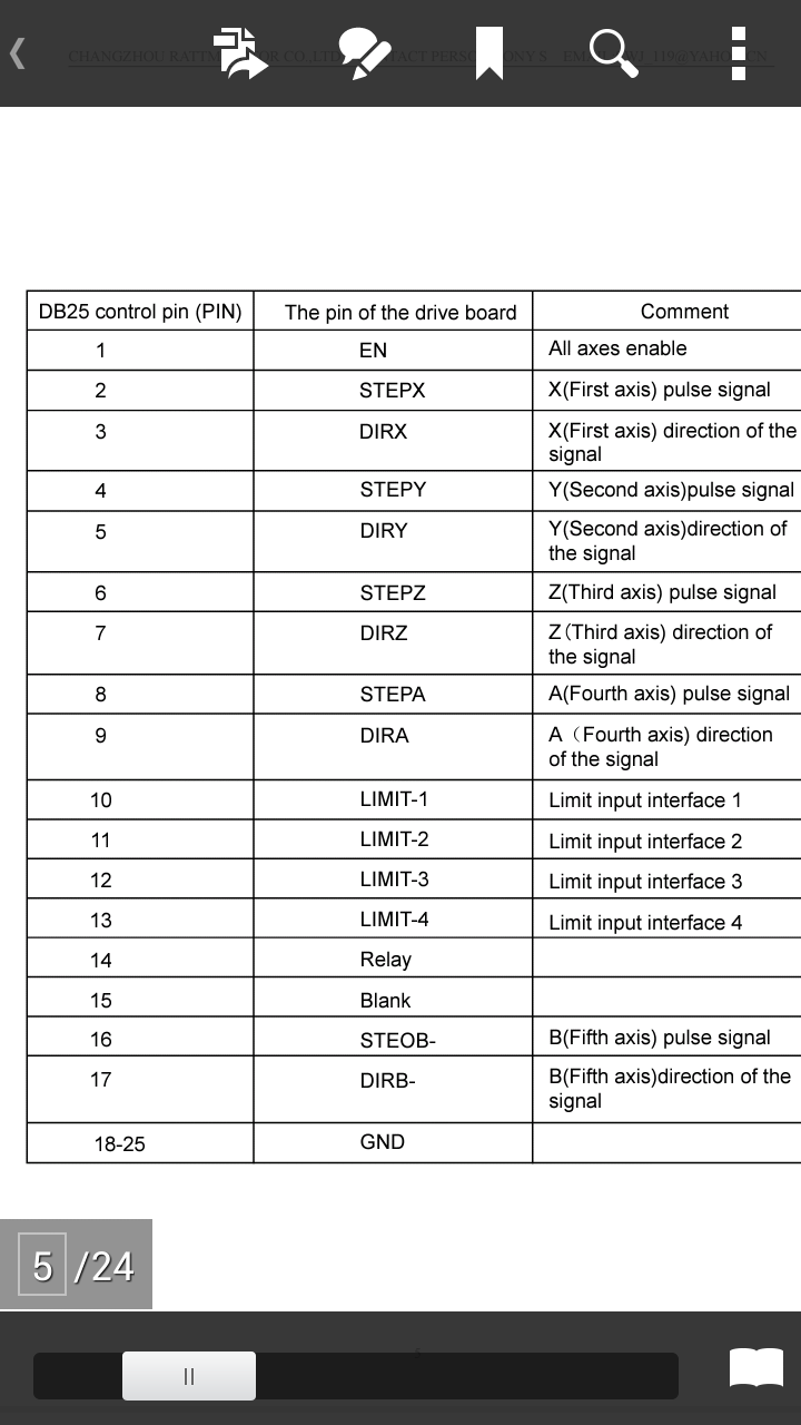

I followed this tutorial and I have added the A axis, but only the Y axis moves other engines sound but do not rotate and the motherboard is very hot

You've given a "screenshot" of what you say works with mach3, then you have a screenshot of the LinuxCNC (EMC2).
The STEP and DIR pinouts do not match.
Your Mach3 are:
2 STEP X
3 DIR X
4 STEP Y
5 DIR Y
6 STEP Z
7 DIR Z
but that is not what you show in the link you provided.
wiki.zentoolworks.com/index.php/Morgan%2...ig_for_TB6560_driver
If Mach3 works with the board, then use those STEP/DIR pinouts, not the ones from the link.
Jeff
Your Mach3 are:
2 STEP X
3 DIR X
4 STEP Y
5 DIR Y
6 STEP Z
7 DIR Z
Jeff

their are many variations of the tb6560 , which is why your having problems , use the pinout you have in mach and hand edit your hal and ini files
