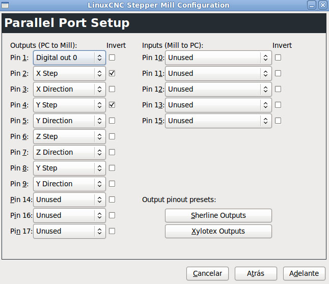

their are many variations of the tb6560 , which is why your having problems , use the pinout you have in mach and hand edit your hal and ini files
you should have a PDF of the pinouts or an instruction leaflet which with confirm the pins for that approprate board

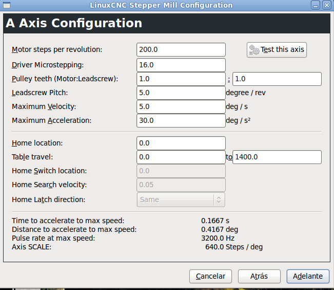

OK i change the pins like mach3 ,and works fine but the A axis don't works. How i can attach A axis to Y axis

all motors work perfectly, thank you all. here I leave the configuration that has worked best for me, if someone else has the same problem

did you solve your a axis ? , you can point the output of the y axis stepgen to both a and y axis in your hal file
i presume this is a gantery mill and you have 2 motors

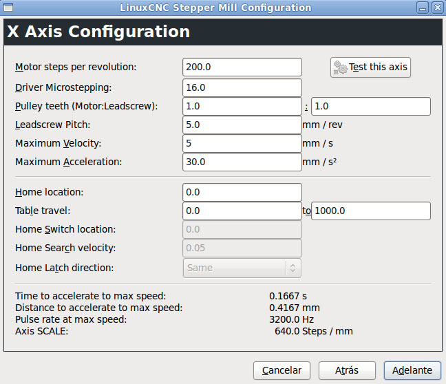

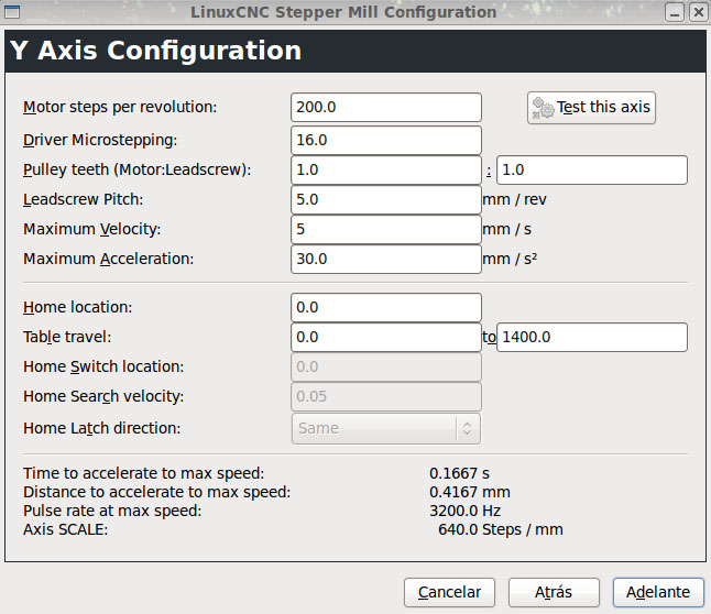

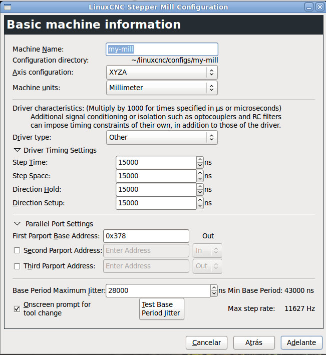

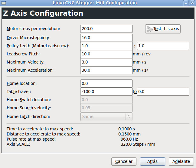

I'm noob and settings has done with wizardstepconf. these were the steps and cnc machine that will mount
Last edit: 23 Apr 2014 19:00 by octubrq.
- octubrq
- Posts: 12
23 Apr 2014 19:06 #46251
by octubrq
Replied by octubrq on topic problem wuth TB6560HQT4-v3
this is the images
