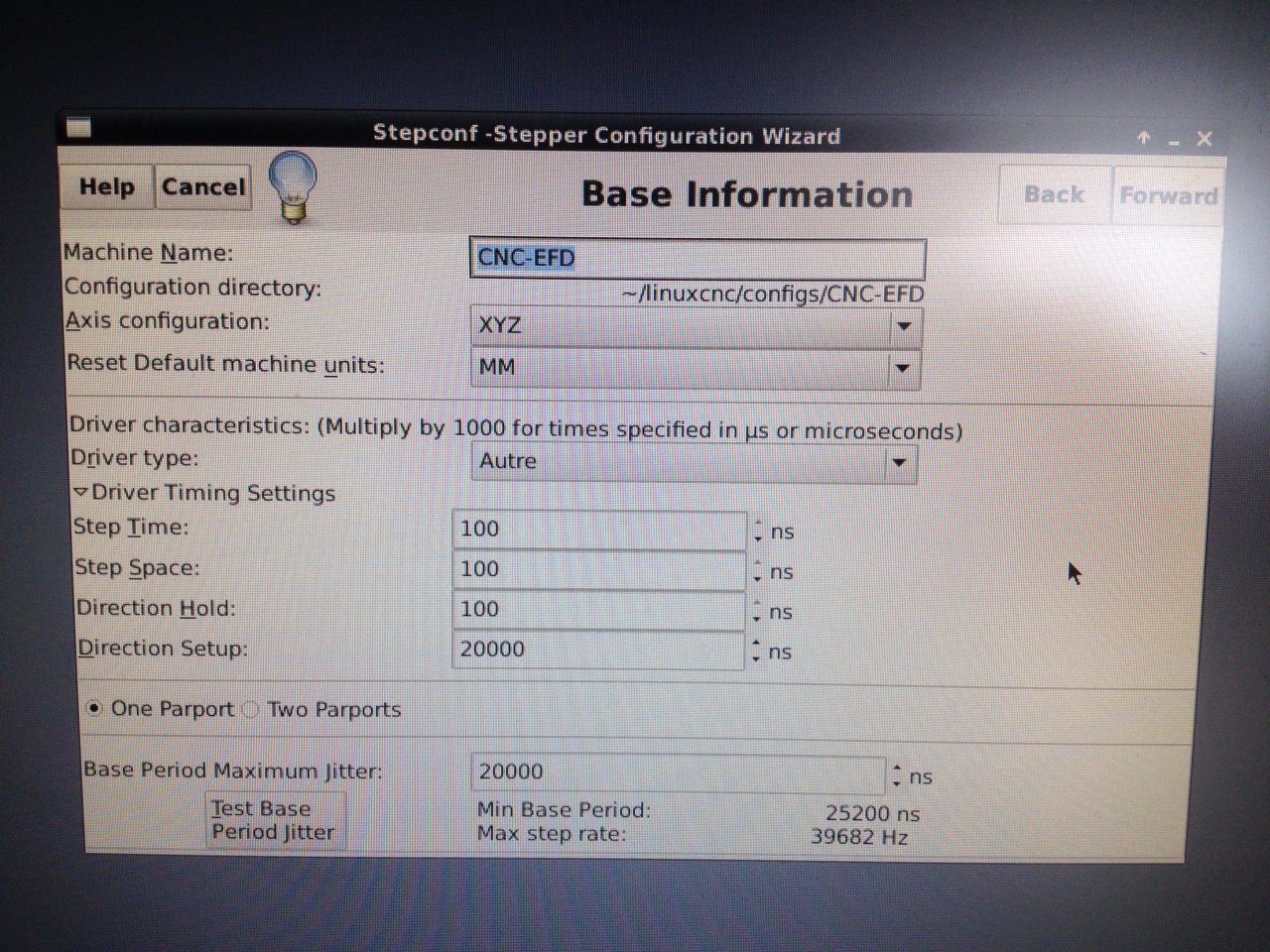

I use LinuxCnc since 2.5.0 version and normally I solve all differents problems. But now it's a big mistake !
I have a milling machine 3 axis and I try to update it to the version 2.6.0 but I have some things impossible to update.
As you can see on the first attachment, I have to set a driver timming for my Leadshine driver. I select Other and I try to put the value. But at each time, the value return to 100ns !

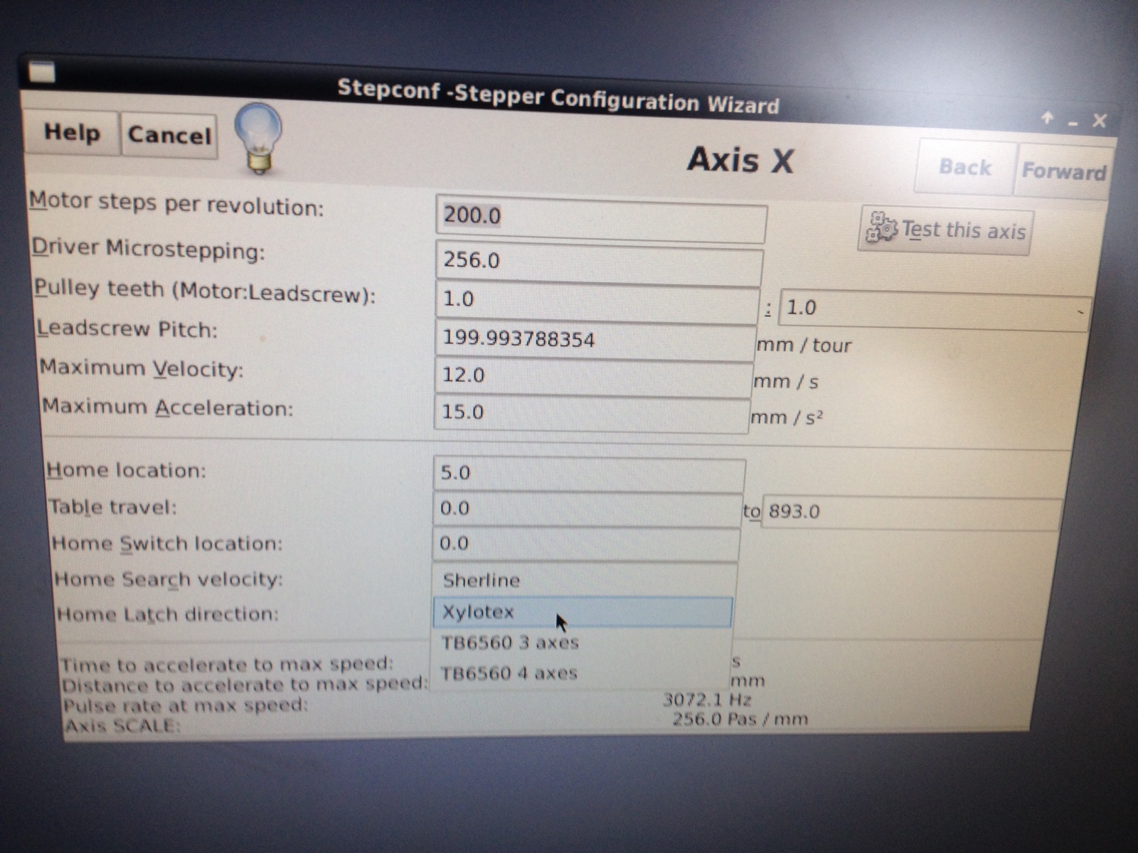

Other attachement for the axix X, I have to set the velocitu and direction, but as you can see, the text is wrong. and I don't know what I have to do.
I hope somebody could help me to return to the good params. I think If there is a problem on the stepconf I can write directly the value on a file, but I don't know how to.

It seems broken on my system also (2.6pre5)
Do you actually need to run stepconf?
Dont your existing hal and ini files still work?

Fixed in 2.6.1, available as of this morning. Thanks for the bug report.
