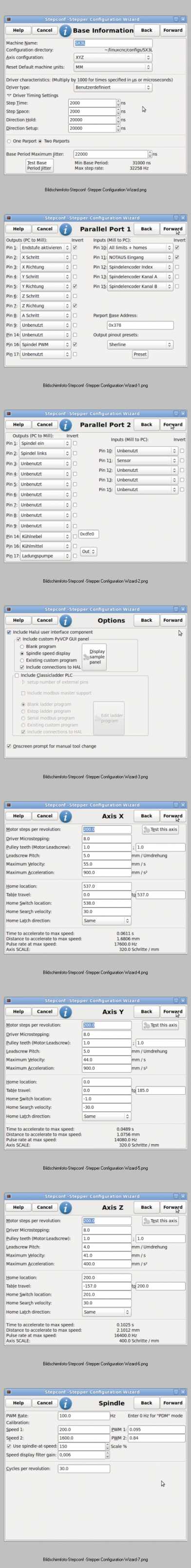

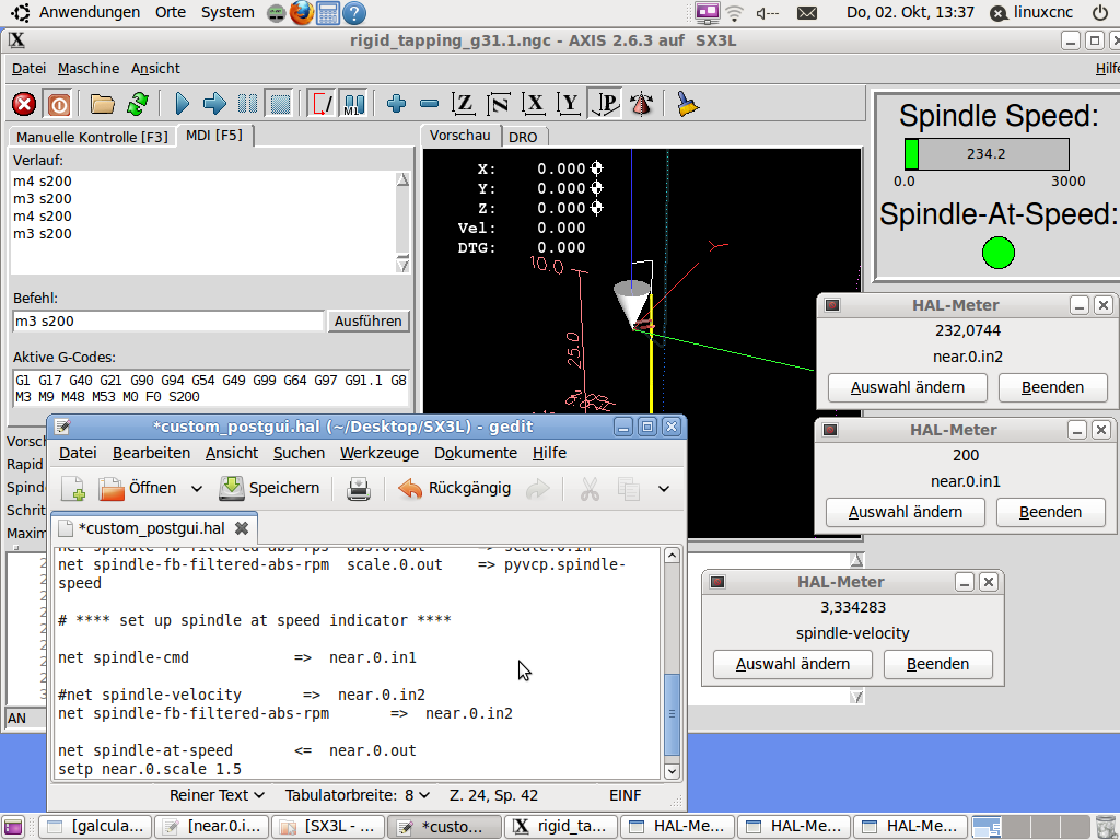

I use version 2.6.3 like you see in the picture attatched.
Stepconf Wizard generated this code with the exeption of my change:
comment out: #net spindle-velocity => near.0.in2
put in : net spindle-fb-filtered-abs-rpm => near.0.in2
Spindle At Speed was not working because it looked like the 2 values for the near function were "spindle-cmd" in rev/min and "spindle-velocity" in rev/s.
To find out If it worked I made the change mentioned above. In this work around don't work for reverse spindle motion because of "abs". Don't know the right value to put in with that filtered function.
Also attached my config files.

After a bit try and error I skiped out the abs part (oh I forgott to change the ..abs.. name)
# Benutzerdefinierte HAL-Anweisungen können nachfolgend angegeben werden
# Die Befehle in dieser Datei werden nach der AXIS GUI (und PyVCP-Panel) ausgeführt.
# **** Setup of spindle speed display using pyvcp -START ****
# **** Use ACTUAL spindle velocity from spindle encoder
# **** spindle-velocity bounces around so we filter it with lowpass
# **** spindle-velocity is signed so we use absolute component to remove sign
# **** ACTUAL velocity is in RPS not RPM so we scale it.
setp scale.0.gain 60
setp lowpass.0.gain 0.010000
net spindle-velocity => lowpass.0.in
net spindle-fb-filtered-rps lowpass.0.out => scale.0.in
#net spindle-fb-filtered-rps lowpass.0.out => abs.0.in
net spindle-fb-filtered-abs-rpm scale.0.out => pyvcp.spindle-speed
#new 2 lines
#net spindle-vel-cmd-rps <= motion.spindle-speed-out-rps
#net spindle-vel-fb <= motion.spindle-speed-in
# **** set up spindle at speed indicator ****
net spindle-cmd => near.0.in1
#new 2 lines
#net spindle-vel-cmd-rps => near.0.in1
#net spindle-vel-fb => near.0.in2
net spindle-at-speed <= near.0.out
setp near.0.scale 1.500000
net spindle-at-speed => pyvcp.spindle-at-speed-led
so I only had to change the custompanel.xlm to show negative values
Warning: Spoiler!
#new 2 lines
#new 2 lines
