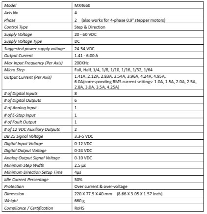

I recently picked up a Leadshine MX4660, and with it being new to market, I just cannot verify the correct settings for the Step Time, Step Space, Direction Hold and Direction Setup in Stepconf.
Listed below are the specs, and I would guess (rookie guess) that "Minimum Step Width" of 2.5µs would be "Step Space" and "Minimum Direction Setup Time" of 4µs would be the "Direction Setup", but I don't see anything for the other two.
The full datasheet can be downloaded here - MX4660 Datasheet
This is the relevant info from the MX4660 Datasheet:

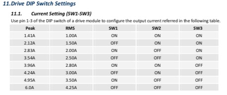

Also, while I've got you here, help me pick the proper amperage settings on the MX4660. I'm using the 320oz low inductance motors from cncrouterparts. The specs list 3.5A, so should I set the amps on the MX4660 to Peak or RMS power?
Specs for the Steppers...
Specs for the Current Settings...

All the single analogue Leadshine drives (of which this will simply be a multiple in one box ) use (in ns)
Step time 1500
Step space 1500
Dir hold 8000
Dir setup 5000
wiki.linuxcnc.org/cgi-bin/wiki.pl?Stepper_Drive_Timing
You should be safe to use those, as stepconf will use the dir setting and just set the step to be determined by the thread interval.
Steppers should be current rated in RMS values, but the spec sheet does not say that.
It takes more peak current to microstep and maintain torque.
I would suspect these are M542 drivers internally, you should be fine using the 3.5Amp RMS setting
If your steppers get abnormally hot (can't touch them) then reduce, but doubt that will happen unless the 3.5A rating is optimistic.

It didn't say anything about digital on the spec sheet you posted, except for the inputs etc. so I assumed analogue
If it is digital, the step timings should be 2500,2500,10000,5000 as per the wiki, all their digital drivers seem to be the same.
As I said the step timings are largely irrelevant to the stepconf setup, it will do it on thread period.
regards
regards

Here is the response from Leadshine...
The maximum frequency time of the MX4660 is 2000 kHz. So, the step width of 5000 nS should be fine.
